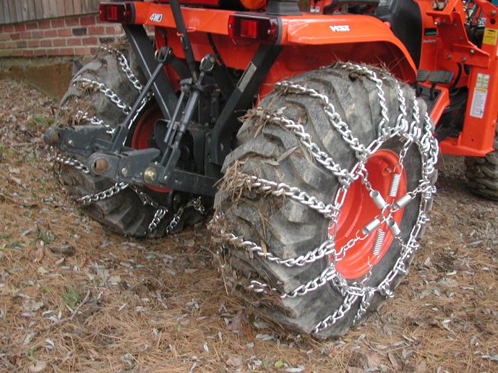

This is for anybody....On a 4WD tractor using 4WD do the chains go on the front or rear? I'm assuming the front.
My manual is packed away, getting ready to move, so I can't readily look it up for my L3130.
/ Tire Chains #23
I would put them on all 4 wheels if I need to. There is a logger in Tupper Lake NY that has several 4330's that he uses as skidder's. He's got all 4 wheels chained.
/ Tire Chains #24
<font color="blue"> This is for anybody....On a 4WD tractor using 4WD do the chains go on the front or rear? I'm assuming the front.</font>
My understanding is that you would not want to put chains on the front only. The reason is that the rear drive portion is much stouter then the front drive. If you put the chains on the front, then the "weaker" components would be hog the load, and you may overwork them and cause premature failure.
Common sense tells me this is likely, but I don't know for sure. If you compare the tractor components to the size of the drive components on a 4x4 truck for example, it sure looks like the front of the truck could handle the same load as the rear...but the tractor looks disproprotionate.
I do know that the manual for a CJ7 jeep that I had once, specifically recommended that if you put chains on, to put them on the front wheels. Again, front and rear drive train sizes are about the same on a Jeep...
I might put chains on all four wheels, but I personally would not put chains only on the front wheels of most tractors.
/ Tire Chains #25
Why couldn't you just use them on the front if you need them? Very easy to get on and off and they would cost much less. I don't think it would be wise to use them on a lighter tractor but something with a good size front axel should be fine

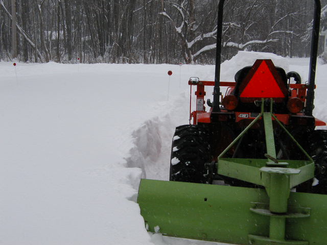

/ Tire Chains #28
I run chains on the fronts only. Have for the last 4 winters. I have a very steep 1/4 mile drive. The difference they make is incredible. I plow with a 3 pt blade. Without the chains, I use to have a problem steering when the blade was canted off at an angle (the blade would push the front end in the opposite direction), and I would have to lift the blade slightly off of the ground to 'make the hill', because without the weight of the blade hanging on my tractor I didn't have enough traction. With the chains on the front wheels, I can steer it, and I have plenty of traction to make the hill with the blade on the ground.
Also, one tip that I've shared here before, but there may be folks that haven't seen it. I got my chains for nothing. I got used chains from the guys at our local town garage. They use them on the town plow trucks in the winter, and they wear out a couple of sets per truck per winter. They gladly gave me several sets of their old worn out chains. I took them apart, and made up a set for my tractor. They are plenty good enough for me, all it cost was a couple of hours work, and I've got spare parts enough to keep them going as long I'll be plowing snow /forums/images/graemlins/smile.gif.
Your mileage may vary, but for me running chains on the fronts only works real well.
