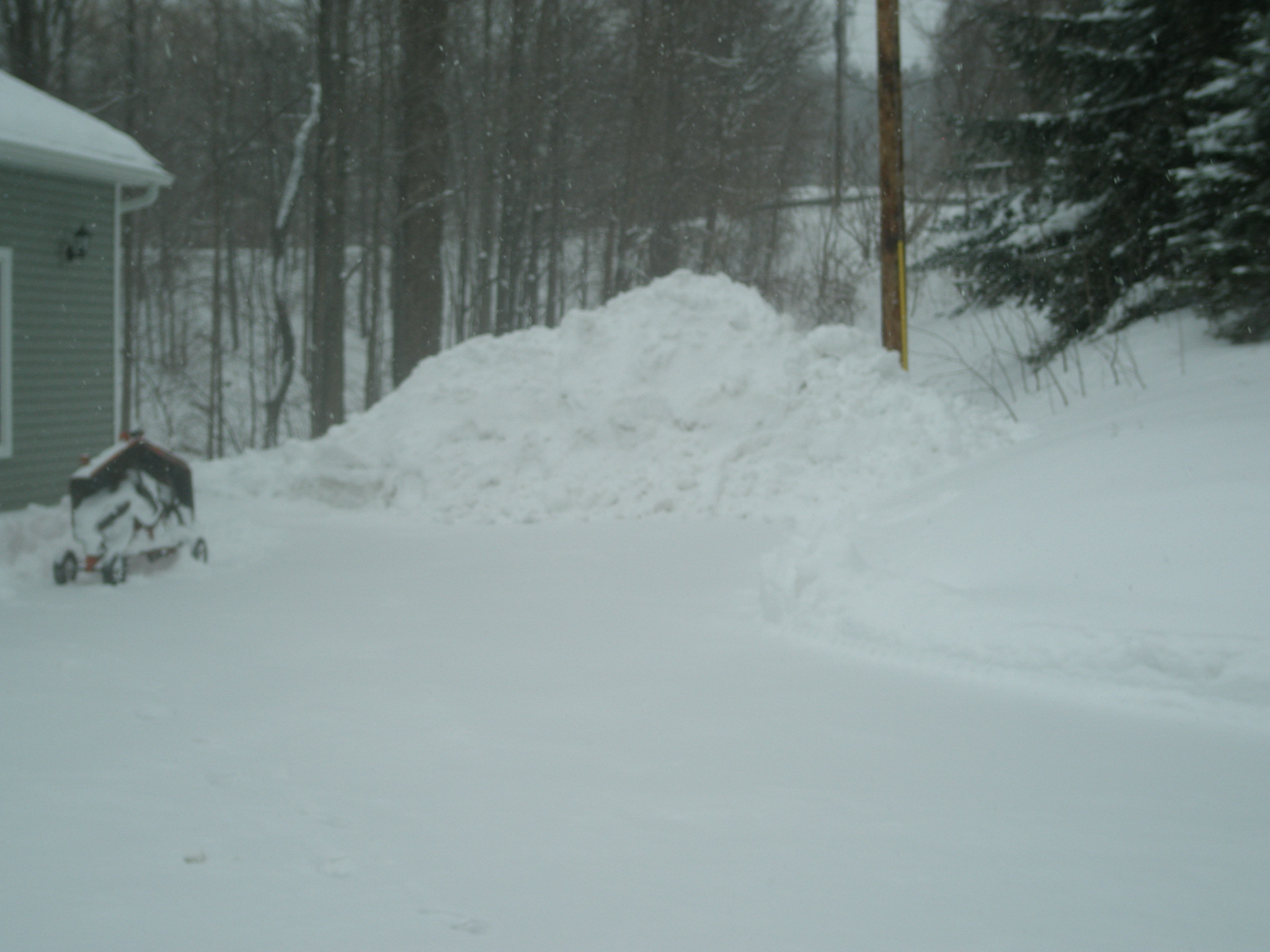

Here is a picture of the David Brown 12-28 Rim, tire changer used in the battle to break the 44 year old bead and a bonus, Just one of my 4 snow piles made this winter.

The snow pile was made with the BX2200 bucket. A "Show me your Snow pile" thread for this year might be interesting.
