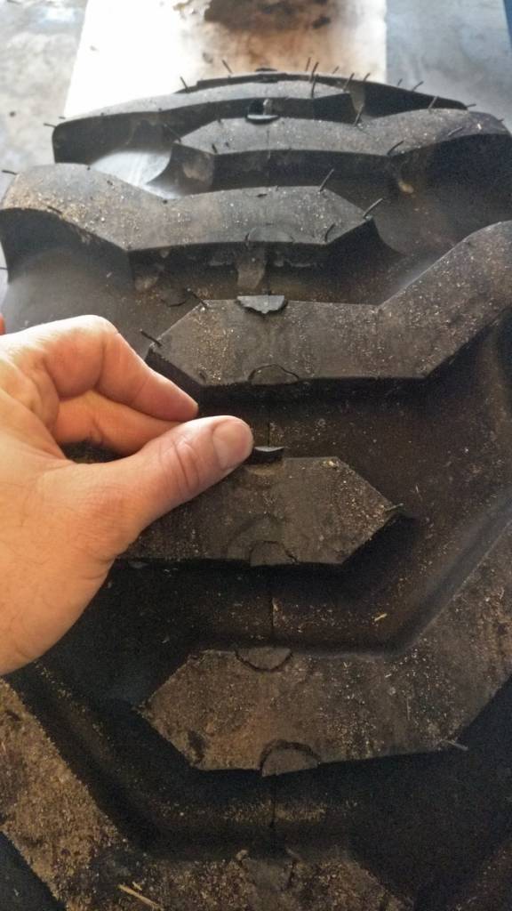

I have a new (2 month old) LS tractor with 25 hours. In looking it over this morning I noticed both front wheel have chunks of rubber that are breaking off the leading and trailing edges of every tread lug. (See picture attached) While some lugs don't have chunks broken out yet, you can see where cracks are forming.
They are all aligned with the center of the tire, where there is flashing, I'm assuming, from the fabrication process.
Has anyone noticed this before? Is this normal, or something that should be claimed under warranty?
   / Tire cracks?!?
Do they happen to be Carlisle tires?
Yes, they are. I just found a prior thread with an identical problem. Those tires had a manufacture date of 08/19. Mine are 09/19. It looks like a bad batch of tires.
   / Tire cracks?!? #5
I'd start by going back to the dealer. They are going to immediately tell you they don't warrant tires, that you need to go to the tire manufacturer. I'd then ask them to help you in that regard. Then you'll know how good your dealer is.
After that, I'd look thru my paperwork from the purchase for warranty information regarding tires and follow that path.

Looks like you took pictures of the tires that came on my new tractor.
I think I am the person you are referring to in the other thread. The good news is ( well for me anyways) Carlisle replaced both of my tires without argument and did it very quickly. The only cost I will be out, is the cost of removing and replacing the tires. They might cover the cost but I figured I would eat it and just run the tires I have now, until they give out and then replace them. More than a fair trade in my opinion.
I was very impressed with their response to the issue.
Good luck and let us know how you make out.

Pure speculation on my part. I think it is a fault in the forming and pouring of the tire. I don't think there's any structural strength issue. I'd be just like Hilbilly, I'd run em. Only problem is the replacements will have an old shelf life before he gets to use them unless he ruins one by accident. Most tires have a shelf life and are dated on the sidewall somewhere. It's common to see an unbelievable sale price on tires because they are reaching the end of their shelf life for warranty purposes.

I just put a new set of Carlisle F1 8x16s on my 2400. I too noticed what you are describing along the center line of the tire, chunks about an inch across on the leading edge of several of the lugs. This occurred after I ran a few 800# round bales down a country road: (small) rock embedded in asphalt (the way country roads are maintained in TX.) all weather road. The tires were obviously (opinion) recently vulcanized and apparently had not been subjected to Ozone damage (opinion) like tires I had on the 6530 when I purchased it new.....which had the concentric rings emanating from where the lug emerged from the main carcass made by Titan....on brand new tires....which didn't shed lugs of rubber when subjected to much higher loads on the same road surfaces.
Soooo having had both, (not being a tire manufacturing person) I'd assume the amount of "Plasticizers" incorporated into the tread determine how soft is the tread and being softer is more prone to chunks being torn off by road surfaces and such, but not cracking, not having been exposed to the sun sitting out in the back lot where new tractors are received (minus tires and wheels) and the tires and wheels are added. (Ref. Google Maps of Rome, Ga, Branson headquarters back lot.)

Yes - I followed your advice from your prior experience, and contacted Carlisle. They asked for the exact information you had said was needed. The lady told me I should hear back within 2 business days (I submitted it on Friday afternoon).
