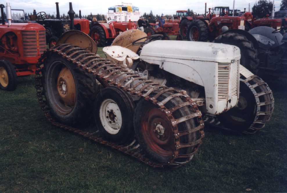

i got a pic of one of the surviving tea 20's that went to the pole
only one privately owned apparently, the rest are in museums (one is in the auckland land transport museum)
laters
pudding
OI you! Get back to work

   / Tire Overtreads--A Needed Invention #42
head on down to ya friendly NH man......get some of that wide belt stuff out of an old or new round baler (apparently they use wide belts now?.....
cut to length..........vulcanise with a big over lap together in a circle.........
jack the tractor up.......deflate the tire..........slip the belt over........inflate.......
strap with packing tape, or dog collars to the rim to stop them sliding side ways
the end

   / Tire Overtreads--A Needed Invention #43
Hi ya
well there ya go ,can be done i do notic all are 2 wheel drive tho but with tracks 4wd kinda comes useless
gives people a few ideas if doing a heap of snow work tracks for winter back to tires for summer best of both worlds
thanks for the pics pudding i'll spring ya a beer or two once i get up your way
catch ya

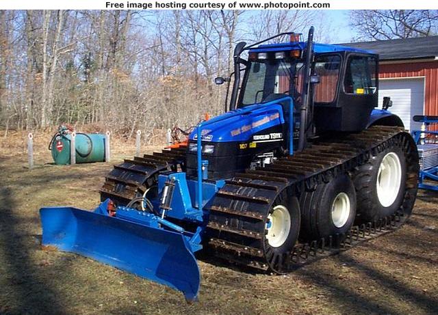

   / Tire Overtreads--A Needed Invention #44
Hi Patrick,
I just read this more closely and what you are saying I think is completely correct, but is not the point I think we are debating. Maybe this is why we still don't see eye to eye.
My original comment to Glenn, restated hopefully more clearly, is: Take a 4x4 tractor with properly geared front and rear wheels for operating on flat ground just like many of us have today. The front and rear wheels are predominantly different sized, but things work without violance because the drive gearing is matched to the wheel size difference. This is your pully analogy and I think we agree on the need for proper gearing and we agree that the front and rear wheels will turn at different rotational speeds just like the pullies.
The point I was trying to make is that if you then wrap a track around those same drive wheels with that same gearing it will work just fine without slippage or skidding. Further more, it doesn't matter if the track is 1"" thick or 1' foot think, the tractor drive gearing and drive wheel sizes will still be correct and will propel the track without slippage.
Hopefully we are debating the same point. I've seen some lively conversations where in the end you discover the people are debating two different issues or points.
   / Tire Overtreads--A Needed Invention #45
Hayden,
My gut is voting with you. Fuzzy math says it doesn't matter what the thickness of the belt is. The tires would be running on the inside of the belt, not on the outside. The effective diameters of the pulleys would be changed, which would result in different speeds of rotation (RPM), however, the distance the belt travels along its inside surface would be the same, irregardless of the belt's thickness. (It's very important we get this figured out, or every automobile ever built may be in danger of blowing its belts.) Assuming your track has an inside diameter of 10', and an outside diameter of 14' due to the added thickness. (The inside of a pipe is not the same diameter as the outside). So, for every rotation of the inside, the tractor will think it has gone 10'. But, actually, it will have gone 14'. No matter what, the outside of that track will go around once for every one time the inside goes around.
The third wheel you are seeing in the pictures is an idler, which basically helps to take the pressure off the top of the drive tires and reduces tire scrubbing. It also keeps the distance between centers shorter to prevent the track from jumping. The better you can hold the track the less likely it is to jump off.
Now for a question. I understood that on 4x4 trucks (at least), the front wheels are designed to turn at a slightly slower rate than the rears. This is to ensure you can maintain steering. Since the rear wheels are always pushing the fronts, there is always a slight drag, which allows the front tires to steer. This explains two things. A. Why 4x4's are lousy on ice (I've seen a lot of em with their rears trying to pass their fronts.) B. Why the maunfacturers always add a warning label saying something like :"Do not operate on dry pavement."
Does anyone know if this rotational difference also applies to 4x4 tractors?

   / Tire Overtreads--A Needed Invention #47
I agree, it doesn't make sense and I think now I've REALLY figured this out, but first....
Glenn, my appologies for taking this discussion off course, but it's too puzzling a question for me to resist. I guess we've gotten "side tracked" - yuk, yuk, yuk. But all jokes aside, this would in fact make a great extra credit question for a Mechanical Engineering exam.
Now back to the problem. I now believe that not only is the "It's a Bigger Wheel" model incorrect, but I believe my "It's two ovals" model is ALSO incorrect. The real answer comes from looking more closely at the problem and seeing that it's neither circles nor ovals, but that a track changes shape as it goes around.
Let's look at the same example where we have two equal sized drive wheels of 1' diameter, spaced 2' center to center, with a 1' thick track wrapped around. Now let's look at the track's shape and distances around the inner and outer surfaces.
The track can be broken into two parts, that which is in contact with the wheel, and that which is running straight between the wheels. The sections in contact with the wheels are two half circles, one forward of the front axle, and the other rearward or the rear axle. In these sections, the inner track surface length is 1/2 of the wheel circumference, or 1.57'. The outer track surface is 1/2 of the wheel circumference plus 2x the track thickness, or 9.41/2 => 4.71'. The outer length is considerably longer than the inner length.
Now look at the sections of track between the axles where the track is not in contact with the wheels. Each of these sections (one top and one bottom) is 2' long, and for both of these sections the inner track surface is exactly the same length as the outer track surface.
Now, how is this so? Well, as the track goes around, the outer surface expands as it goes around the wheel, and the expanded outer surface is indeed moving faster than the inner surface, BUT IT"S NOT IN CONTACT WITH THE GROUND! Ground contact occurs only between the two axels, and in that section the inner and outer lengths are exactly the same.
So, I now believe that a trackless vehicle (just drive wheels) will travel EXACTLY the same distance per drive wheel revolution as a tracked vehicle with the same drive wheels, and it will do this regardless of the track thickness. This is because the section of track in contact with the ground is always the same length as the inner track section covered by the drive wheel rotation.
The "Bigger wheel" model does not work because the bigger wheel is never in contact with the ground. The "concentric Oval" model is wrong too because the longer part of the outer surface is also never in contact with the ground.
To summarize, as a track goes around, the length in contact with the ground is exactly the same as the length that came in contact with the drive wheels. As the track leaves contact with the ground at the exact same time that is makes contact with the wheel, and for the whole time it's in contact with the wheel the outer surface of the track expands, either by stretching in the case of a belt, or "fanning out" as in the case of a metal track. The outer surface is moving much faster as it goes around the wheel, then slows back down to the drive wheel speed once it leaves contact with the wheel. If you watch a track you can clearly see this speed change.
A track is exactly like having a person walking in front of the vehicle doing just-in-time road construction (of any thickness) while someone else is walking behind doing just-in-time road destruction and passing the removed material forward to the road builder guy. The tractor speed and leverage is completely unchanged with the addition of tracks, just as the thickness of a road surface does not alter speed or leverage.
I also retract my assertion that wider wheel spacing changes things. It changes nothing.
I think this now makes sense. Does anyone else agree (or care)?
