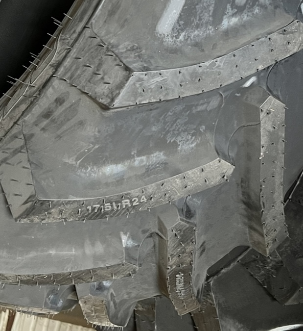

I find my original R4 spin on the grass way more often and tear up the grass more than my old tractor's R1s. My new tires are the ones in the above picture that shows a R1 type tread in 17.5LR24 (460/70R24) and will be installed sometime next week.

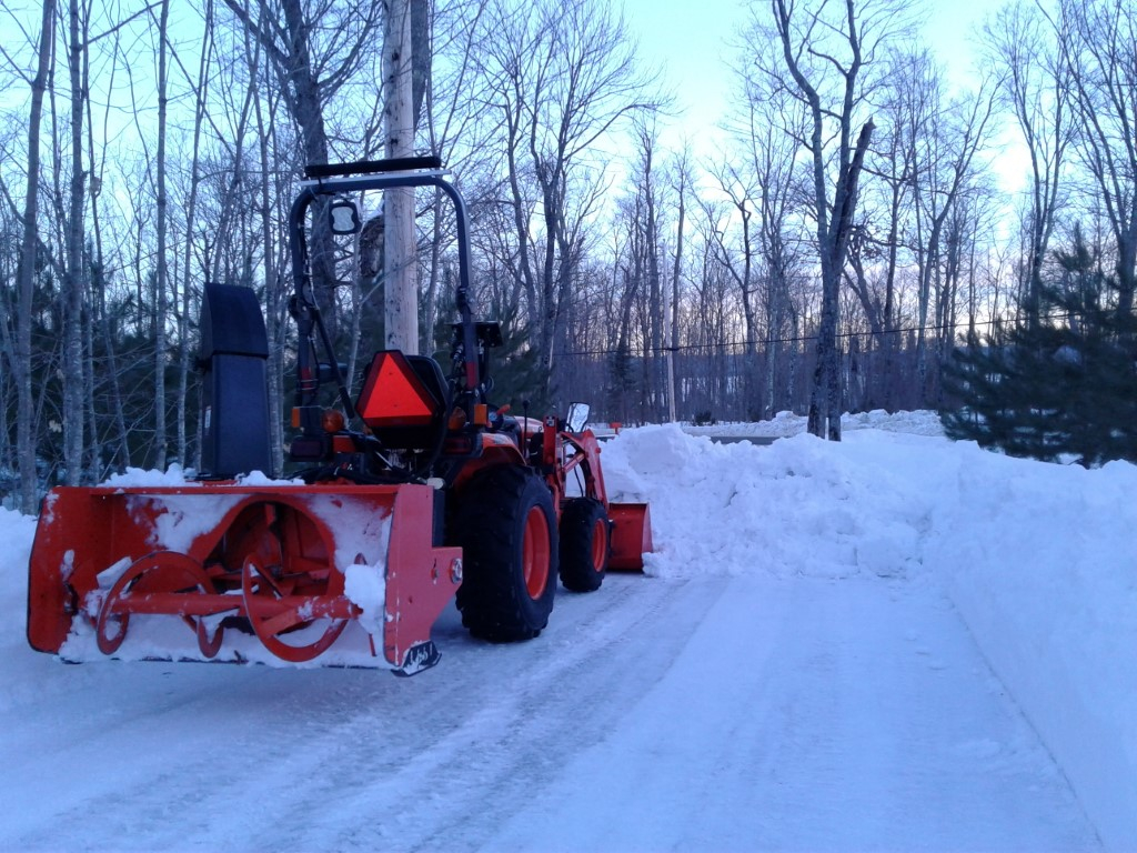

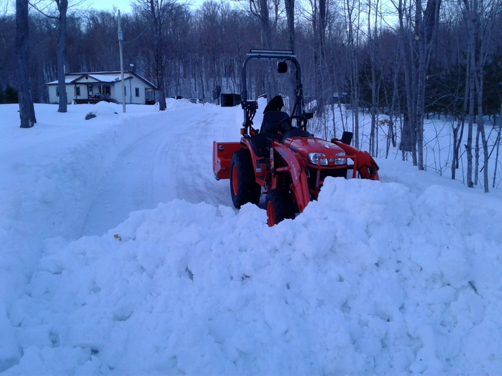

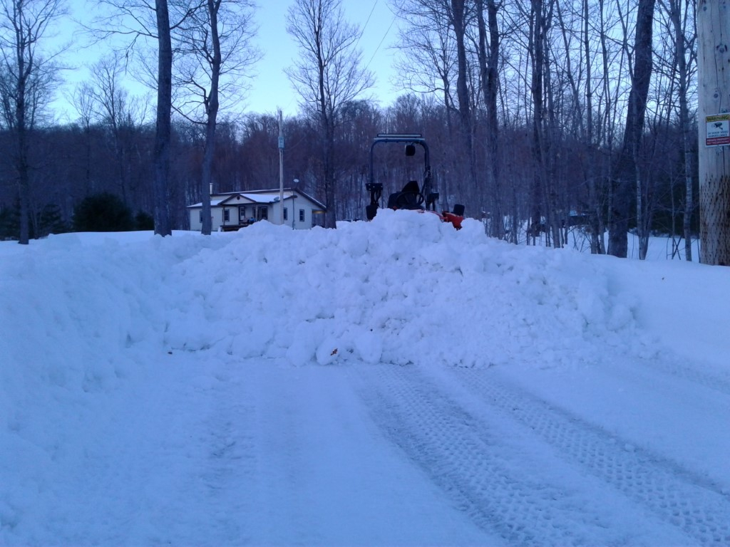

R4's suck in snow and ice?? No chains, not filled. Wet heavy snow melting on ice. Just cut my driveway down to the hard ice pack.
Yes, I'm sure I could get it to spin, but you don't have to mash the go pedal to the floor every time you go to move.
Use finesse and it will do anything you want.
I have a steep hill on my bush road that I snow blow going up, no problem there either,
