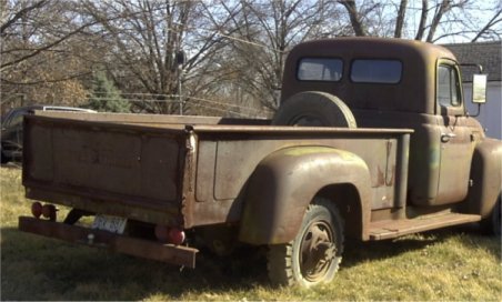

Split ring...................
I inherited the 53 last year. It's sitting in my backyard waiting for me to fix the brakes so I can sell it to somebody that likes IH trucks and wants to restore it.

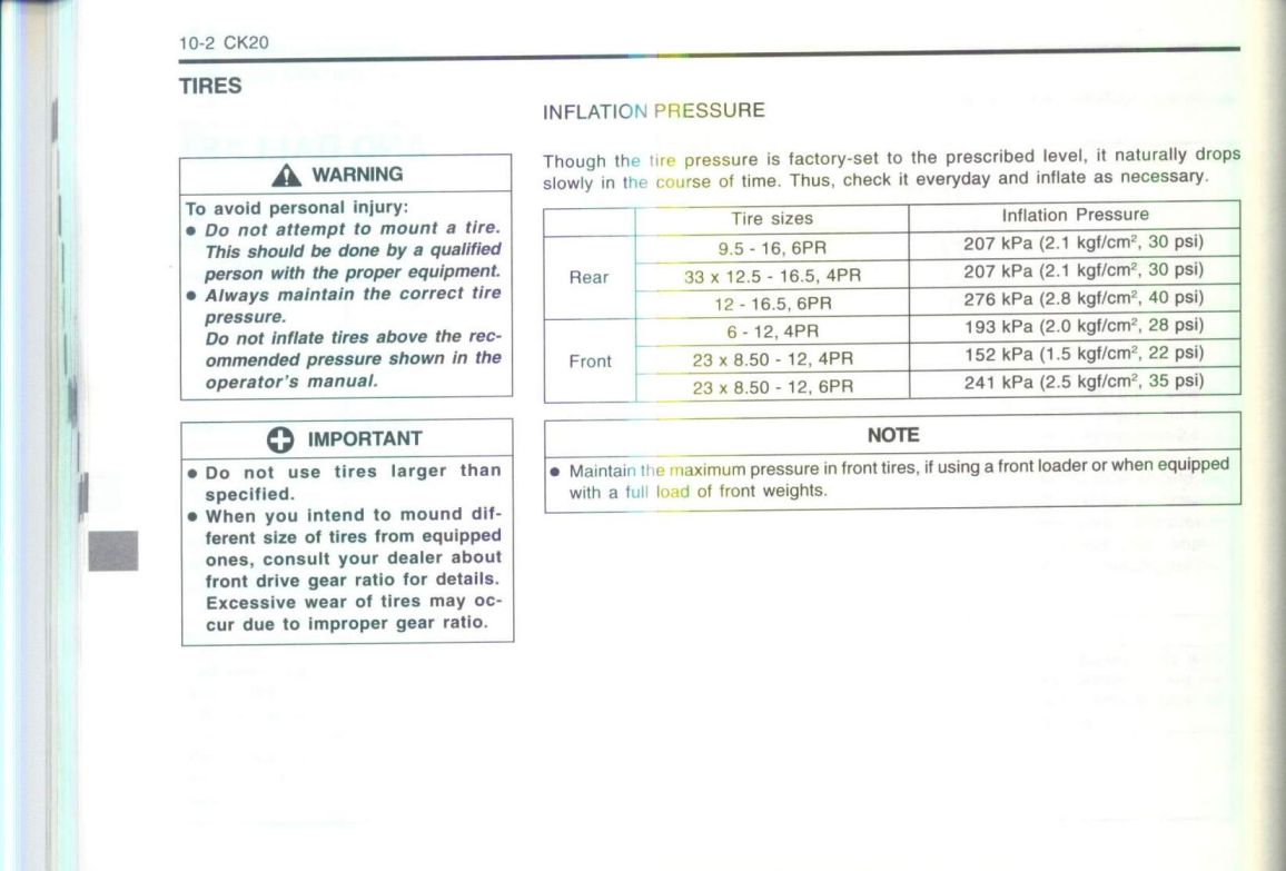

Richard:
This is out of my owners manual. See attachment. G
