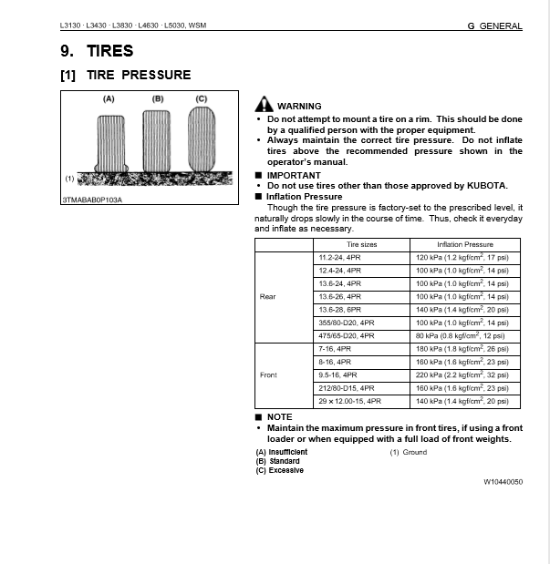

Found this online. It isn't the manual for the L4330. (models are listed at the top) Anyone know if the tire specs are the same?

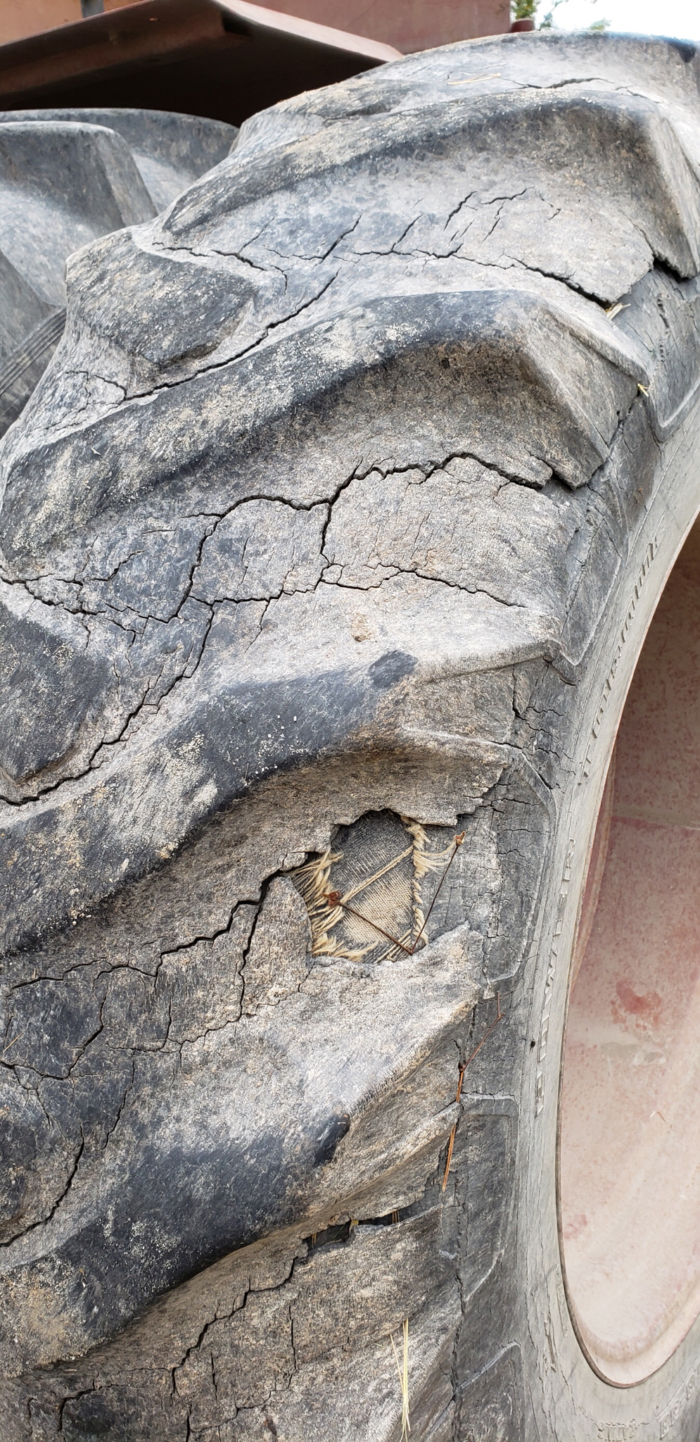

My nephew’s articulated 4wd tractor. All 4 outside duals look like this. No problem with them putting 250 HP to the ground.
