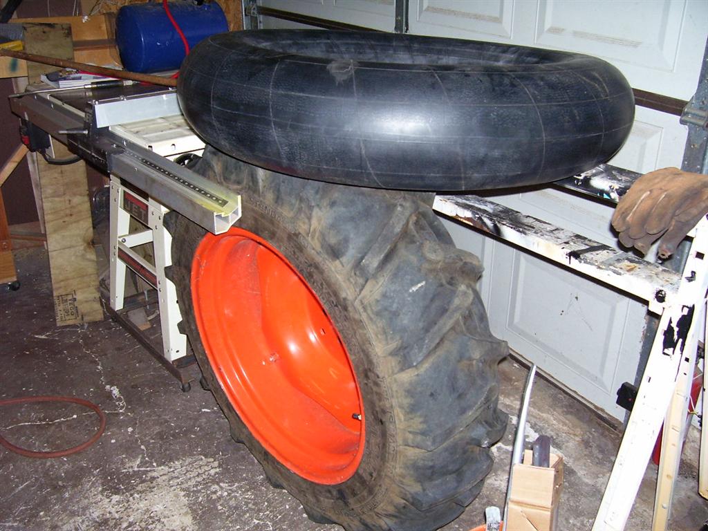

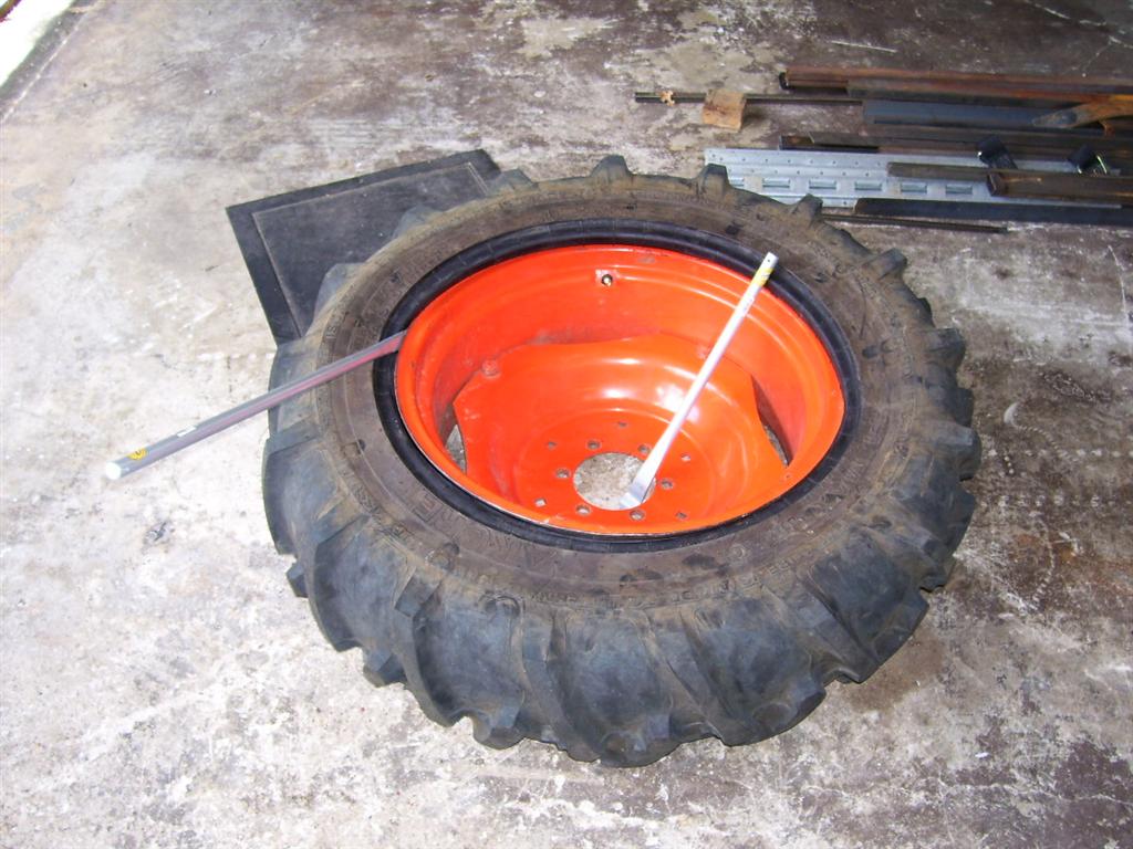

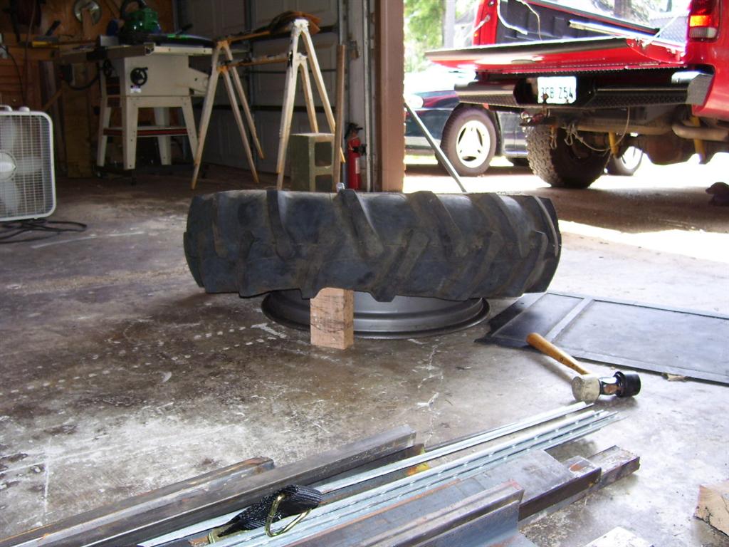

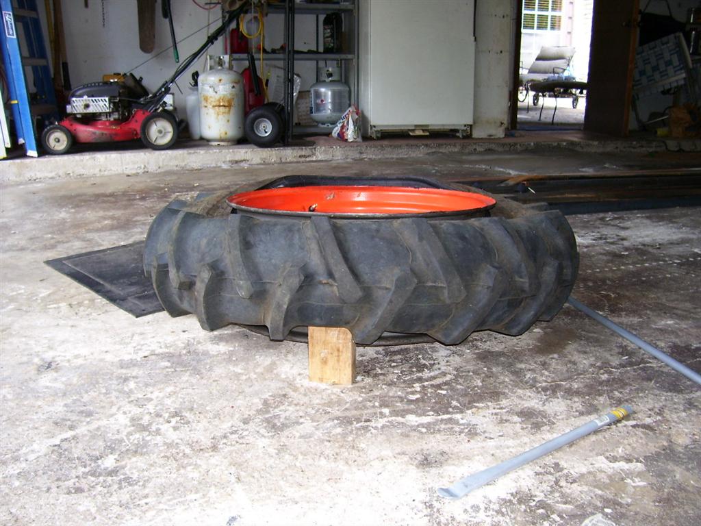

Changing tires not that big of a deal. I had to swap out a tube yesterday. I got a piece of wire in the rear a month ago. One of the holes was right at the tube seam, small cheapo patches wouldn't cover enough. Bought a new tube but still wanted to fix the other as a backup. Installed the new tube and put a bigger patch over the old leaking patch. Overnight it's shes holding. Just a couple $6 tire tools to get the job done. Key to an wasy tire pull is break the beads on both sides. Get the tire in the middle of the rim where it's smaller. I use the block to hold it up on one side. It'll come right off. The new tube was $25. If I have a lot of this I may try the slime route (admit I'm not a big fan). I will not use it in my ATV. I did it once and when I changed out the tires a couple years later the rim was rusted out from the inside with the water base product.
