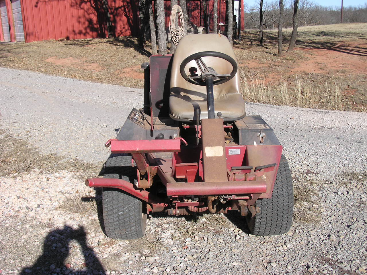

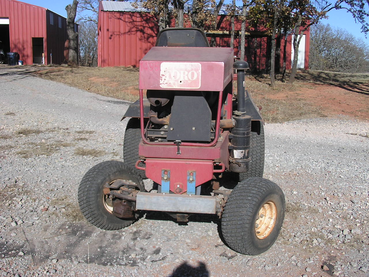

The tires on this 20 year old TORO would not hold air, so last week I mixed 40 ounces, half water and half starch, for the back tires and 80 ounces for the front.
So far so good. :thumbsup:

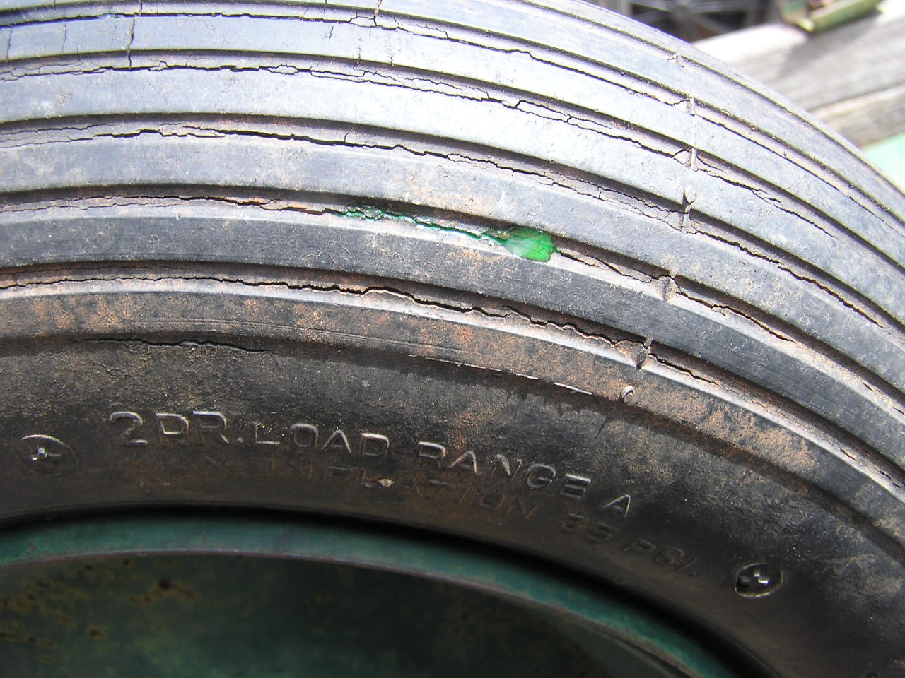

Have an old double wheel wheelbarrow that one age cracked tire would not hold air. Removed the valve stem, put some water in and aired it up. slowly rotated it, water came out several places. Removed the valve stem again and put in 40 ounces of starch, aired it up and slowly rotated to spread the starch.
It has been holding pressure for over a week now.
Note the water seeping out through the cracks before I added starch.

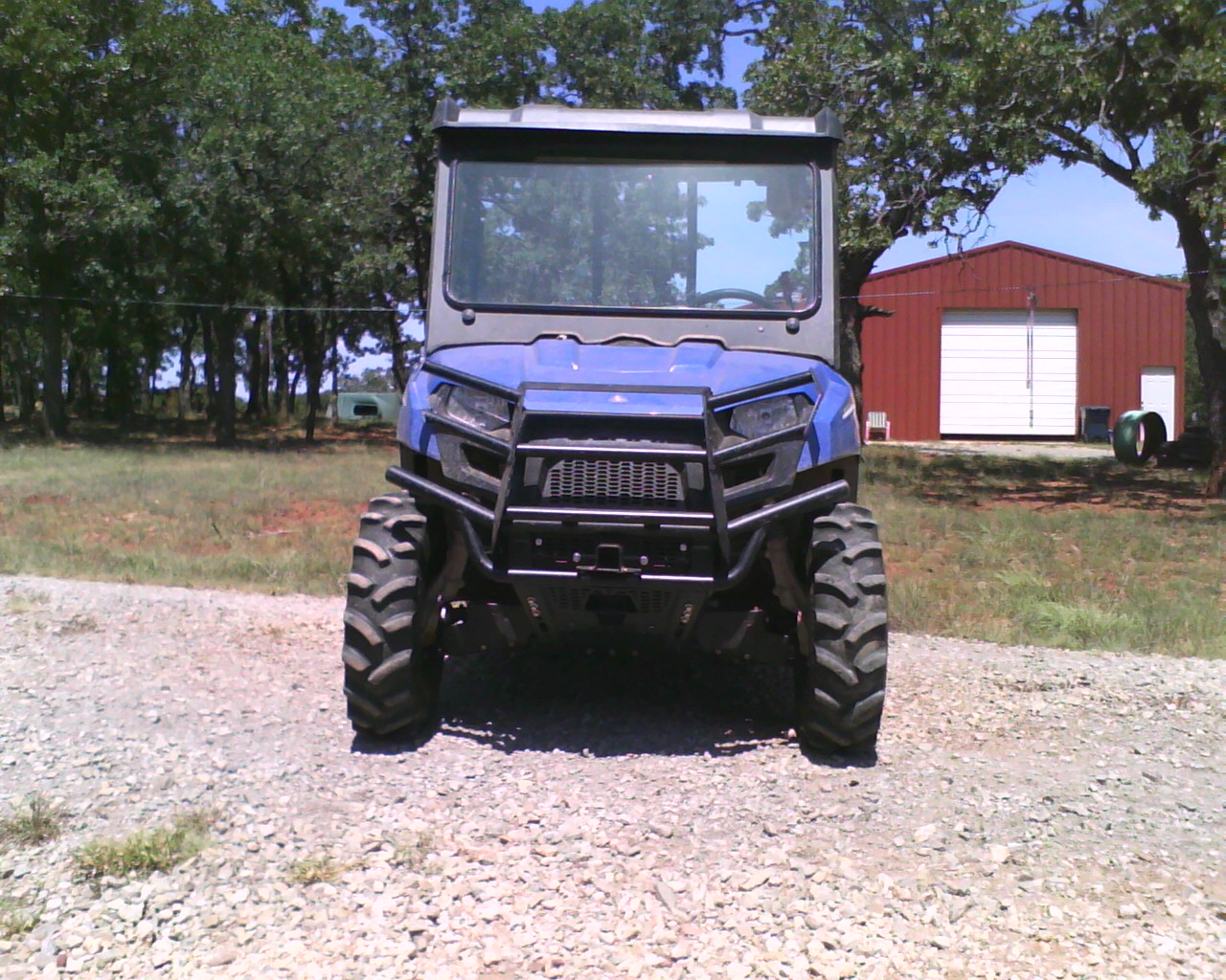

I have six atv/UTV's that go through all kinds of nasty terrain in the oilfield. Sometimes each machine sees 80hrs of use per week. The best product I have found is highlifter tire sealant. It isn't cheap at around $18 per 32 oz bottle but it works. Since using it I have never had a flat unless it is a big hole in the sidewall. It doesn't seem to go bad either I have some machines hat have had it in the tires for at least three years and it still works good.
