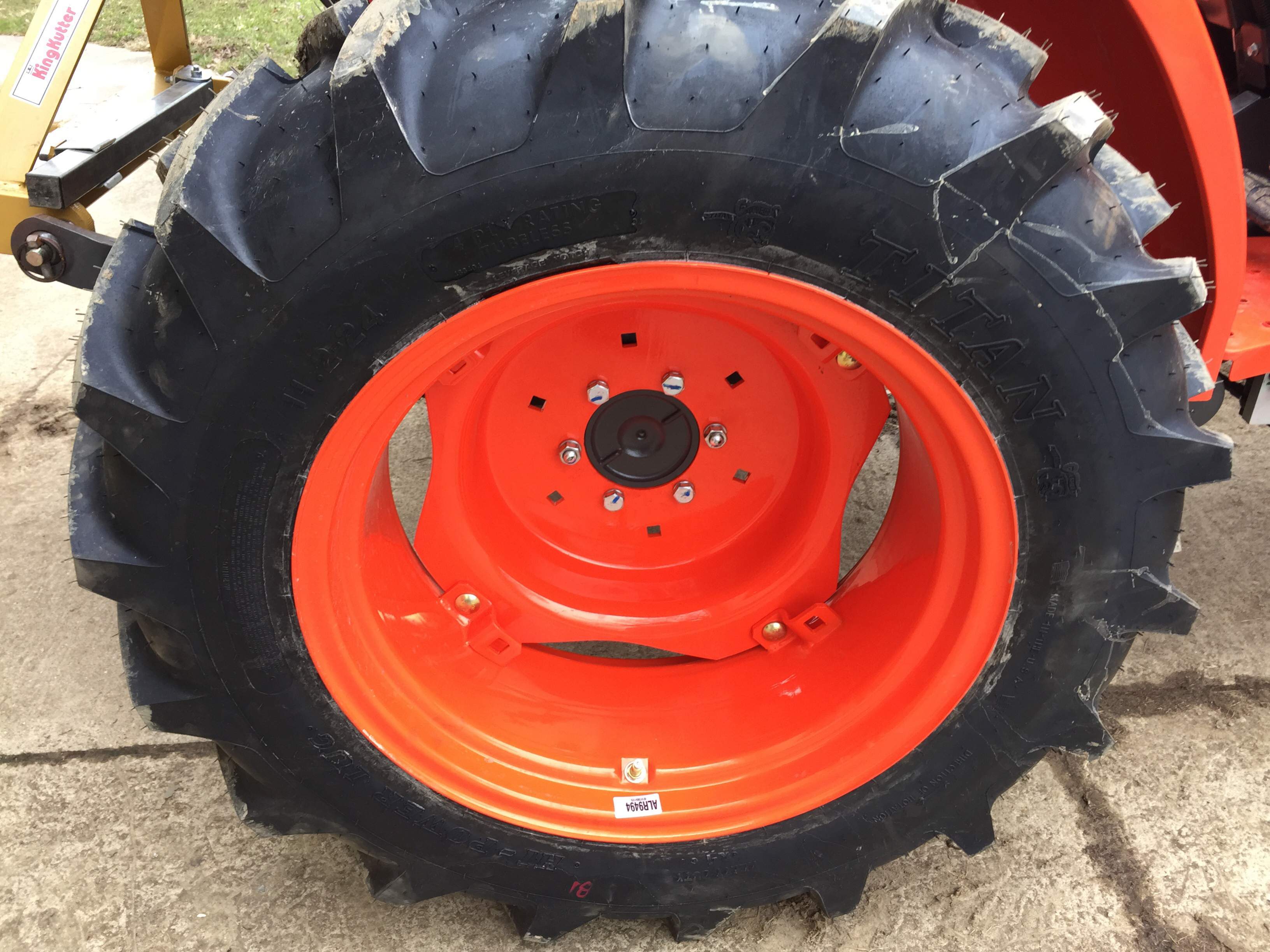

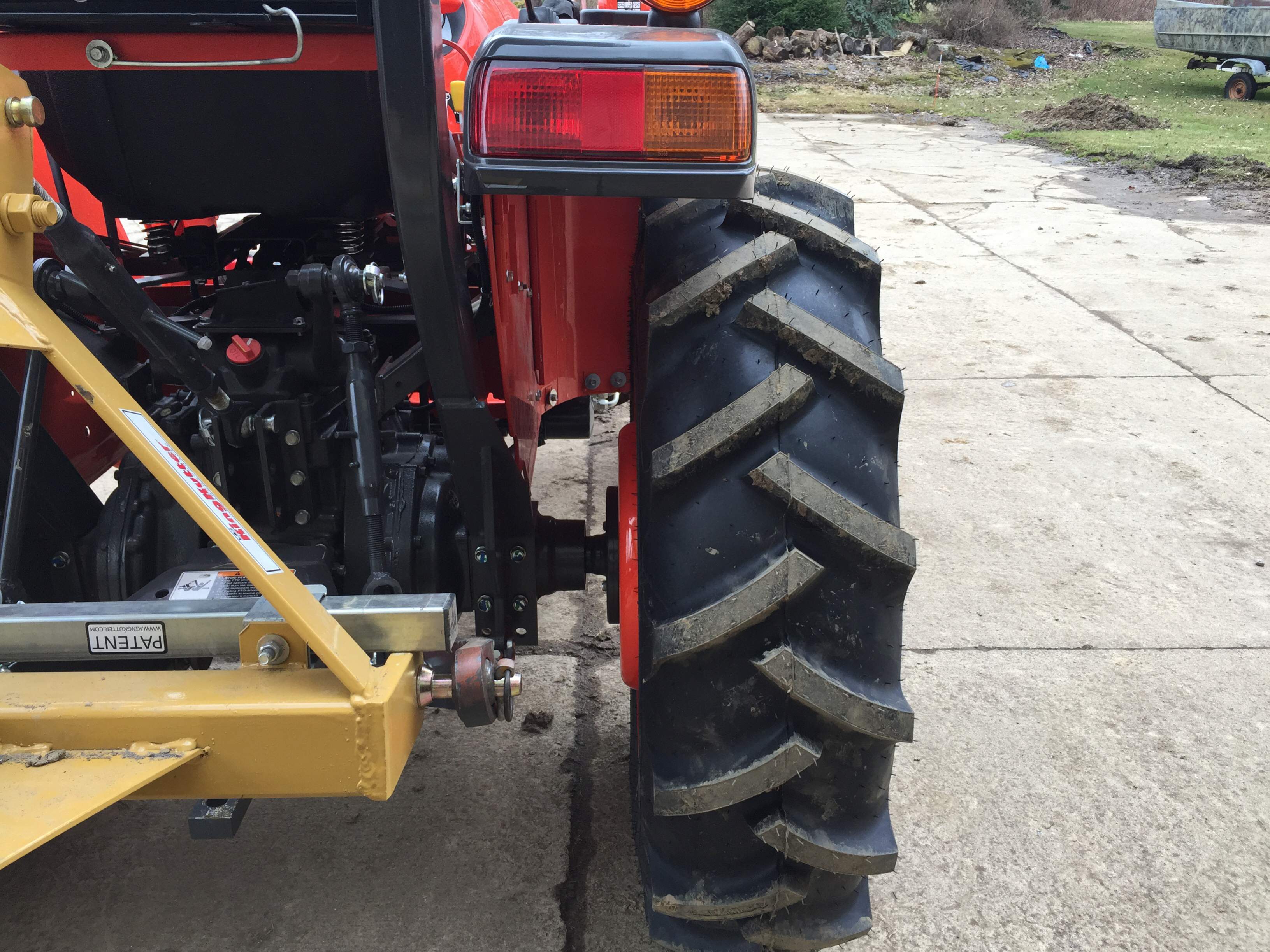

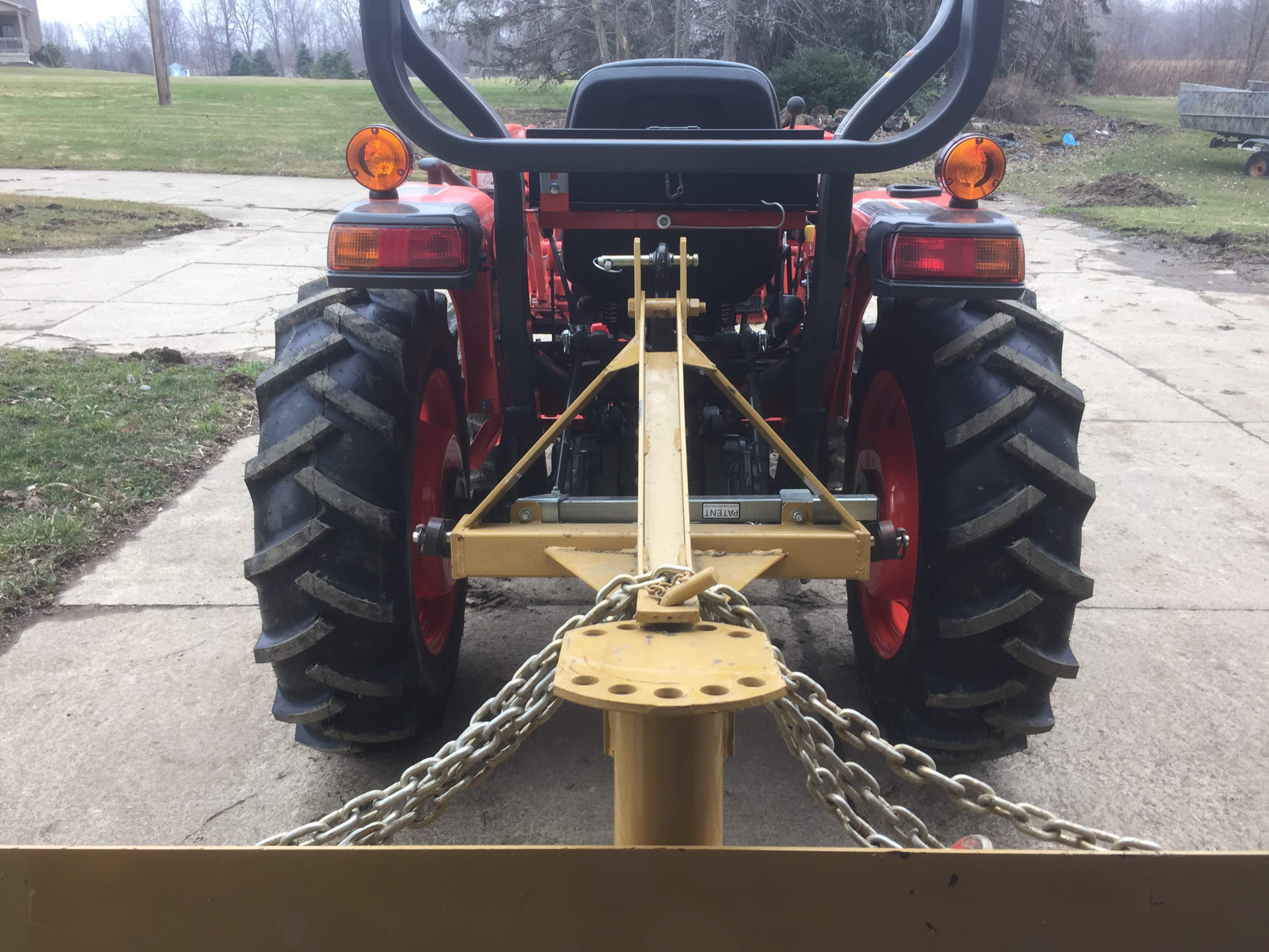

Took about an hour and a half. Took all 4 tires out to then widest possible position. Thanks for the help guys. Wasn't as big of a deal as I thought it would be. I've got about 6 inches between the inside of the rears and the inside of the fenders. Before it was 2 1/2 inches. Should be was more stable now. Here's some pics for ya'll.

We are all glad to help when we can. Now we can talk about loading those tires if they aren't already. And if that still isn't stable enough you can always add spacers.
