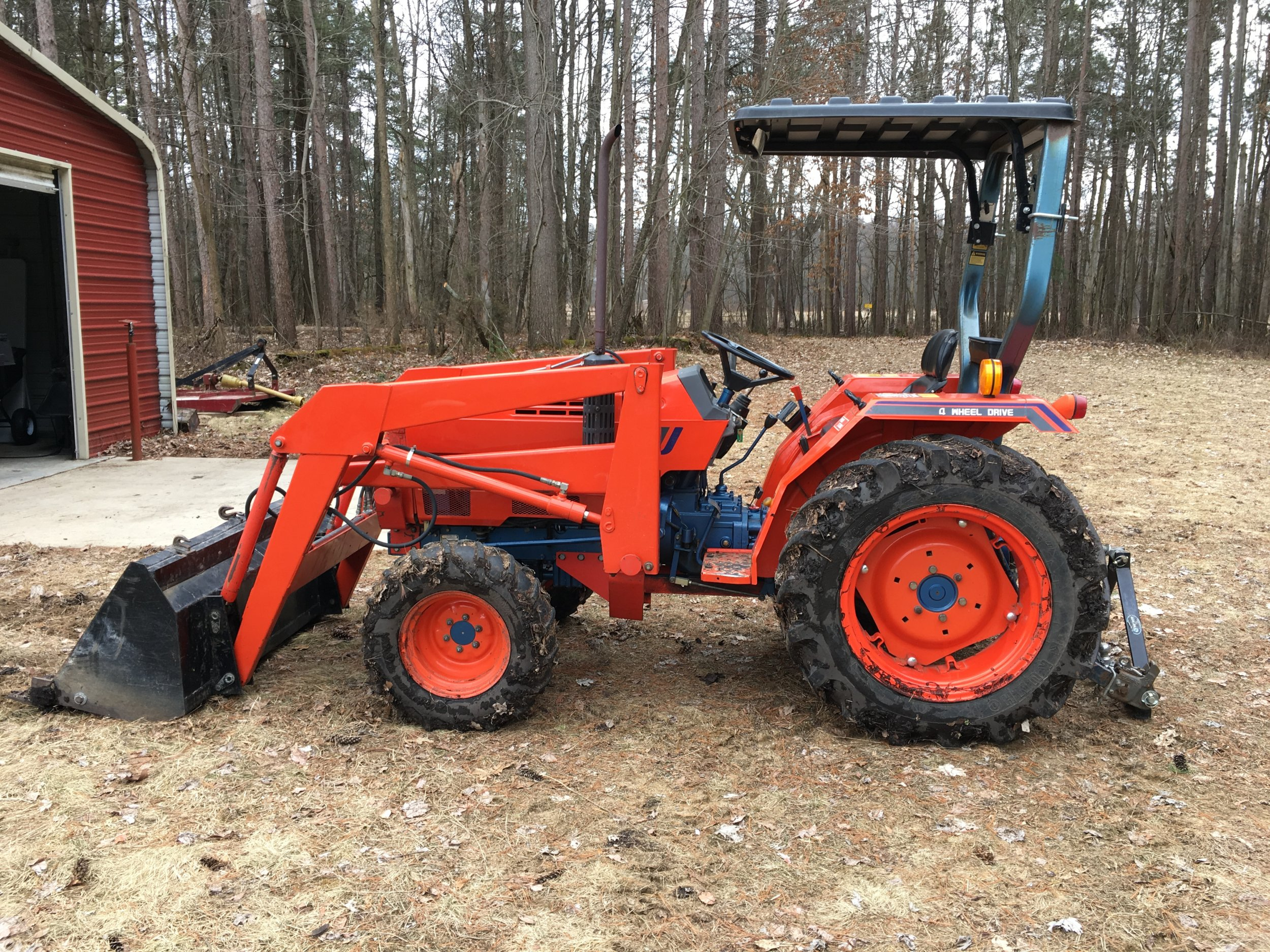

I am getting ready to pull the trigger on a new tractor for my hunting land.
My land has low spots, hold water except for summer, softer ground and some firmer areas.
I do a lot of grunt work with the tractor from front end work, food plots tilling and discing, dragging tree logs etc.
My current tractor has AG tires and has performed very well but my new tractor will have twice the lift capacity and thus I am concerned about AG tire roll over on the front end so considering a heavier ply, wider tire setup. I lift some heavy box blinds etc with the FEL. I am trying to decide if I should stay AG, or R4 or the new R14 and I only have experience with AG so any advice is appreciated.

You may want to consider rear tire spacers for stabilizing,also some day you want to use tire chains.

You can't go wrong with AG tires, it is the tire that offer the most tractions and is built for what you want to do ...the R4 traction is simply not there ... the R14 is a hybrid between the Ag, R3 and R4 and its load capacity is not bigger than the AG but it is a tire that will be easier on the terrain then the AG.

thank you, been scouring youtube for research.
Another factor I was thinking of was heavier ply tires over AG since I do a lot of in the woods, over logs etc work as well so something more sidewall puncture resistant would be a benefit.

Ok, thank, was looking at chains earlier. I am hoping someone can chime in on the R14 performance as I could not find much info googeling around.

you can always get the fronts tires fill with foam ... I wouldn't be worried about the rear one.

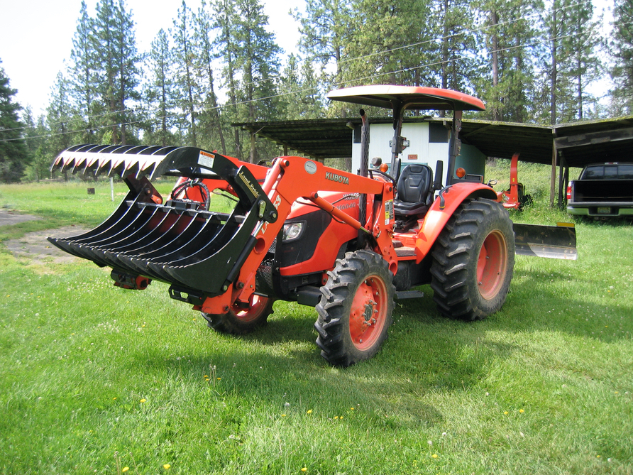

We have no idea how big your new tractor is - but...... I have a Kubota M6040. With the FEL, grapple, loaded rear tires and HD rear blade - it weighs 10,100#. I have six ply R-1 Firestones - front and rear. I lift heavy pine logs and very large rocks. Some times as heavy as 3000#. When I get a lift that heavy - I lift just enough so the grapple clears the ground. I call it - knuckle dragging.
I've NEVER had a problem with rolling the R-1's off the front tires. I run the front tires at 40psi.
