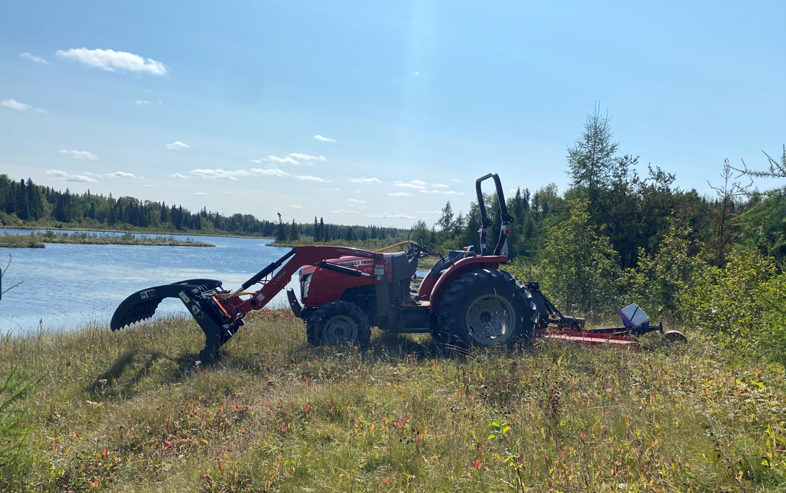

Lol, I wish.
I bought it 4 years ago and it had no habitat or hunting plan improvements whatsoever.
I have had a lot of big equipment come in over the years as well as some logging done to help get it kick started.
some of my Oaks I had the loggers leave the tops not realizing just how large they were so I have been working to cut up the fire logs and drag them out mostly, creating food plot trails etc.
Plus annual jobs like tilling, planting, etc.
Its nice to see the work pay off as I have put 3 Bucks on the wall in past 2 years.
me and this old boy have done a lot of work together but time to upgrade.
