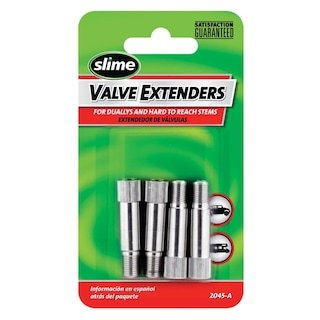

Valve stem extenders?

I see the extender picture. Not sure if the extender would push in the valve enough, if my fill head doesn't. It might. But I don't like the idea of another place to leak. I am thinking I will replace the valve and see what happens. Might learn something.....

You are refering to the valve core. I doubt that replacing it will make a difference. In more than 50 years and hundreds of tires,I don't recall a single time that I experienced what you are talking about (inability to put air in tire),,,,,,,,then about 10 years ago I thought something was wrong with the chuck on my air hose. I replaced the chuck and had the same problem. I have wrestled with the problem ever since. I somewhat solved the problem by keeping stem extensions in/on every truck,tractor,car and atv plus a few in shop near compressor. I haven't figured out whether the problem is with stems or chucks but it's a pita for sure.

Extenders work for me. I don't leave them on the stem. I screw the extender on,air tire up then remove extender and return it to where it will be handy next time.
