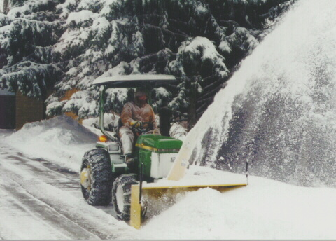

Since you have a paved driveway let me suggest you consider tire chains made with belted cleats. This prevents any scuffing damage to asphalt or concrete which will occur when you spin tires with all metal chains. The attached photo shows these chains on my John Deere 955. I use them on both front and rear with no problem. Having them on the front is not so much for straight ahead traction as it is to improve steering control. I found out about these belted chains from a guy who has posted on TBN in the past--Dave Anderson of Deer Creek Equipment, Oxford, PA. Phone 800-255-6567.
