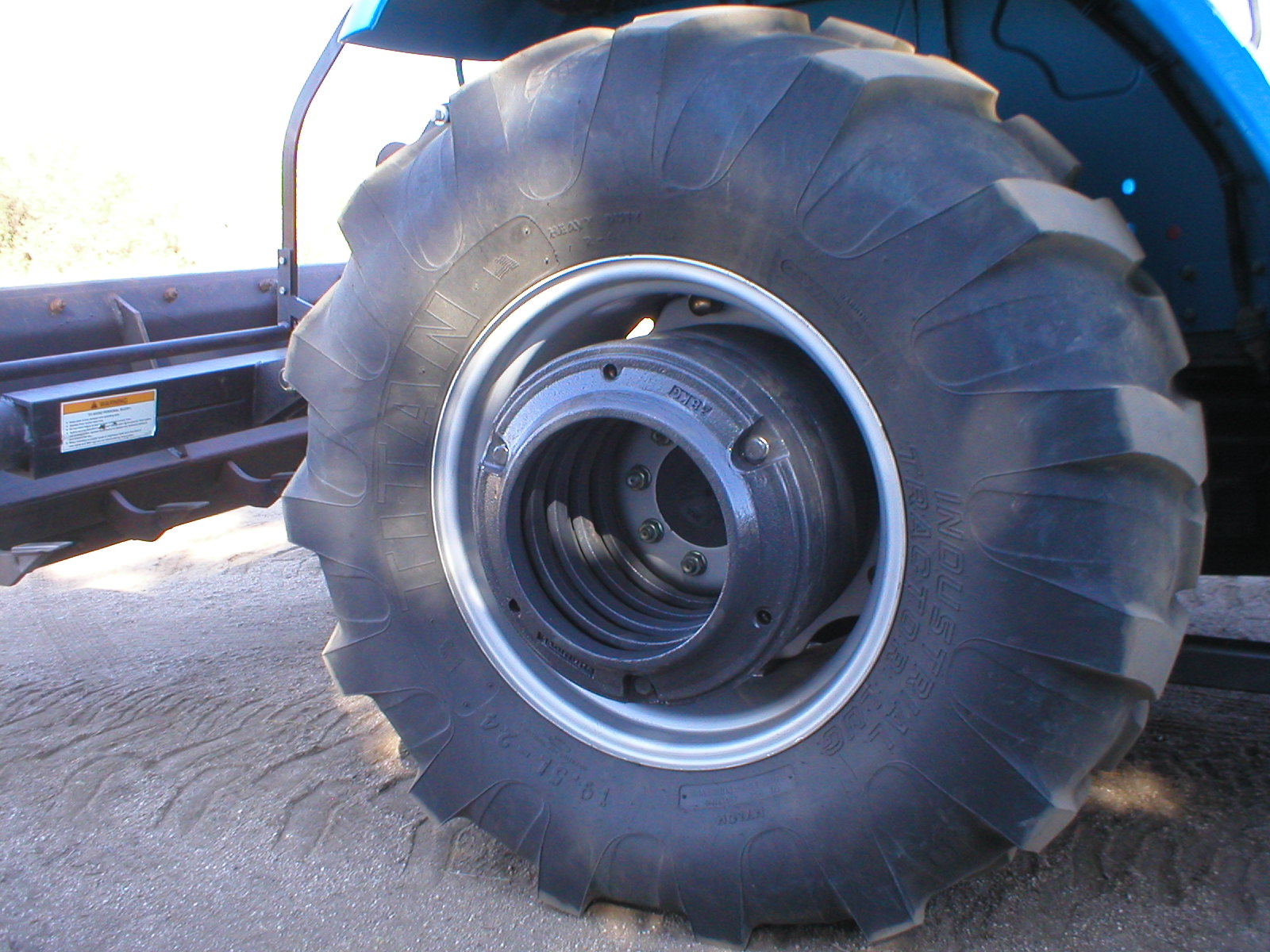

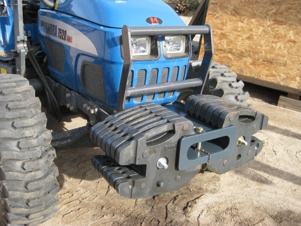

Sellercreek, the owners manual for my 3215 only recommends filling the rears, but then goes on to say that front weight improves steering. I do not have any front end weights. I believe that the front end weights weigh more than the fluid in the tires, so I don't see how this is any more detrimental than having the front end weights on. My 7520 manual says nothing about front or rear tires being loaded. It only says how to and how much.
Does your manual not recommend filling as in it says "do not fill the front tires" or does it just not recommend it. My 7520 manual recommends filling the tires to aid in traction and then if that is not enough to add cast iron wheel weights. It does not say "do not fill the front tires" It basically says to add as much weight as is necessary to get the proper traction for the job.
If you have been happy with how your 6000 performs, then there is no reason to change, but if you have had steering or loading problems, then I suggest that you try loading the fronts. It seems to me that the tractor would be feel and handle better on the slopes with all the tires filled.
But then I have taken the (as much weight as it takes to get the job done) to heart. Beside having all my tires filled, I have as much cast iron as I can reasonably get for the 7520.
Just my opinion ;)
