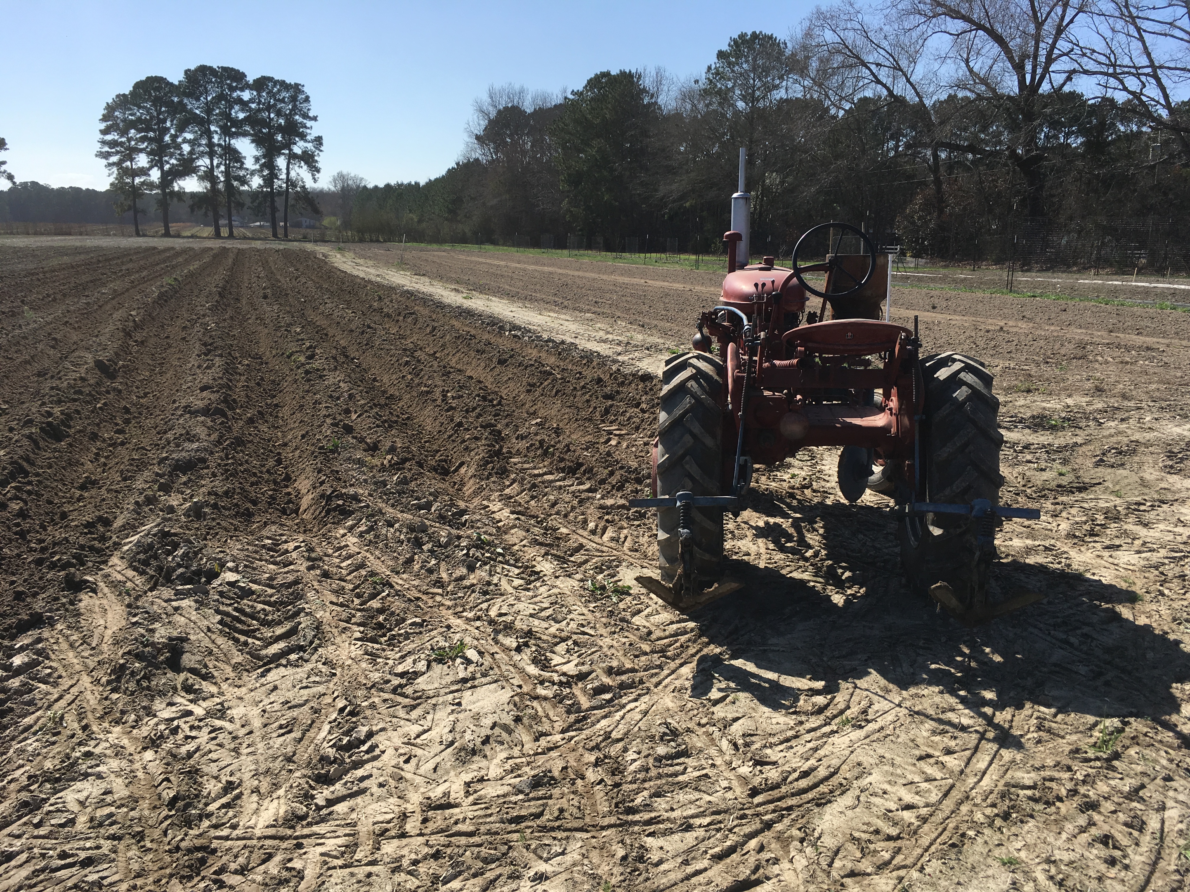

OP seems to have left forum, but those of you with Super A's,
my 11.2's have worked extremely well. Yes they look smaller than the 12's that came with it but
looks better balanced. Gone through really muddy areas, and it never slipped.
On a warmer day going to clean the tractor (I've never washed it since I got it two months ago, like the old look...) and then I'm going to put several coats of 303 protectant on the new tires.
These tires don't seem to wear out, they seem to just get old and sidewalls finally crack and give up, and even that takes a while. Life in the slow lane.
