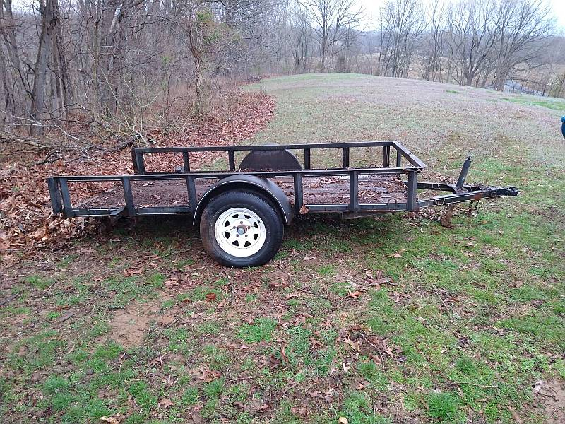

Once I get the Mean Green Tahoe Machine, I'll be able to do things I never could. One of those will be to haul the Little Blue Diggin' Machine. But I have questions.
Neighbor has a 5 x 10 trailer that has been stuffed off in the woods for many years, 15 at least. I pulled it out of the woods a few days ago and began looking it over. Structure is fine, but it needs work. Deck is probably shot and will need new planks Fenders are dinged a bit but can be straightened. One tail light mount is bent. Tail lights and wiring are shot and will need to be replaced. Trailer jack is tilted several degrees (mount plate is torqued) and will need to be straightened.
But for now, the question is on tires. Both are shot, unusable. It has P205/75R15s on it now, most likely not original. Tire store says those are not suitable and it needs trailer tires at $100/ea.
Tag says GVW is 1,575 and GAW is 6,600 (if I can read it right since it's very faded.)
Opinions?
Tag says “215/75” so go with that. Most likely a 3500# axle. Compare to one’s being sold at tractor supply. Tire shop is probably saying to do not put regular automotive tires on it because they are not suited for trailers. There are probably thousands on the road with them anyway but not encouraging you to do that.

Diggin It, look at the tag, call the phone number and talk to them. Maybe with a few pictures of trailer and tag, they can figure out what the trailer is rated for and what tires should be on it. Jon
   / Tires on a utility trailer. #19
In my opinion that trailer has too much rear overhang to safely haul the Little Blue Diggin' Machine:
   / Tires on a utility trailer. #20
Whoa it's only a 5 lug I swore I saw 6 initially oh well looks very similar to my 12' I'd never haul a tractor on it . that size trailer is comes in very handy for other things. good luck.
