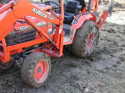

<font color="blue">I can tell you first hand, R-4's load up in gumbo mud and your stuck. </font>
Don't know if we have any gumbo mud around here, but even damp clay on a nearly flat surface can do about the same thing.
Last week I was back filling a ditch in the back yard, VERY gentle slope...could hardly move around sometimes, even with chains on the back. R4 tires...would not know by looking though...as the photo shows...

Yikes, that is a bummer and why we've got R1's on our tractors.

Well, I have to agree with Soundguy here. I sometimes help a guy who runs mud bog races. On his boggers, they basically run a really tall and skinny R1 type tire. A wide tire equals stuck in the mud, generally speaking. Unless you bottom out severely, a tall thin R1 will undoubtedly give you more traction.
I went with the R4's becasue I have mostly finished my heavy dirt work and mostly mow with my tractor. For the times I use my tractor for dirt work, the R4's are fine, but they do not grip nearly like R1's will. I look at the R4's as a happy medium between the R1's and the turf tires. Personally I like them, but for pure pulling power, they do not compare to the R1's.

My comments on traction were in relation to a uniform consistency of surface vs depth. For the typical rain-induced surface muck, tall skinny tires can often penetrate down through the soft muck on the surface to something more solid deeper down. Same thing in fluffy snow - skinny tires can sometimes cut through to something solid.
In the same conditions, a higher "floatation" or wider tire will stay on the slick, wet layer on top.
