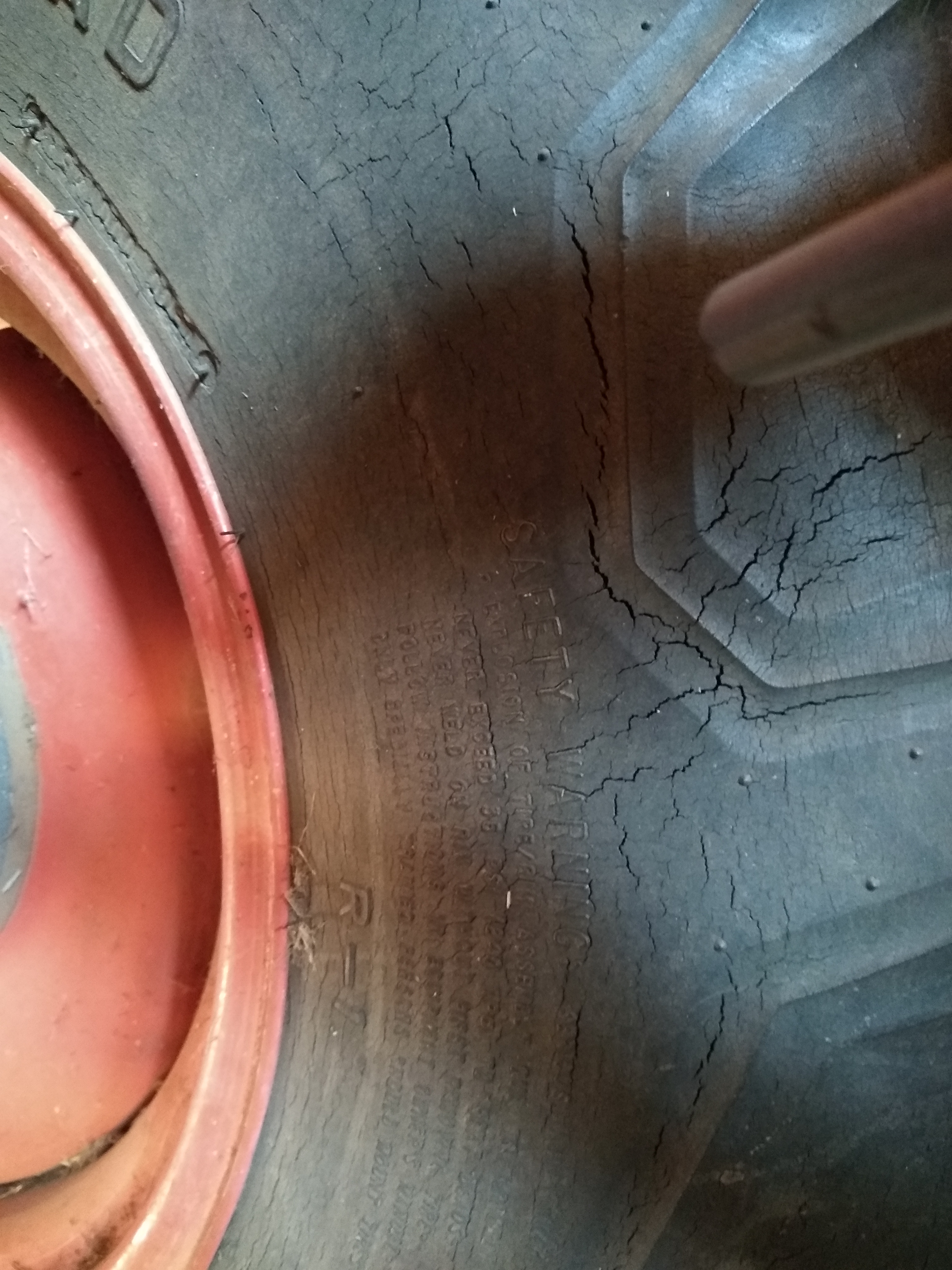

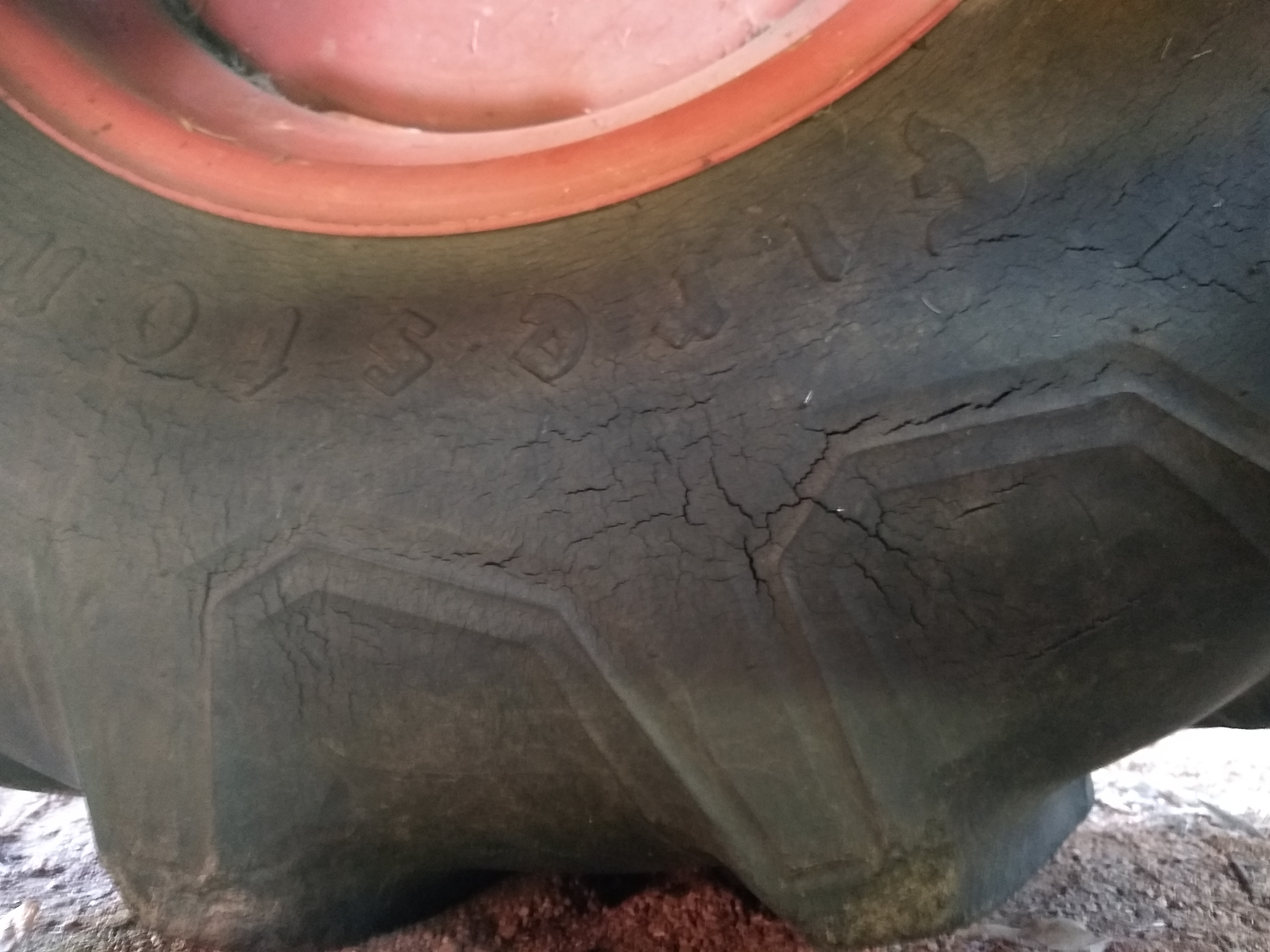

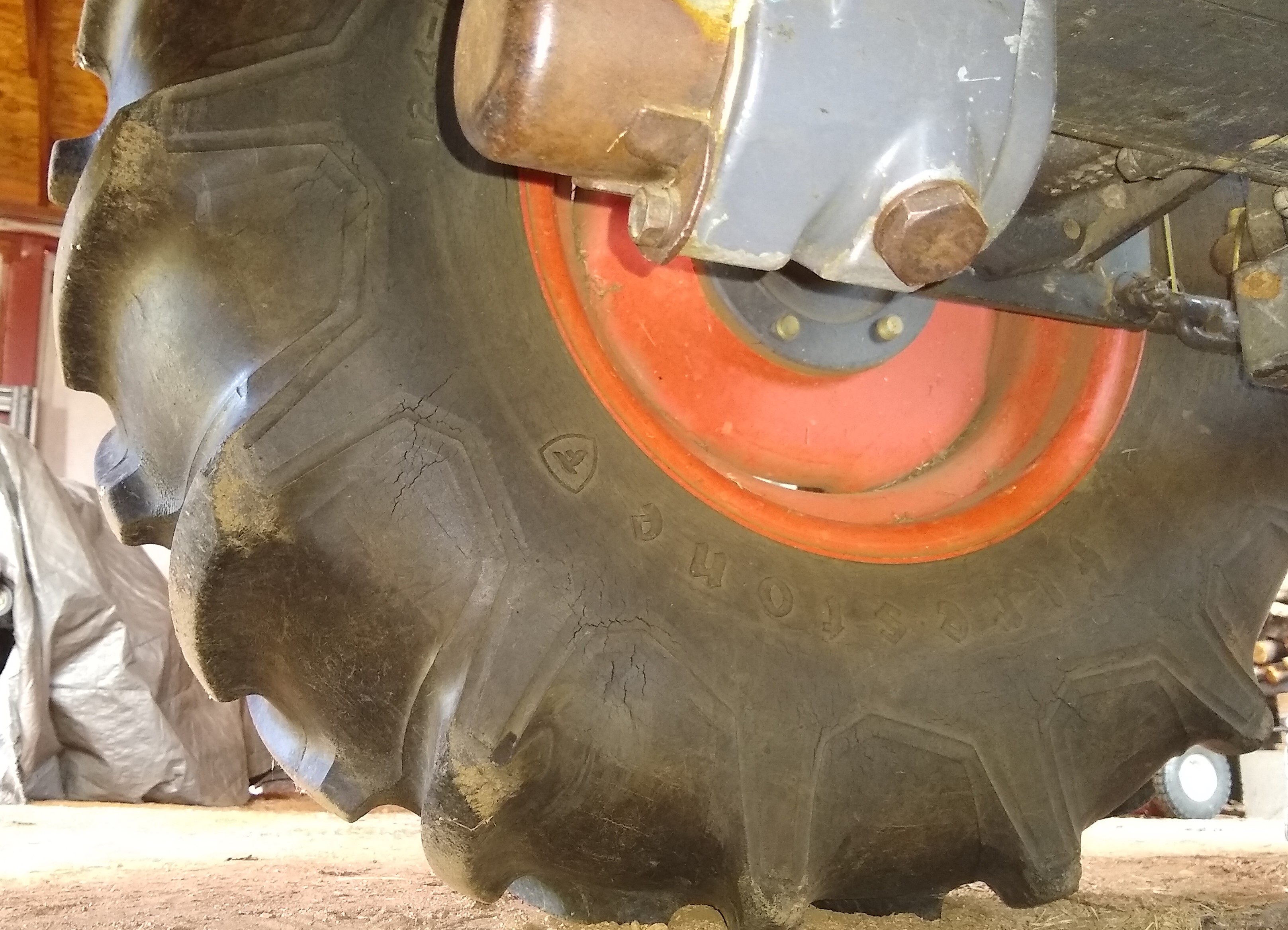

These are inside of tire pics.
I will deflate the "air" on one tire completely and see what happens. On level ground of course ;) Also, this test assumes that the leak is somewhat slow and not a major rupture that causes all the liquid ballast to exit in a short time. To cut the steeper sloped area takes about 1 1/2 - 2 hours. The other areas are only 10-15% and not of a concern. Good level spots are never more then 30 seconds away. Unlike the steep area where their is no quick exit or landing spot.
Buying only one new tire would reduce any possible risk by 50%. Not great odds but better then a casino. :dance1:
Apologies if this is getting a bit lame. Did not expect this much input and expected simple, one word, answers. Can not make a clear decision myself. Money is a factor. If the rear tires were only $75 like the fronts, the rears would have been installed yesterday.

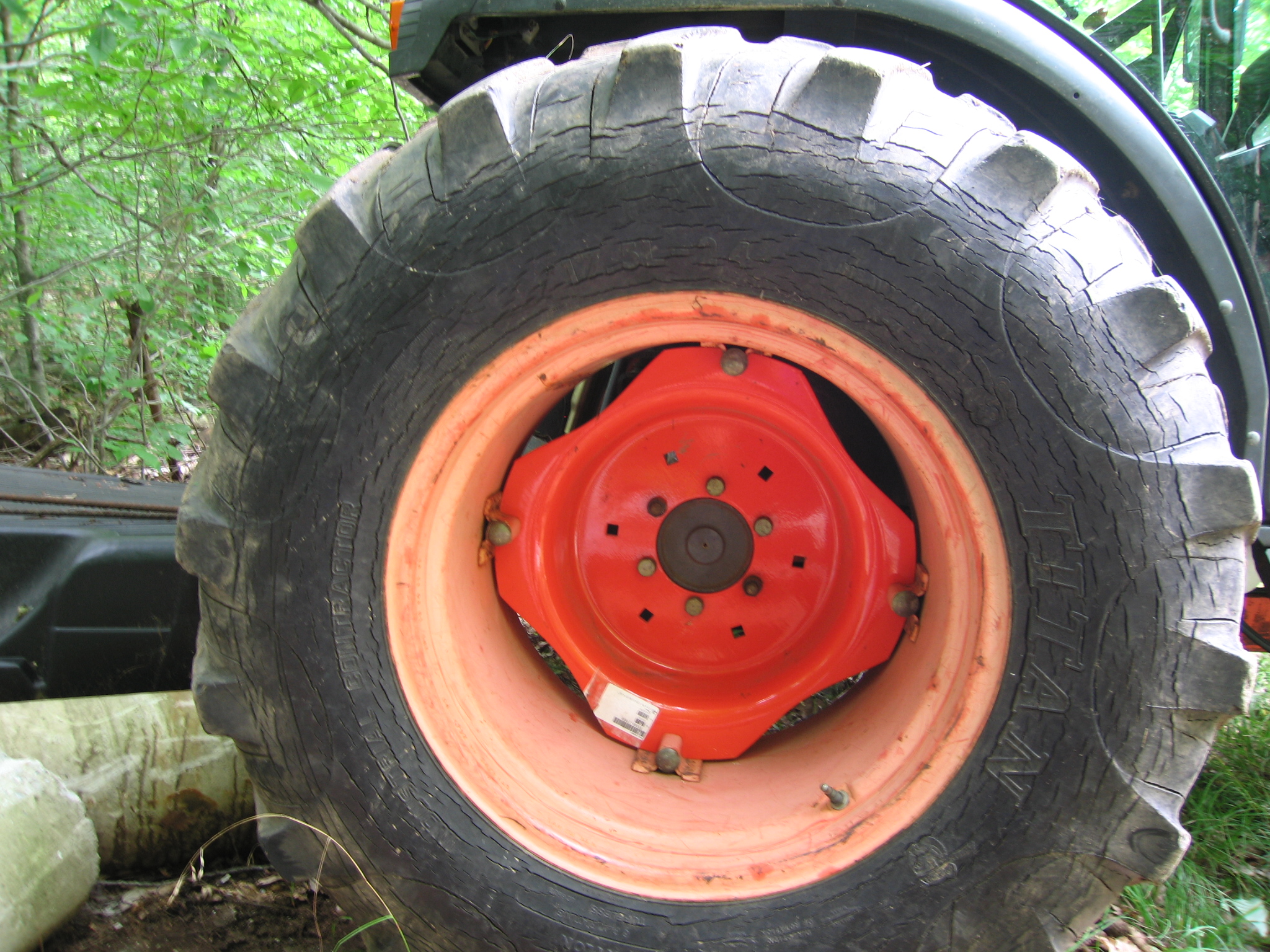

This is 14 years and 3240 hours worth of cracking. They were filled at 2400.
No leaks when I sold the tractor.
