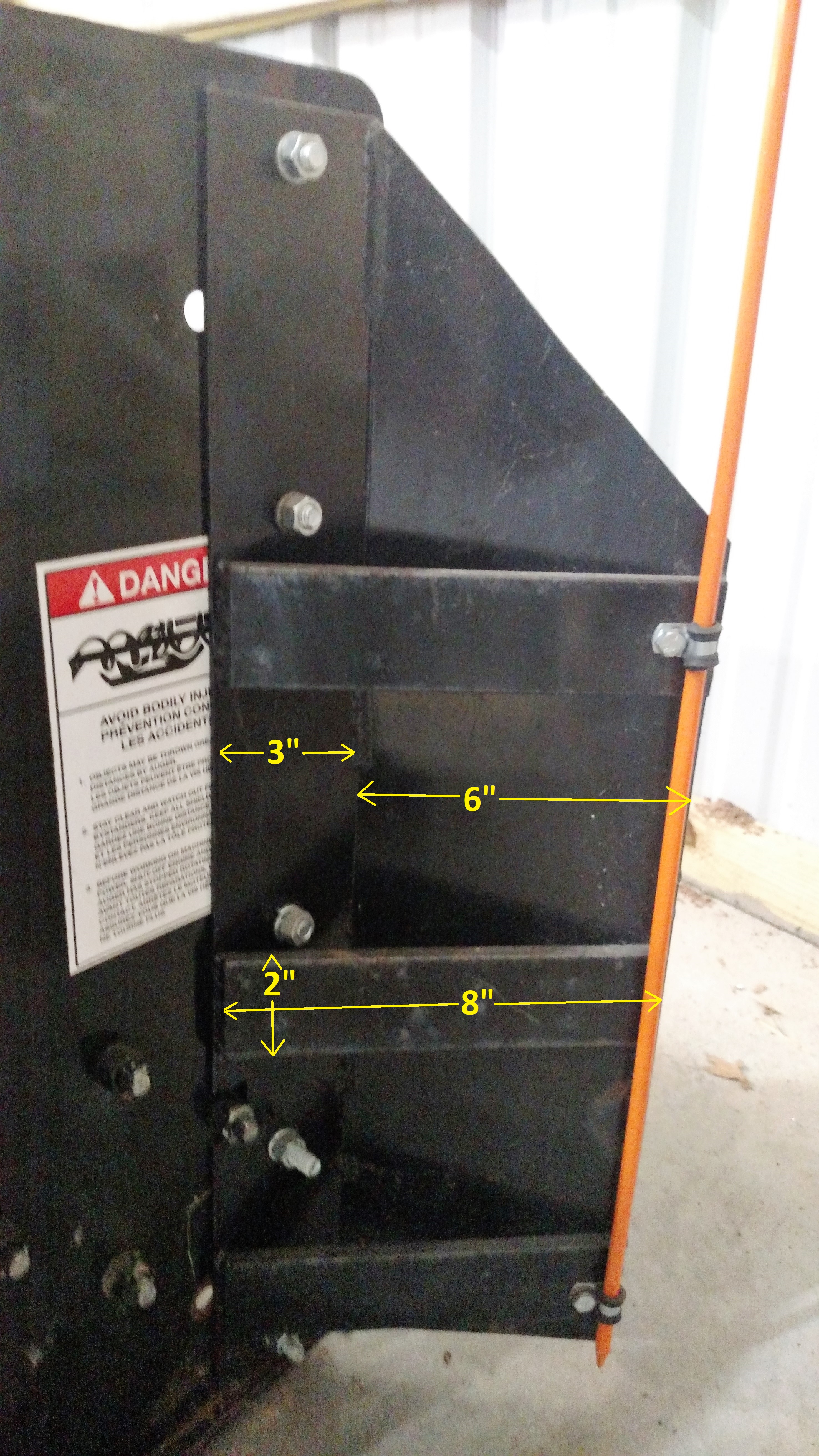

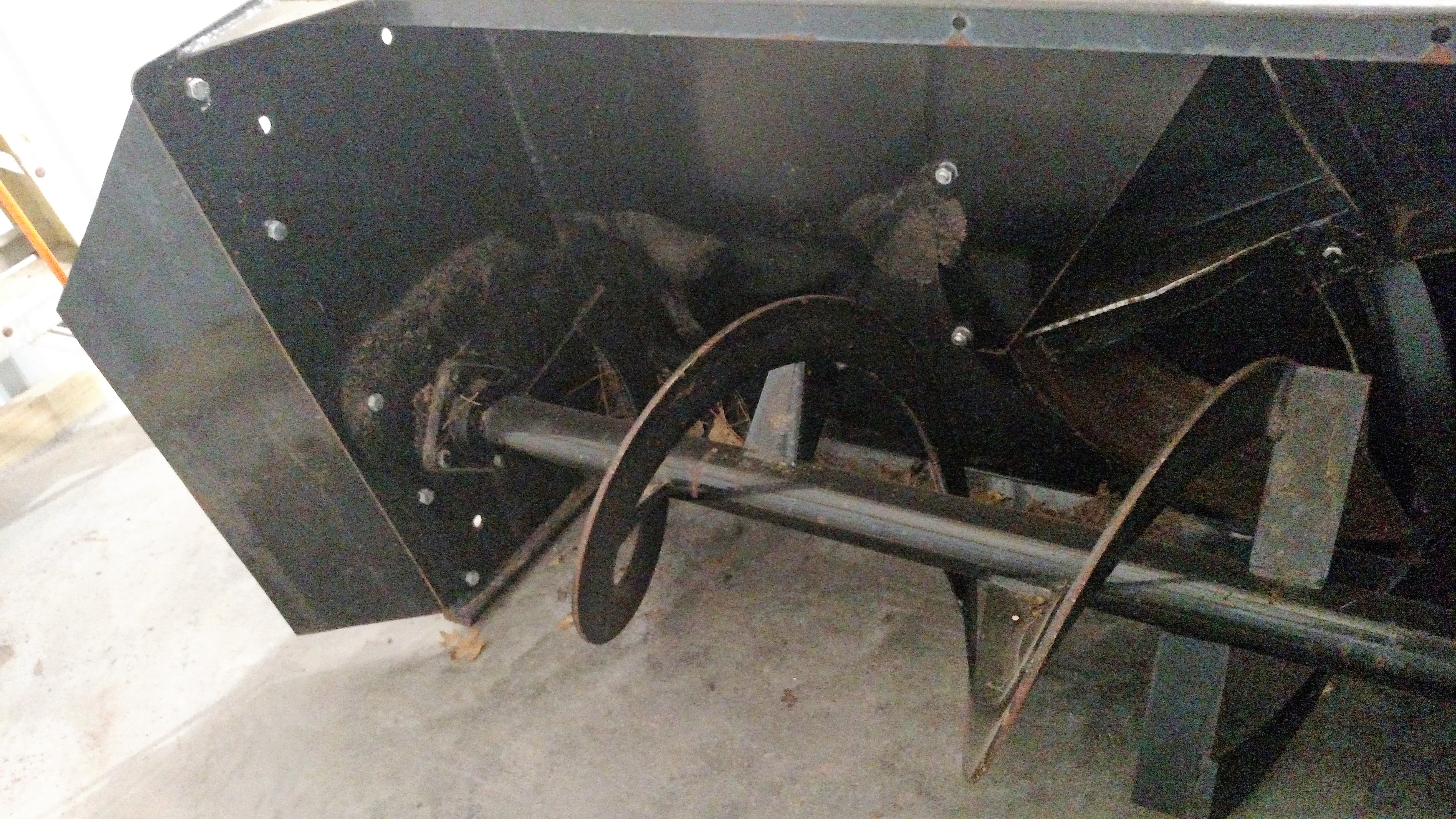

   / Tires wider than the blower #18
Wings are cheap, easy and effective. I made these for my snowblower out of 1/8" steel. They are strong enough to chip the cement on my garage apron without bending. That was not a test, but !@#$ operator error.
