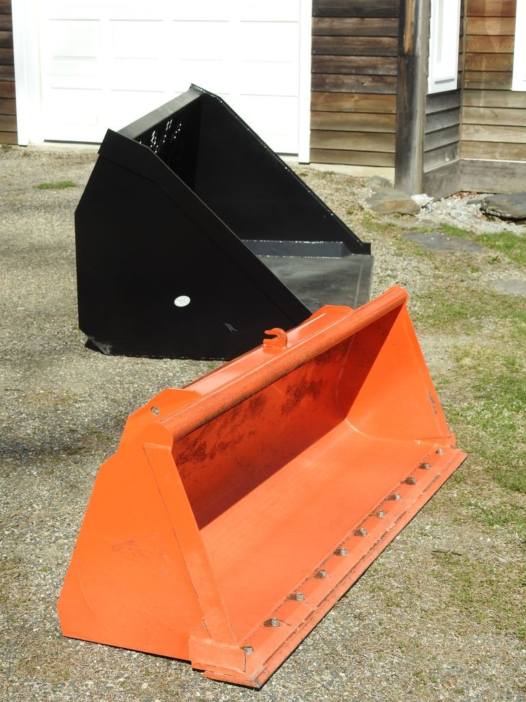

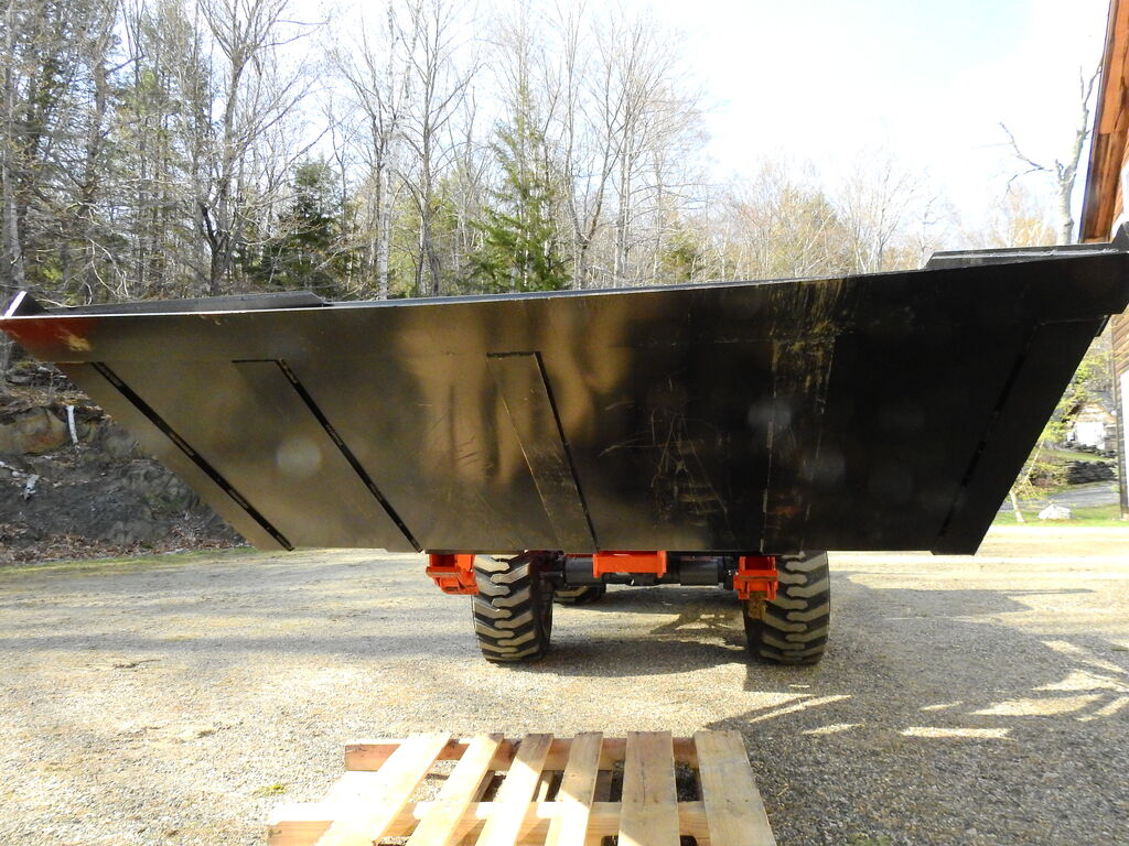

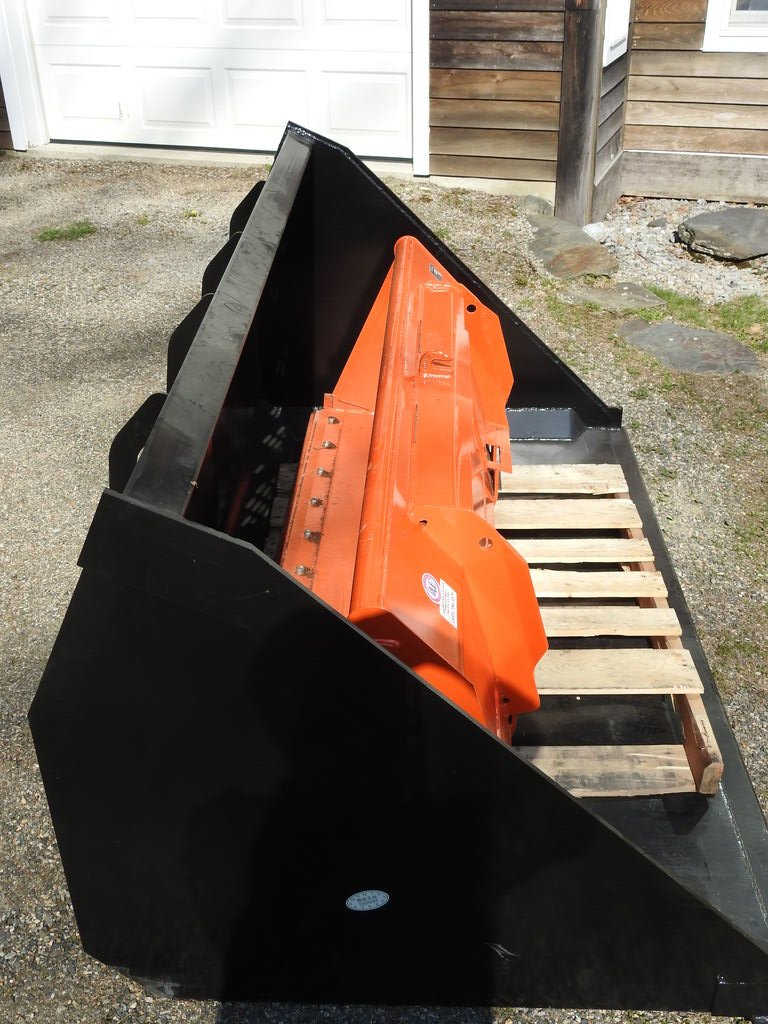

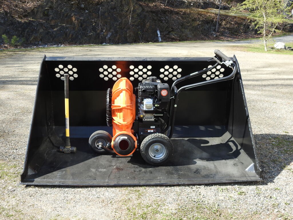

Some pictures of the bucket. We'll start with the fun ones.
That's my L2296 heavy duty bucket in the foreground, about 9 cubic feet struck capacity. The Titan Attachments bucket is 35.xx cubic feet, so nearly 4 times as much.

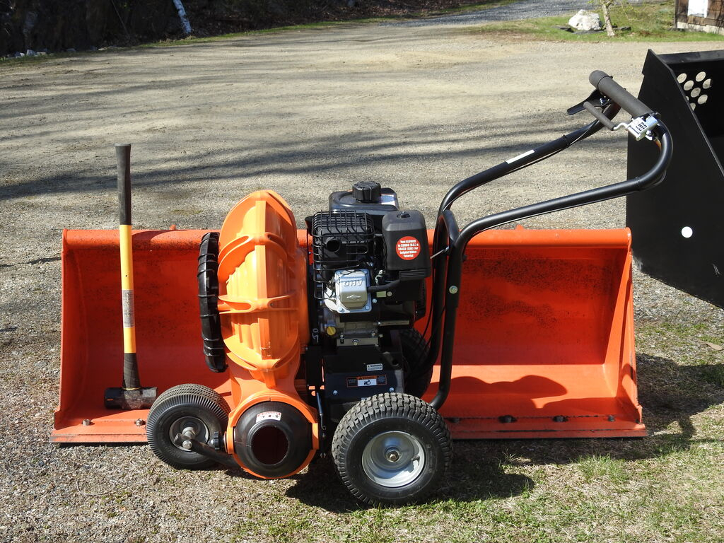

Here's my new Billygoat blower and a sledge hammer to lend some perspective.

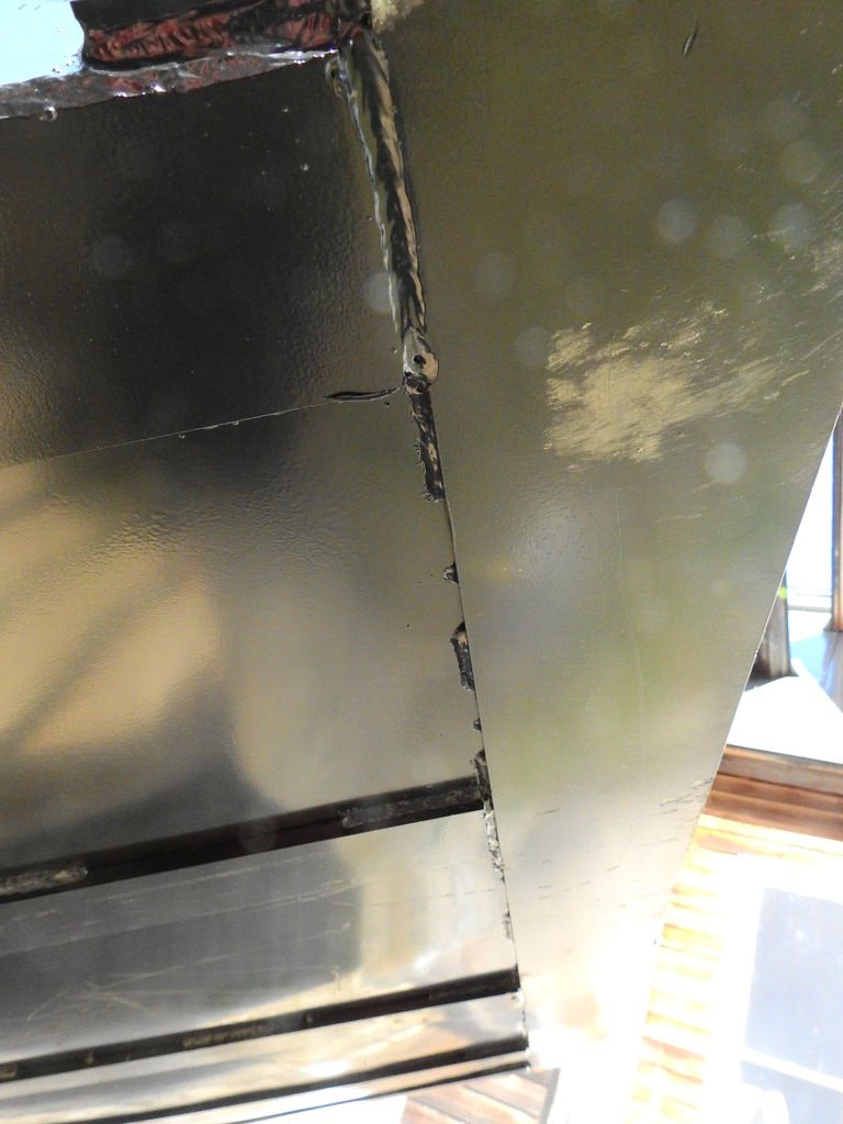

I haven't measured the thickness of the main sheeting yet, the various reinforcement slaps look to be about 1/2 inch, certainly that's all the edge is per their advertising.
If you look at the bucket head on, it is slightly bowed, as confirmed with a straightedge. That's because there's little in the way of reinforcements, gusseting, what have you, for the huge depth of this bucket.
Those plates on the bottom are likely more effective as skid/wear plates than anything having rigidity values. Furthermore, the plate do not connect cleanly with the bucket edge.
Note the top pieces failure to connect by something approaching 1/2 inch, some of the others are a bit closer. Clearly precision and consistency weren't a strong requirements in the manufacturing process. Makes me wonder how it'll do even sliding it into a pile of bark mulch.
Just makes you want to get out there with the welder, doesn't it, and graft some more support onto the thing.

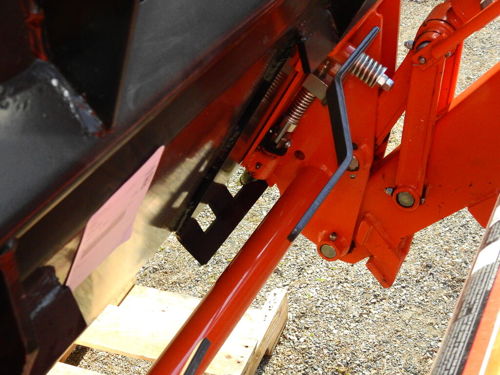

Two other things. The SSQA interlock is perfect (picture attached), and also a picture of the bucket on the MX5400. It's big and heavy, but not overwhelming the tractor. However I definitely would not recommend anything smaller in the tractor department, and it's heavy (and big - as in weight away from the pin) enough that much more care is required in its use with my tractor.
I'll post the steel thickness when I get a chance. Meanwhile, nobody needs to ask about all the things they _don't_ say on the palletforks.com Titan Attachments web page for this attachment, hopefully. They're definitely stingy with the details.
