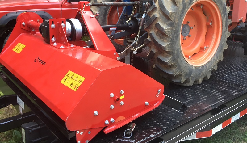

Im on my second full season of using the Titan I bought last summer...72" for me. It takes all of my L4310's 43HP to run this thing in tall grass. The hammers are very heavy.
It worked great for me last fall cutting about 60 acres on three different properties (30 acre slope mowing, than about 15 and 15 mowing around reservoirs. The only failure point being the front chain safety that hangs down to prevent debris from flying forward...the rod came out on one end and I lost half the chain. Titan offered to warranty that if I sent pictures but I guess I don't care.
Now this summer is different. It cut the first 30 acres without issue. But on my second job I hit a rock (nothing out the ordinary) and the mower shakes badly now. All flails are intact and the drum spins freely on the bearings. In my opinion, either the gearbox shaft is bent or the drum is bent.
As has been noted, the rear roller grease fittings are installed straight down with only about an inch of clearance. They are quickly destroyed in a day of mowing. I think you can remove and reinstall the bearing with the fittings aiming backwards which offers more protection.
The main drum has bearings on the inside and outside of the casing. The outer bearings are easy to grease, but the inner ones becomes covered with a layer of grass and dirt build up which must be scraped clean before greasing. It's more awkward to access these grease fittings since the flail must be raised and you have to be somewhat underneath the mower.
The cut quality is fair. My Vrismo mower makes a much nicer, more finished looking cut. The Titan knocks everything down but leaves a somewhat rougher cut. Nevertheless, it is acceptable.
The top-link supports on my mower have both cracked the metal about an inch or so. A weld would fix it, but after only a year of use, it's not a good sign. However, the mower casing seems very rugged. The flails are tough and take hits very well. The rear roller is too small.
Titan seems willing to warranty my shaking flail (I called them last Friday) but their method is to determine what failed by pics and video. I'm doubtful they can make the determination but maybe.
The belt arrangement is four separate v-belts. The tensioning method is by raising the horizontal shaft from the gearbox to belt pulley via a bolt. I don't really care for that method, but the belts have remained tight.
Overall, its a good flail for the money but you can see the quality lapses compared to a higher-end unit.

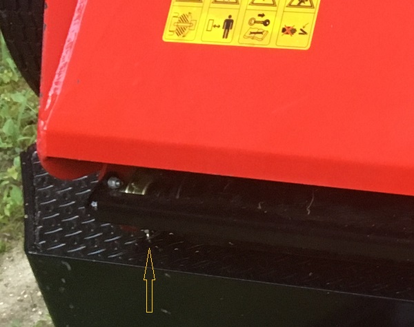

My experience Sunday was almost exactly like troverman's.
I cut for about an hour and then noticed that one of the 3-pt pins had come out and was lost. The lock pin had been pried loose by a branch or something. No surprise really considering the height of vegetation I was mowing.
So I put in a new pin and used a bolt with a lock nut.
The grease zerks that are sticking out of the lowest part of the rear drum/wheel are ground off. It's just a poor design to have them that low.
At some point a few hours later I discovered the rod holding the front hanging chains had lost a hitch pin on one side. All of those chains and the separator collars were gone. The only reason it didn't go all the way out was that there was a bunch of grass caught around the rod and that prevents any additional movement. I didn't have another suitable pin in my tool bag so I put a small metal hook bungie and it held for the last hour. I will call Titan tomorrow and see if they will warranty the loss.
My 35hp tractor did fine on everything but the steep hills with the heavy brush. It did cut pretty well but there are a lot of brambles that would need a second cut. The only other "damage" I could see was that there are some holes in the top of the flail deck that had plastic fillers in them. I don't know why they are there but all of the plastic hole fillers are gone. My tractor has PTO gearing for 540 and 1000 RPM and I ran it on 1000 because the 540 seemed to lack the appropriate "oomph" to really knock the stuff down.

I used a regular 3-pt connection with the top link being how I set the angle. The manual says to have the rear about 15 degrees lower than the front.
Here is what I would change had I known.
The bottom facing grease zerks on the rear roller need to be relocated facing any direction but down. In my case I will just buy a bag of them and use a new set each time I finish mowing.
The chain holding rod at the front needs something better than a hitch pin and because it's not going to be removed ever (or very rarely) I would probably use a bolt with a lock nut.
The 3pt pin came with a linch pin (pin with circle like this: Shop Hillman 1-3/4-in Linch Pin at Lowes.com) I would use something else. Not sure if any kind of quick disconnect pin would stay on while mowing through branches that can grab a loop.

I did not have to swap pulleys.
The second pass did improve the cut because the parts that were missed were the large diameter 0.5"-1", 3'+ tall weeds that would lay down and get missed by the hammers, but there is too much land to make a second pass. The end result is what I need.
I found that on the heavy brush areas raising the mower to about 6" off the ground helped with bogging down and keeping even the bigger weeds consistent with the shorter. Another pass at a lower height would then shred what was left. Not ideal, but works well for the areas where short cut is better, like a road).
As far as happy with the purchase, I don't expect perfection out of a cheap implement. It it continues to work for a few years without any major mechanical issues then I will be happy with it because I look at these things in the light of how much I paid for the time I got out of it. Time will tell.
Update:
I did call and get them to send me a new set of chains and spacers for the side that was lost. I'll attach the rod in a way that won't come off. Their customer service was great.
I think I will try to detach the roller bearings and rotate them 90 degrees in order to save myself the hassle of continually replacing the zerks.

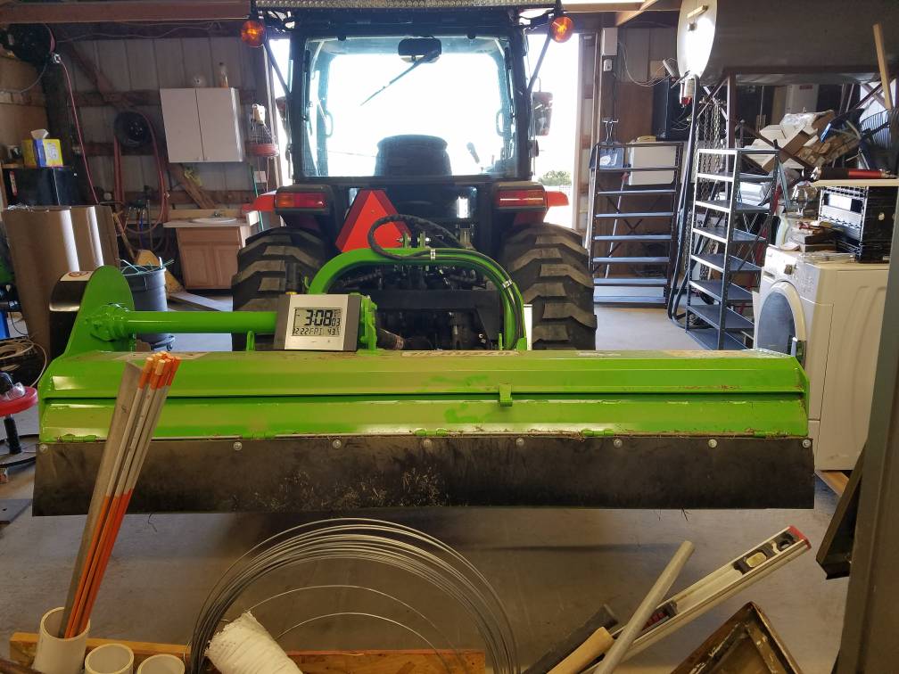

An update on my mower. Yesterday I tried to make another pass to see if the shaking was any better. It was not. The entire rear roller assembly broke its bolts and fell off, taking out a couple of flail knives in the process. The top link uprights also had their cracks worsen. One side sheared off completely and the other side half sheared before I could just get it back to my truck with the PTO off.
Guidshir, I had the same experience with the front safety chain mesh...the rod backed out and I lost half my chains. The rod stopped before reaching the halfway point so the other side stayed. Although its a bad design, I really don't care about these chains anyway. Titan will warranty those...they offered to do so for me if I just took pics. Additionally, my plastic housing plugs also disappeared. I'm not sure what their purpose is, but its a minor thing. And my grease zerks were destroyed and I also install new ones.
As for my mower...I've spoken with Titan and I'm surprised that their customer service seems to be decent. They sent me an exploded parts view of the flail mower with each individual part numbered...they said tell us what parts you need to repair your mower and we'll send them. So they are willing to send me all the roller parts that failed, plus a new drum that may be bent and new drum bearings and a couple of flails. That satisfies me. When I reassemble everything, I will most certainly change the angle of the roller grease fittings by rotating the bearing flange 90 degrees so the zerks point straight out the back and are less likely to be damaged.

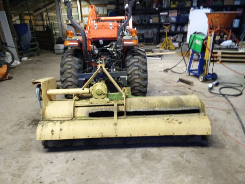

ddbackhoe, to answer your questions:
The Vrismo and Titan are using hammer style flails. The flails on the Vrismo are lighter weight, a little smaller, and more of a duckfoot. The hammers on the Titan are more square and are definitely heavier and more suitable for brush.
As for rollers, the Titan uses one that is about 4.5" in diameter. The Vrismo uses a 7" roller. Not only is the Vrismo roller heavier, but it rolls over terrain better and the bearings are smoother. It is mounted in a much heavier-duty manner, and has vastly better grease fittings.
You do not have to have a floating top link. Just a standard connection and I set mine to just about level with a slight rake to the front.
I don't have a lot of great pics, but here's one I have:
