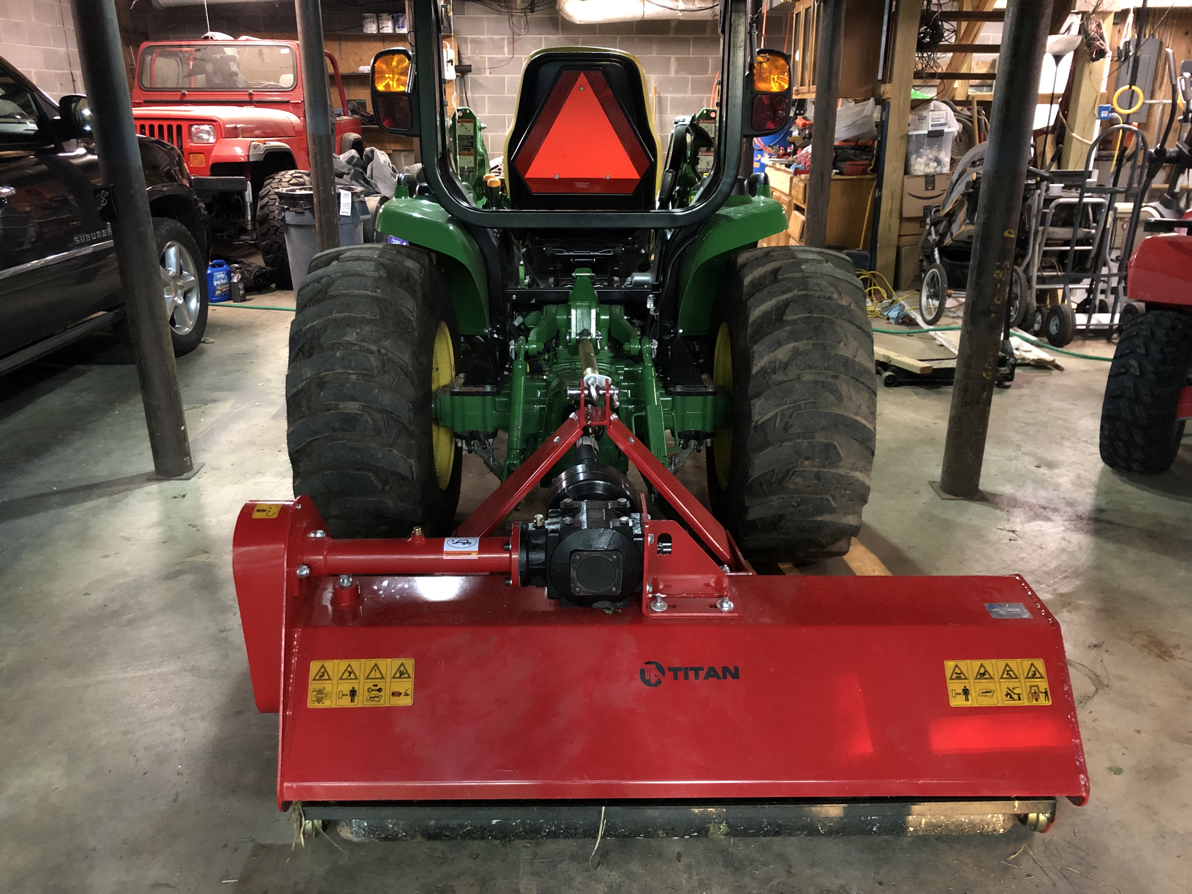

Thanks for the foto Fallon. I think I'll try my QH top link bracket to see if that improves performance on uneven ground.

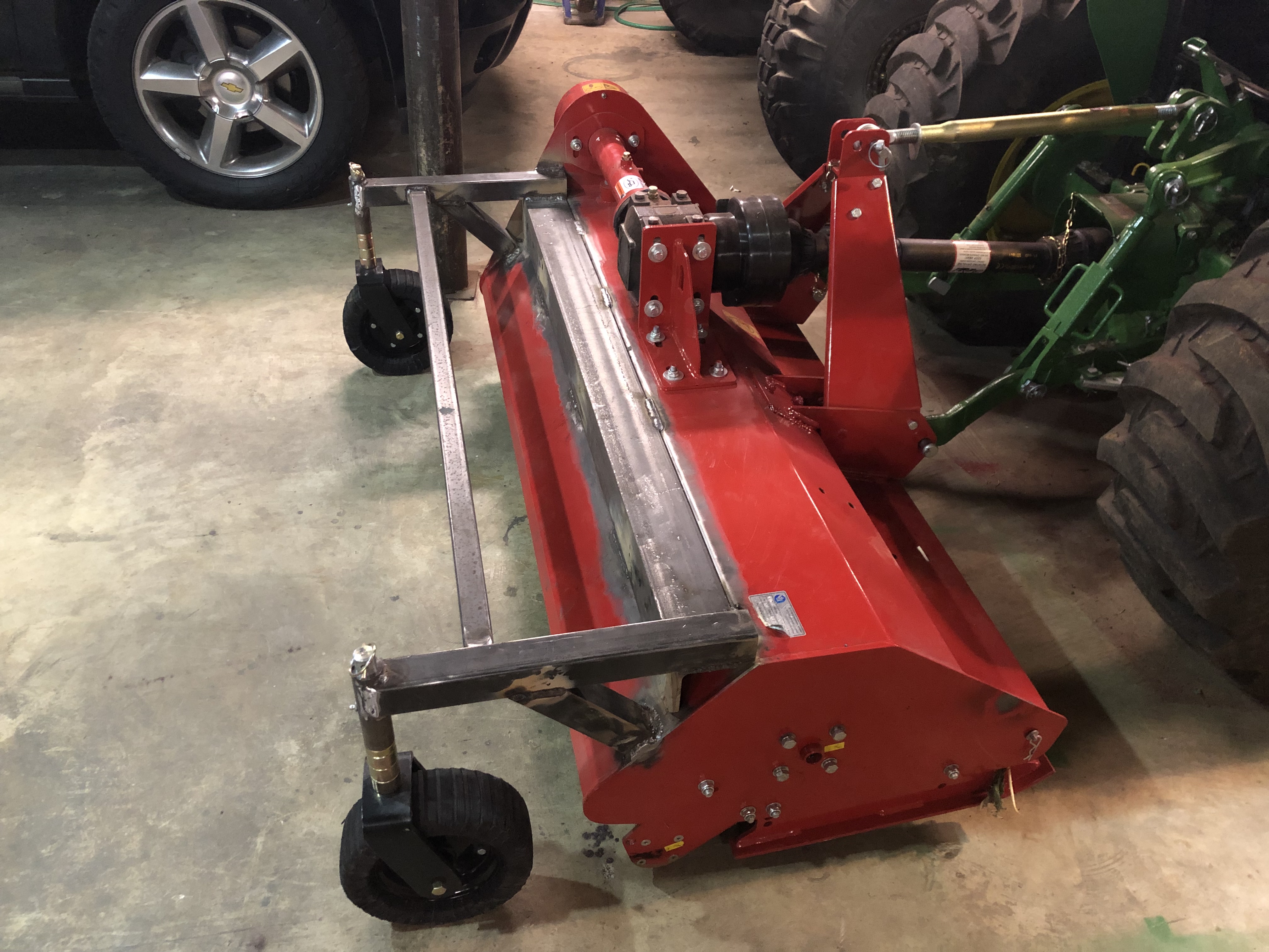

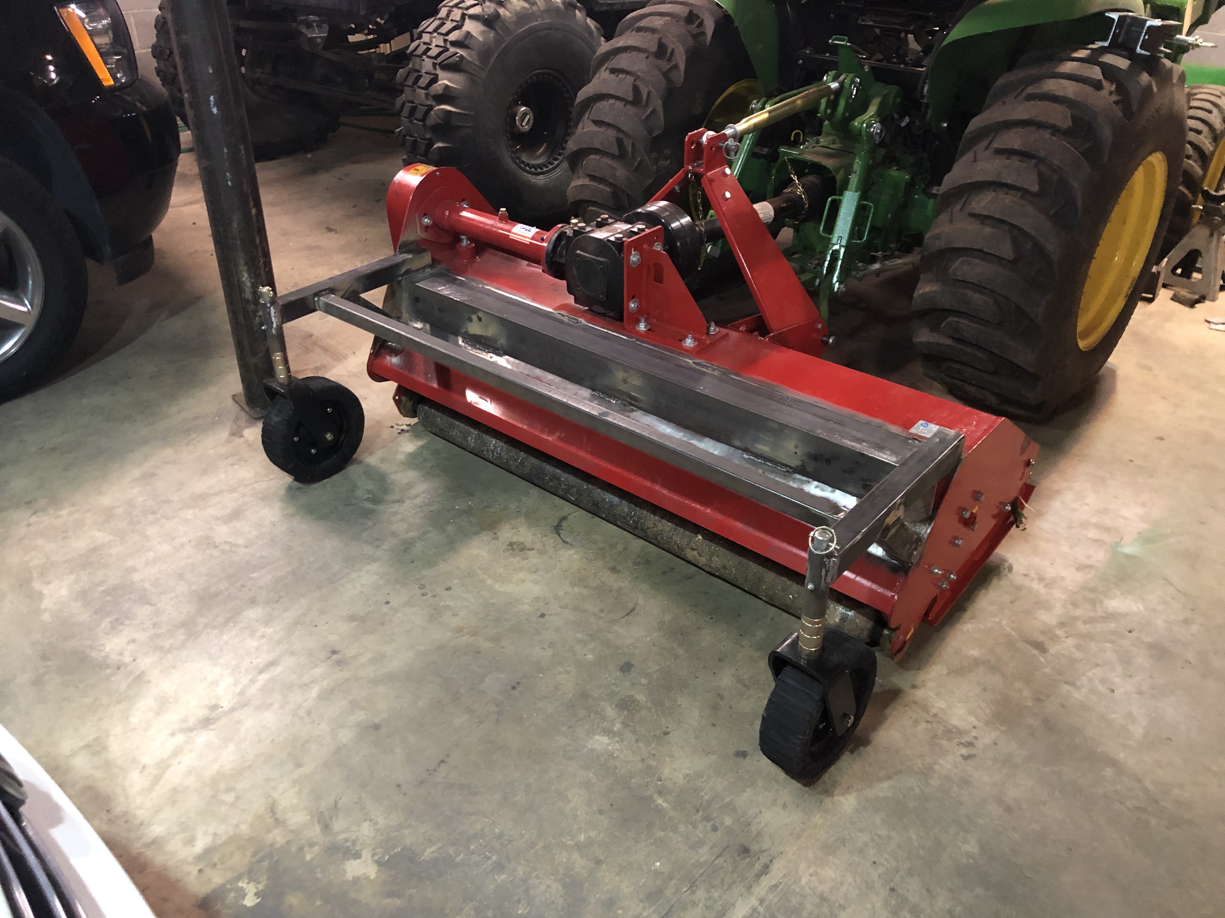

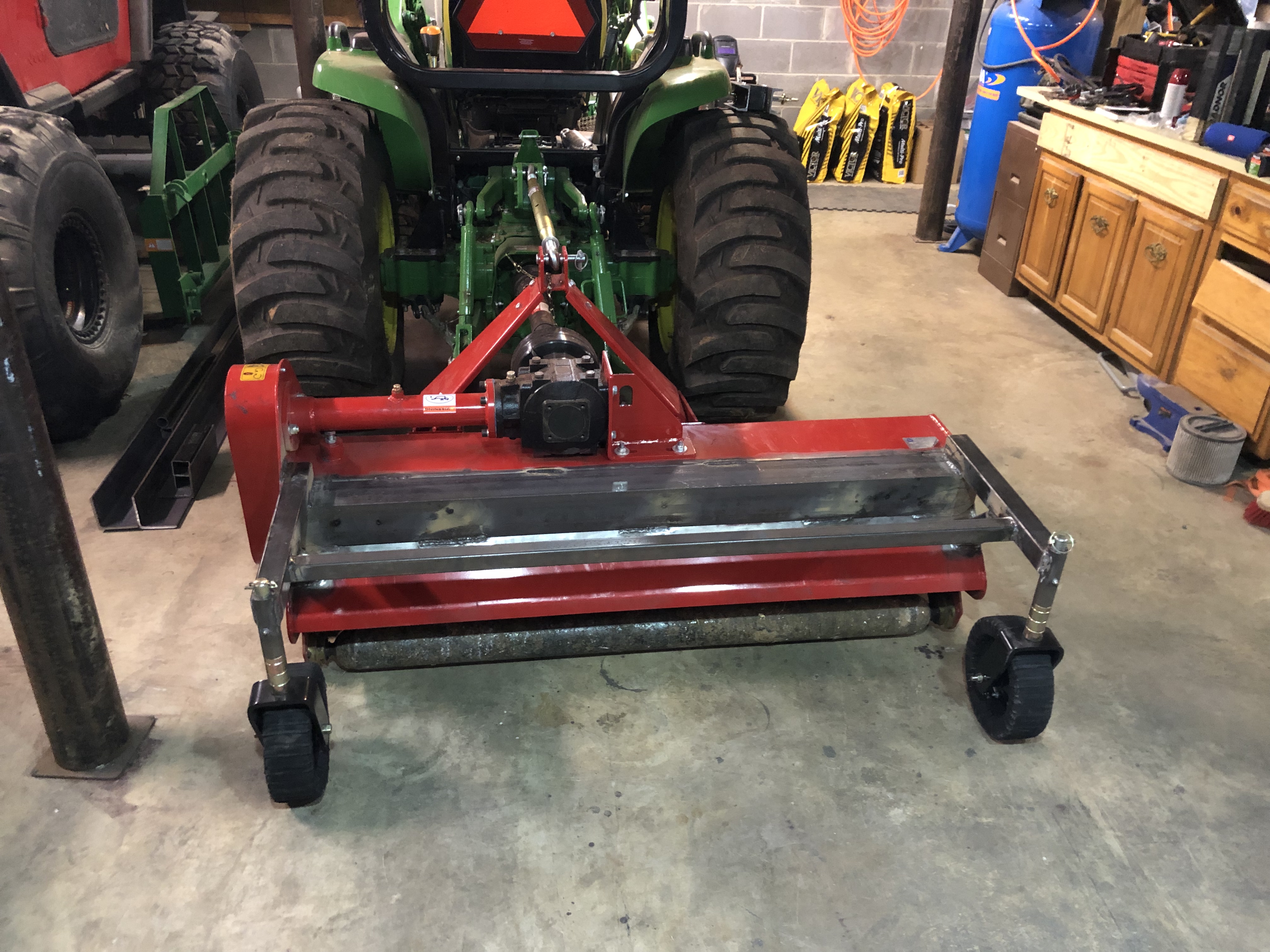

You guys are making me really worry about my recent purchase, I wish I would have seen this sooner! I purchased this less than a month ago and I have used it several times on my very steep and rocky property. I have hit a few big hidden rocks and cleared brush that was for sure pushing the 3" diameter mark, I have not damaged anything yet (that I know of) aside from a few chipped knives, but it looks like I need to be careful. On the hills that I am working on, I have accidentally jammed the mower into the ground on the downhill side a few times as the tractor started up another hill or off angle, the housing does not seem bent. Mostly when this happens it is the piece of metal that holds on the rear roller that digs in. I do think that Titan has changed their design somewhat because mine was delivered with the grease fittings for the rear roller on the outside of the housing, on the sides of the mower.
I may add a few pieces of 2x2x1/4 angle across the housing just in case to try to keep it from bending, but what are you guys doing about the 3-point top link supports breaking? Does anyone have pictures that they could share?

Hello Hawn10,
Just drive slowly for now and plan on having a complete weldment made by a fabrication shop or if you own a smoke wrench, grinder, welder etc. purchase some thick flat stock as wide as the mounting arms of the existing three point hitch on the mower at the end of the season to
replace the weaker steel.
The issue of reinforcing the rear of the mower will need to be addressed with a different method wherein you will end up using square stock with flat stock welded to it on all four sides of the square tube to create strength in the weldment.
The flat stock will create a tab on both ends and you will need to bolt it to the side weldments placing the tube weldment near the bottom of the flail mower shroud but not near the bend at the bottom of the flail mower shroud MAKING SURE that the bolt heads do not interfere with the flail mower knives orbit.
Cutting the flat stock weldments and drilling the mounting holes in the end weldment and the strap iron that crosses the flail mower shroud should be done before you weld them to the square tube stock and by doing so you can use vice grips to hold the weldment in place making sure it is level while you drill the first hole in the side weldment of the flail mower.
Doing all the welding off the flail mower prevents any chance that the flail mower rotor bearings become damaged by the amperage
of the welder when doing the work.
The other thing is that using a fine threaded bolt and nut with flat and lock washers should be a priority and using red Loctite to secure the cross brace weldment to the mowers side weldments and the flail mower shroud.
If you can rent a mag drill the drilling will be easier and you will have good holes that do not wander on the flat stock and you can mount the mag drill on the cross piece while its on the flail mower to drill through the flat stock and the flail mower shroud in one movement.
I would recommend that you use fluid film and the dewalt twin point drill bits sized for 3/8" bolts be sure to buy several of them so you have them on hand.
Of course if you do not have metal working tools the fab shop will be able to do this very quickly for you and all you would need to do is rent a mag drill.

Going slow is not a problem, I have to work around so many trees and hills that I would for sure tear something up if I moved too fast! That sounds like a good way to reinforce the back, I have all of the tools I need, and I have access to a mag drill as well. I never thought about putting a weldment on the inside in the back, I will have to check for clearance on that when I get home, but I think that there is room. I also just happen to have some flat bar and some DOM tubing laying around that I could use.

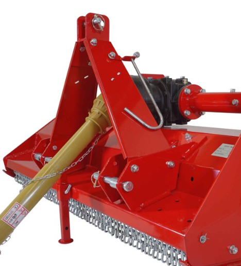

Guidshir,
How come you have both side supports bolted to the outside mount flanges? I believe you should have only had one support mounted to an outside flange depending on which offset position you chose upon assembly?
   / Titan Flail mower #69
Guidshir,
thekkfan, I had to do the same thing on my mower, I am not sure if he had the same problem as I did but on mine the formed angles on the brackets did not allow me to get the bolts in for any other position even thought the manual shows it as you are suggesting.
   / Titan Flail mower #70
This is from the titan site. I only say this because my BETSTCO had the same assembly and I had no trouble assembling the way I described. I wondered if that issue stressed the folds, especially if there was any side to side movement (ie. smacked side of a tree, etc).
