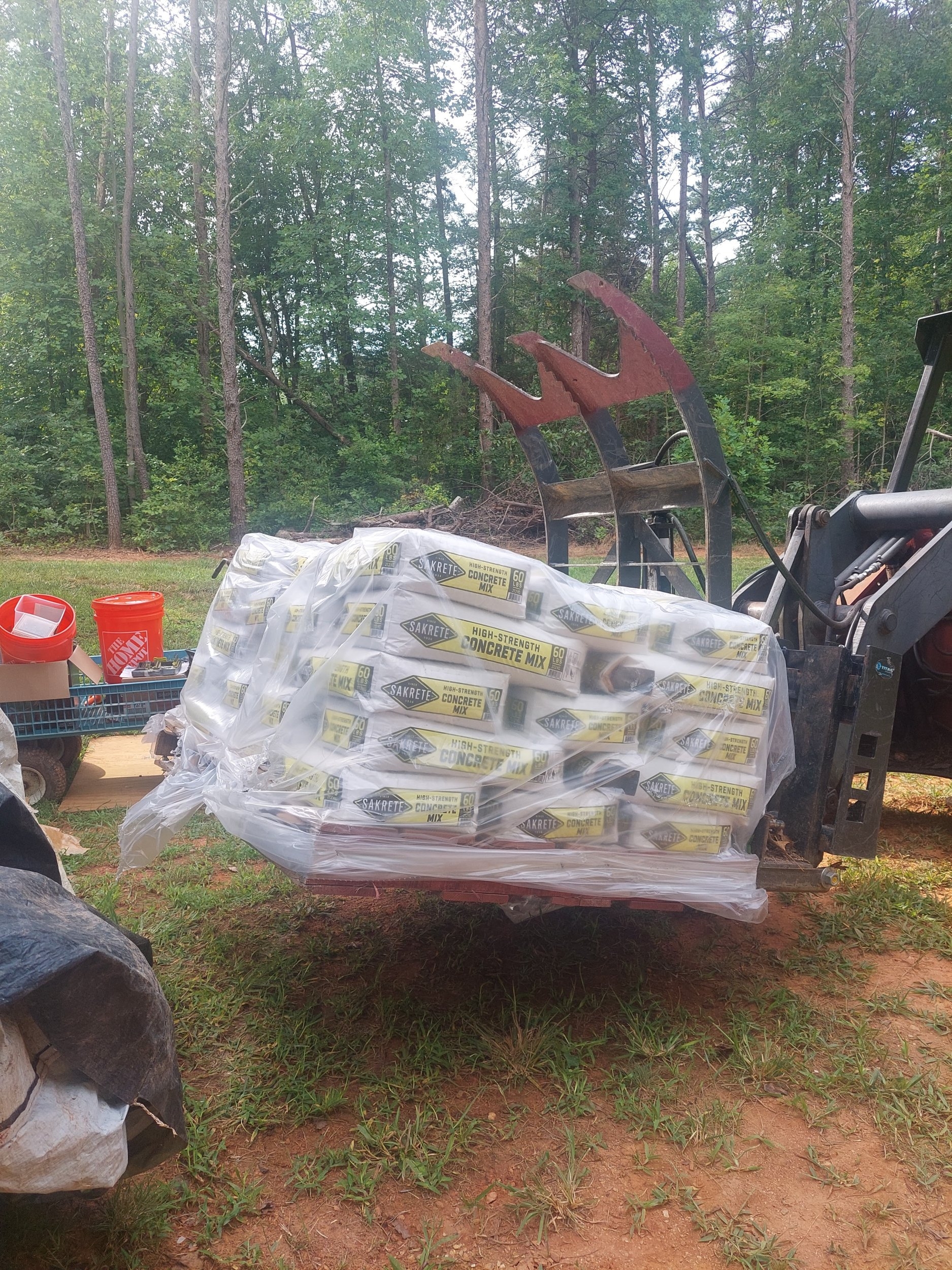

2many rocks: I did what you are talking about by attaching a PT plate directly to a fork attachment a few years ago. I thought I was done with the attachments I needed and now I am realizing that was a rookie mistake on my part. I am now wanting other attachments and can't use the adapter plate that I bought previously for any other new attachments I want since it is welded on the fork attachment.
I am now buying the 3 pt to SSQA adapter mentioned above and another PT1460 plate to make the PT to SSQA adapter plate I should have made the first time around. Seems the SSQA stuff is dropping in price and there are very good deals to be had on used SSQA attachments.
FWIW: I would comment that skid steers in general have much higher lift capacity the PowerTracs. I think that when making the adapter, one can easily lose a great deal of effective lifting capacity with an SSQA adapter that is a) heavy and/or b) deep. The latter pushes the load farther out and gets one into PT pucker territory sooner.

Here is the adapter plate attached directly to my SSQA fork implement. I have an add a grapple attachment that slips over the forks.
No problem with lifting capacity- hehe
