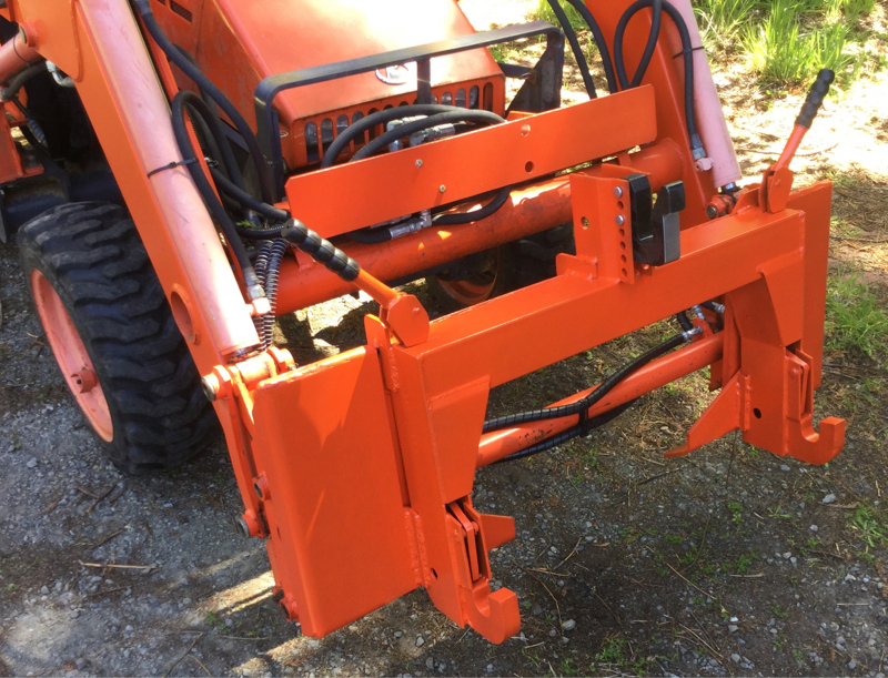

Several TBN folk have welded a HF quick hitch to a SSQA plate to get the same thing. It is very useful.
Did that for my snow plow mount. Was handy for moving impliments & rolling my flail over for maintenance. Was sad to see it go with the old tractor & plow. Have a spare SSQA plate, need to get another cheap QH & make another.
