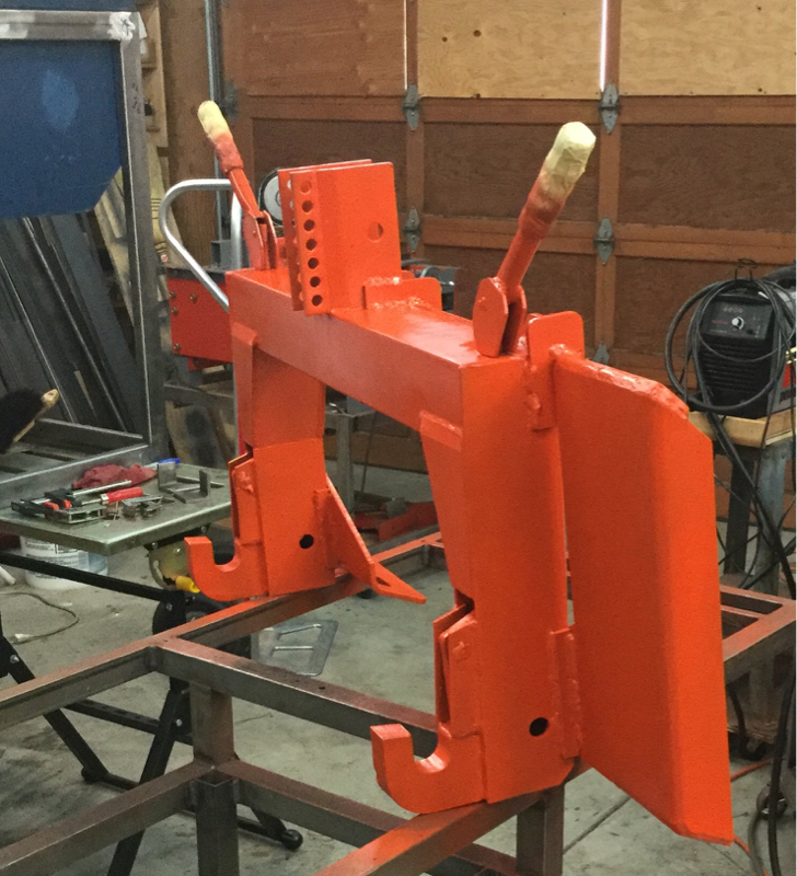

Several TBN folk have welded a HF quick hitch to a SSQA plate to get the same thing. It is very useful.
I have my Titan JD QA plate and my HF QH, now for the attachment. The top hook will be above the JD QA plate and there is nothing to weld the bracket too. The top link from your three point attaches to the top hook bracket and I am sure the engineers are relying on the top link to hold the weight not the two welds at the bottom of that bracket on the QH, so I would think additional supports need to be welded behind that top hook bracket to take the place of the missing top link. What do you guys think.
I see downsizingnow48 has some additional supports welded on his orange QH, but do you think that's enough.
I don't think I want to rely on those Harbor freight Welds to hold the top hook alone.
   / Titan QA to 3 PT hitch #17
Here is another view. You can see the top gussets, I call them hook gussets. Xfaxman I think was first to suggest this technique. They are very strong. There are four of them, two on each side of the hook and two at the ends of the HF QA. I have used the welded attachment a lot for some time now, no issues.

Thanks for the additional pic Pat.
