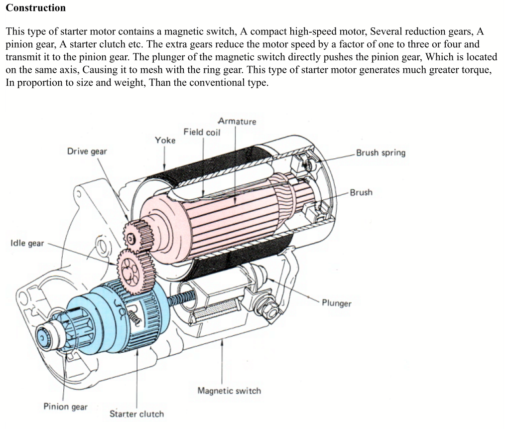

I made mention to test the old solenoid type start for load. Best to replace it with the modern OSGR starter, they draw less power and crank over better.
Here is what a modern OSGR starter is all about.
And the best part is, OSGR last longer and are 2/3rds the price of a solenoid type. Check this out!
Your Yanmar OE p/n is 124250-77012
