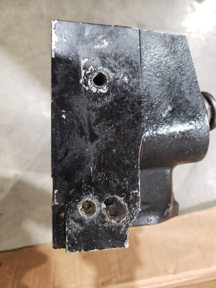

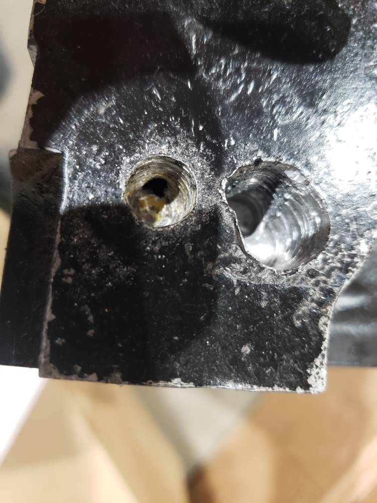

Had a little insomnia so figured I'd get a head start repairing an aluminum cylinder head from a 390FE that was dropped off yesterday.
Apparently someone stripped the accessory hole, messed it up worse trying to re-drill it so figured they would drill a new one, right into the water jacket. 20201020_003627.jpeg20201020_005315.jpeg

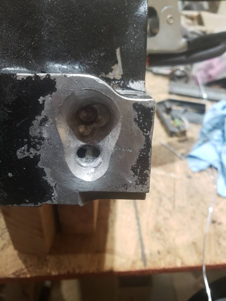

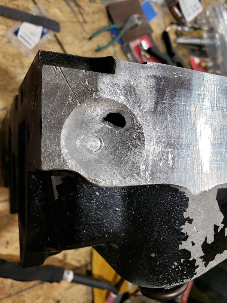

Had grind it out to get enough access to fill in the hole with weld.20201020_022041.jpeg

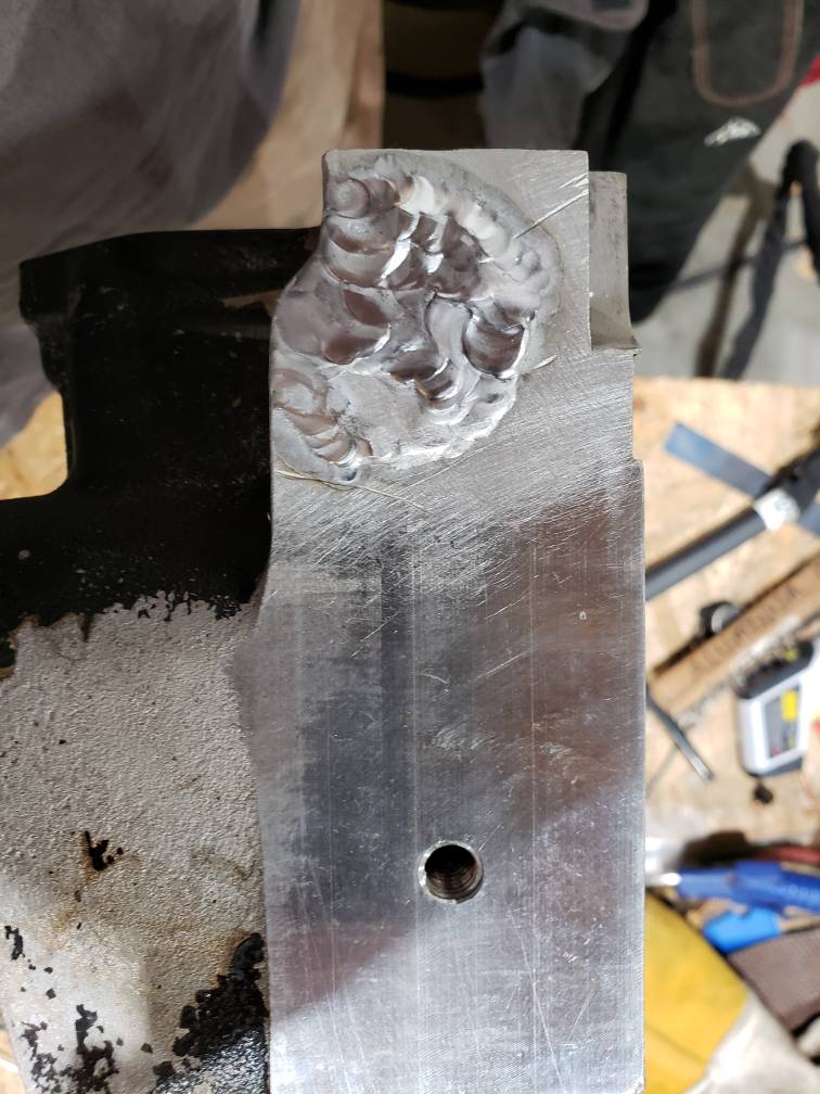

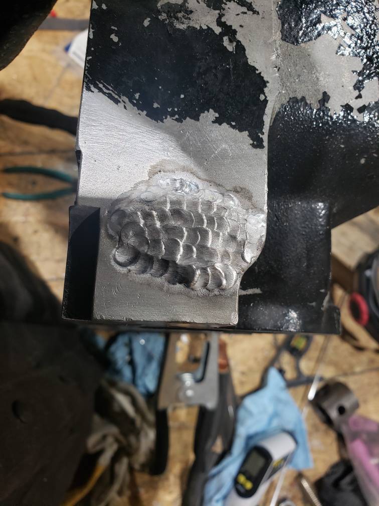

Took a couple hrs but finally got it built up, not pretty but doesn't have to be.
These large aluminum heads really suck the heat out of the weld area, had the Dynasty turned up all the way (280A), really wish I had a 350 for these jobs.20201020_041754.jpeg
Later today I should have the machine work done if everything goes well.

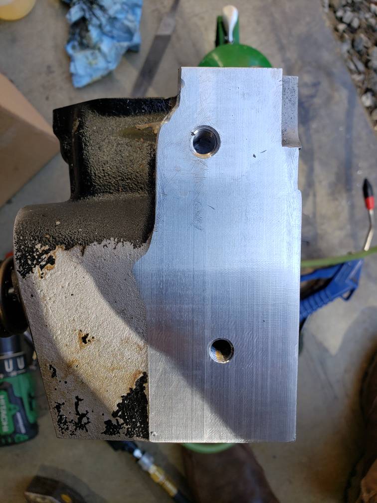

Well round one had a small leak when I pressure tested it , small area where the tap cut into what appeared to be an inclusion. Ended up fixing it the next day.
Ignore the un-pretty weld, it was getting machined off anyways, and after almost 2hrs of straight welding @280a I didn't really care!20201021_011648.jpeg
All machined, I put a helicoil in it since I've had bad experiences threading straight into a weld buildup.20201021_115615.jpeg
At least all the machining setup was still ready to go

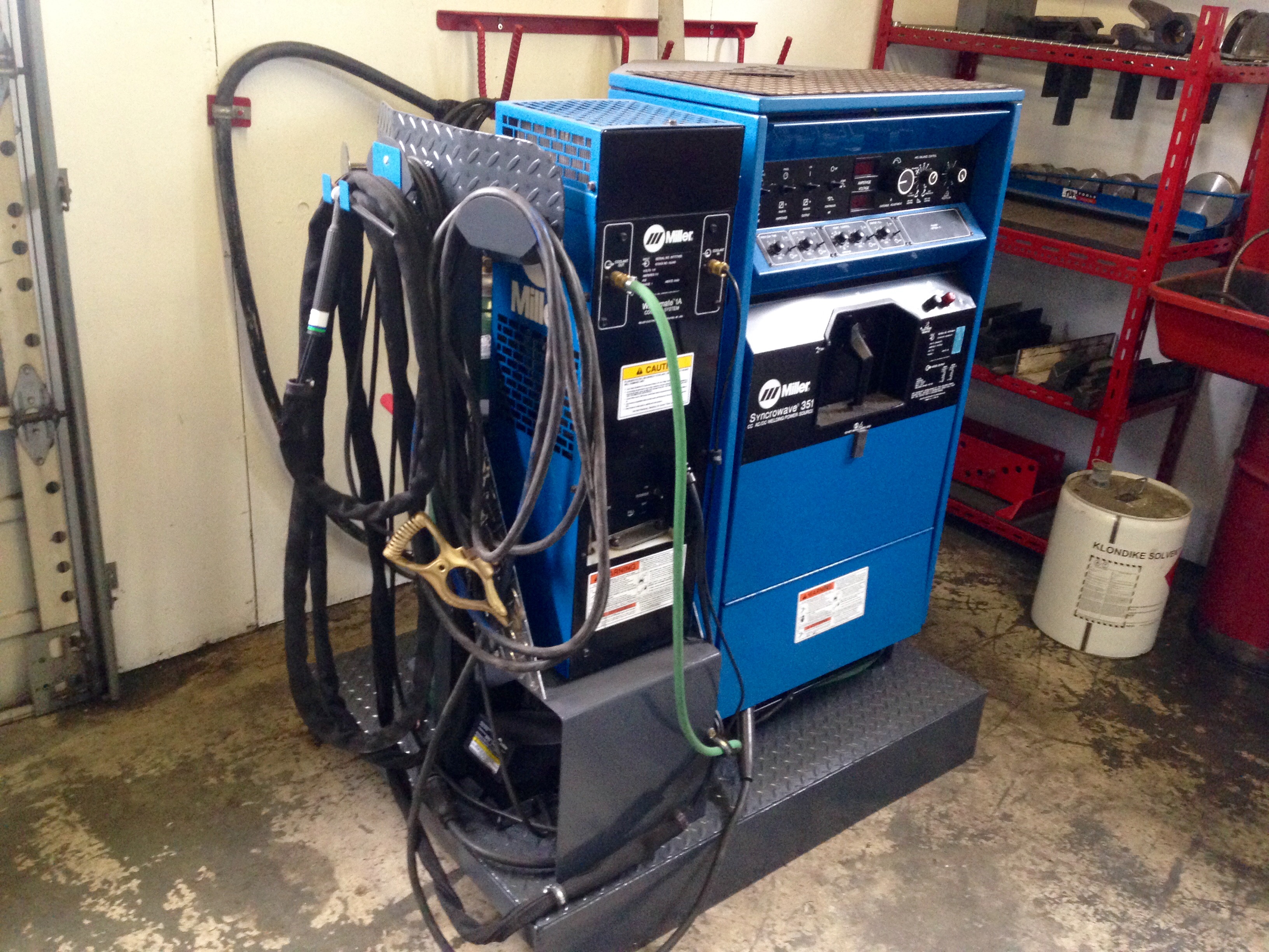

If I do much more of these I'll need a bigger welder.
   / TMGT's shop build #149
I know right! I'm pretty good at fooling people sometimes
Should have bought mine
   / TMGT's shop build
#150
Na, I don't have all that space you do for that monstrosity! Besides I'd have to hardwire it in, whats the input requirements, 100a breaker?
I like my little compact inverter that can run a 3/32 sharpened tunsten at 280a and still be pointed when I'm done!
