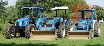

The biggest difference is size. The TL is a tad bigger then a TN and as a result can do more work then the like hp TN. It all comes down to what you want to do. Around here the small vegetable farms run TL's while everyone else uses a TN.
So it depends on what you want to do with your tractor and if you need the extra size and weight of the TL. New Holland has been great in the fact they have a tractor to fit almost every operation you can think of.
   / TN vs TL
From the spec sheet the physical dimensions aren't significantly different. So, as I understand it theres no advantage there. The weight is though but to spend x% more just for weight alone seems unwise as weights can be added. Well, maybe its cheaper to buy a heavier tractor than add weight...I dont know.
   / TN vs TL #4
The TL is a flat deck tractor. The seat is higher, cab or platform is unobstructed and larger. Visibility is much better, cab is roomier. TL deluxe has better hydraulic capabilities than any TN. 4 cylinder naturally aspirated engine may have more low end grunt than a turboed three. I expect the TL to have a stronger 3pt spec. 52LC loader that the TL can accomodate has more lift than the 32LC which fits both. If I were buying a 70-80 engine HP tractor and was going to spend LONG days in it, the TL would be an easy choice. Power Shuttle option is a must have on either series IMHO, TL also has a HI-LO on Deluxe models.

There is a lot of difference in size between the two. The specs don't make it sound like much but here is a pic to help you compare.
The TL-100A is on the left, TN65 is center and Ford 1920 is to the right. There is a lot more to the TL then specs say and you notice the difference on a NH 575 baler. Rick explained most of the noticable differences and unless you have a chance to run both a TL and a TN it is hard to understand the differences.

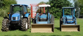

Here is more of a head on shot

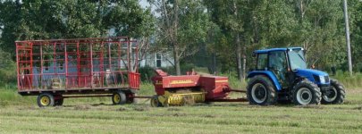

Last one is hooked to my baler. You can see that the cab is kind of on the short side. It isn't a problem as there is more then enough head room but for some reason it bothered me.

That was a fun day, I don't know if you can see it but there is mud covering almost all of the tires. I had to unhook the wagon a couple times to get the baler unstuck even with the TL. That field was a friend of mine and his JD baler broke down so I was called in to help. I don't remember how many wagons we did that day but it was fun dodging the mud holes. /forums/images/graemlins/crazy.gif
