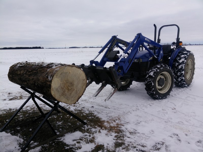

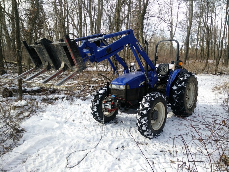

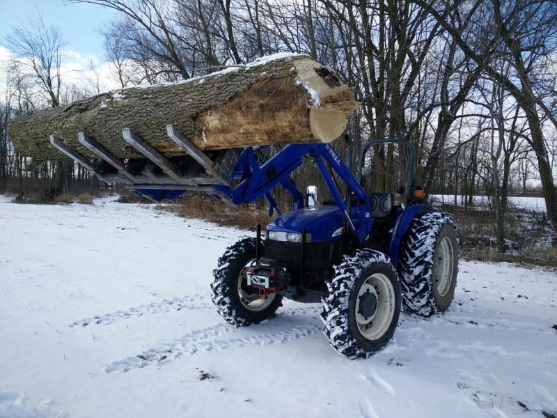

Hi Guys and thanks for your feedback.
As I previously mentioned, I do not intend to use this winch regularly. My primary skidding will be done from the rear. In fact one of the reasons I want to mount it to the front of the tractor is so it is out of the way and it minimizes my handling of it on the 3PTH when changing attachments. (it is pretty heavy too) I realize all the drawbacks and potential dangers (I will monitor motor temp etc.) to using it but it will be for those farther away had to get at logs. It is convenient to have a wireless remote as I can walk along with it and watch for hang ups. Also, I do have a snatch block as a back plan in case I am really stuck. :)
   / TN75 Front mount winch
#24
Good Day all,
So I finally got my winch installed and operating on my TN75. It works great, and FYI I just use it occasionally to pull out the far away and hard to get at log. Even then, I don't do a constant pull. This NH model has a Power shift which means I can forward/reverse without clutching. So my question is when I am winching, is it safe if the engine is turned off with the tractor in gear, will the engine act as a brake? Not that I will do this as I will not have battery charging on, (yes I do increase the throttle a bit) but the odd time it might be a slight pull when I am tree trimming while the engine is off?
IMG_20210202_142209_800x600.jpgIMG_20210127_125107_800x600.jpgIMG_20210130_131331_800x600.jpg
   / TN75 Front mount winch #25
Nope I really doubt it will hold back;
an easy way to find out, stop on a gentle slope, shut the engine down and release the brake pedal,
see if she starts to roll.
