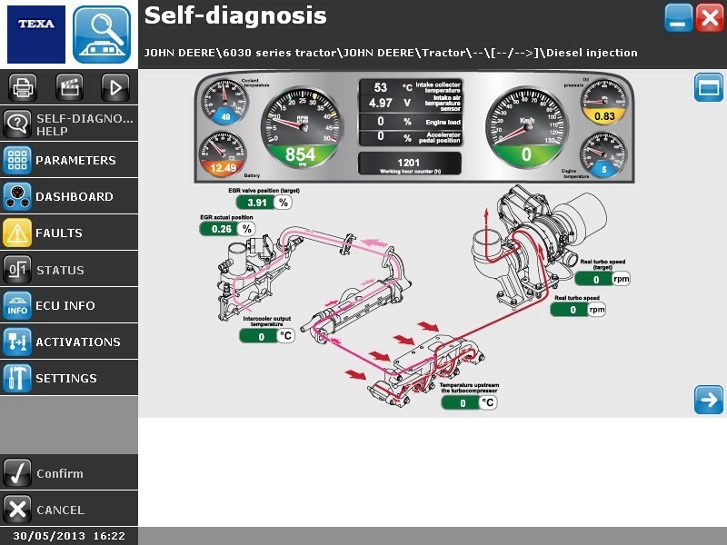

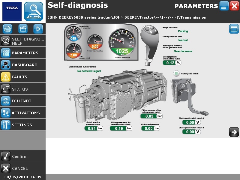

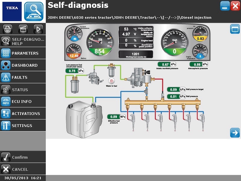

Check with a non NH dealer, the machine many of them use is not brand specific, the only difference is the cable used to connect to the tractor. Here's a link to an analyzer and the prices of various different cables:
Tractor, Combine diagnostic tool
Here's a couple of screen shots from a a Deere tractor.
