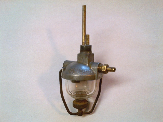

TO-30 fuel sediment bowl (TO-9165) - need new valve stem and seals

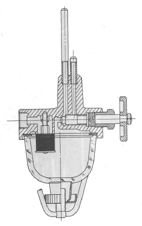

Was cleaning this thing up and in the process of reading the manual, I realized the square portion of the valve stem and the knob that goes on there are gone. So I put the end of the stem in the vise and unscrewed it from the casting. The seals are looking pretty crumbly. And obviously the stem is not all there. Any hope of finding these as replacement parts? The die cast housing has TO-9165 cast into it and "HF" in a rectangle with chamfered corners (assuming this is a Harry Ferguson logo).

Isn't there a screen that stands up inside the tank that acts as a fuel filter? You can still buy this entire cutoff valve new and looks just like yours. The short tube is the reserve I believe when you open the valve all the way. I just put one of those on my 135. Bought it on eBay. -kid

Finding an original may be a tough task. mine has rubber gasket.
   / TO-30 fuel sediment bowl (TO-9165) - need new valve stem and seals
I figured it'd be a long shot being so old (mine had the rubber gasket too). In the meantime, I rigged up an inline shutoff and filter. The piece of hardline I had purchased was a 20" length, which got it about half way under the battery. I just bent it gently by hand (one jog to avoid the exhaust elbow and then a 90-degree bend to go under the battery). I also completely drained the gas tank this afternoon before I put it back on. Used a coffee filter in a funnel and caught some little bits of junk, but the real kicker was the dead stink bug that came out of there!
