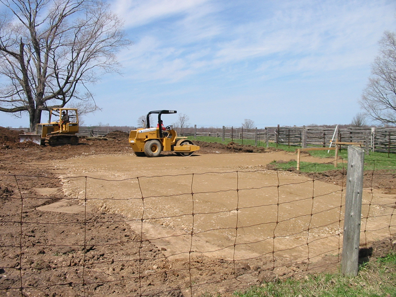

We rented a compactor for a few days. They cost less than you think to rent and anyone can drive it back and forth over your fill.

Thanks for the picture
