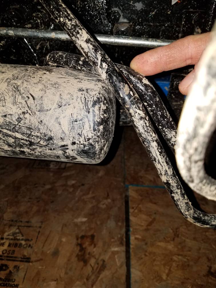

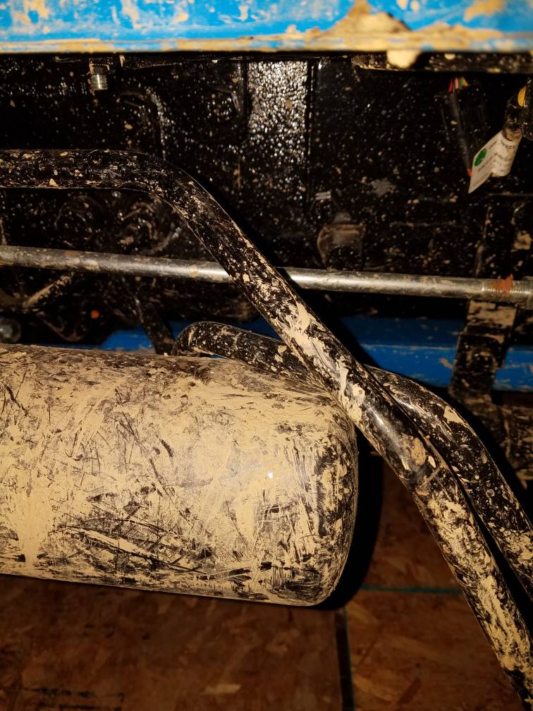

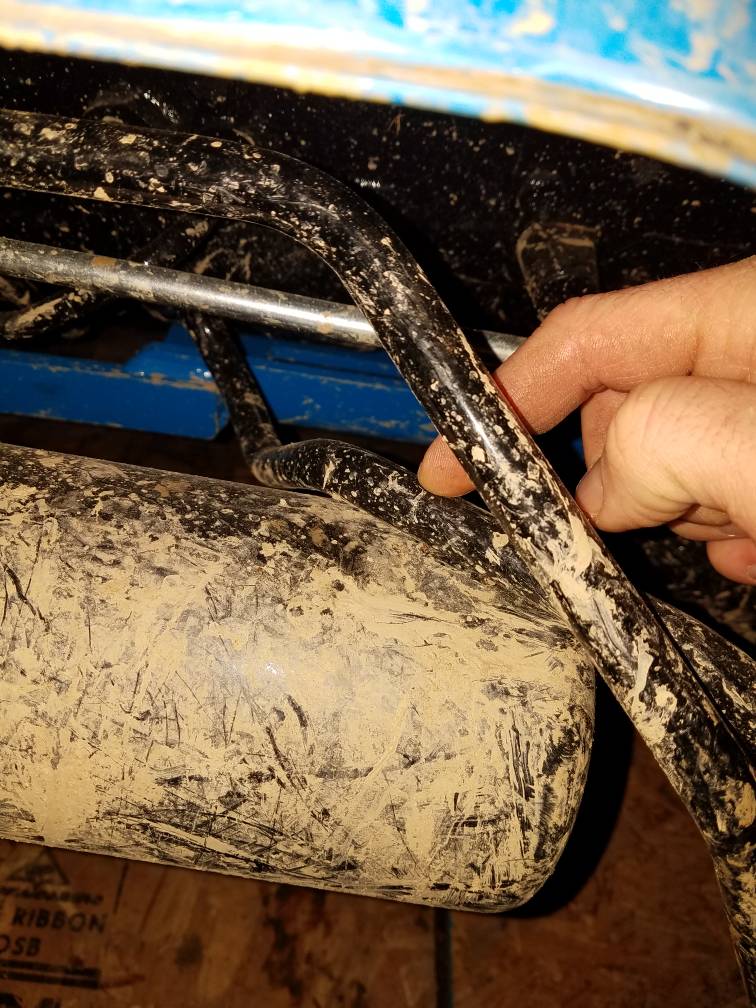

So I was looking over the tractor and noticed that the one hard plumbed line just above the filter was pressing on it. Is anyone else having the same problem? I mean it isn't a problem yet but I have to believe the 2 are rubbing and vibrating against each other meaning a hole might develop most likely in the filter first.

Just an update, I got a hold of someone at LS. They weren't aware of the issue and suggested I take it back to the dealer to have the dealer reposition the line. Being the hard plumbed line with the banjo fittings there won't be any repositioning the line. They can't seem to find my S/N in their system, I might have given them the wrong one I'm not sure which number they were looking for. Anyway I'm happy to say they are at least responding promptly to my emails and will reaching out to the regional manager to see if they have found the issue with other tractors. By what my dealer had mentioned it sounds like the 25hp, 30hp, and 35hp MT2 models all have the same issue.
   / To all mt235e owners

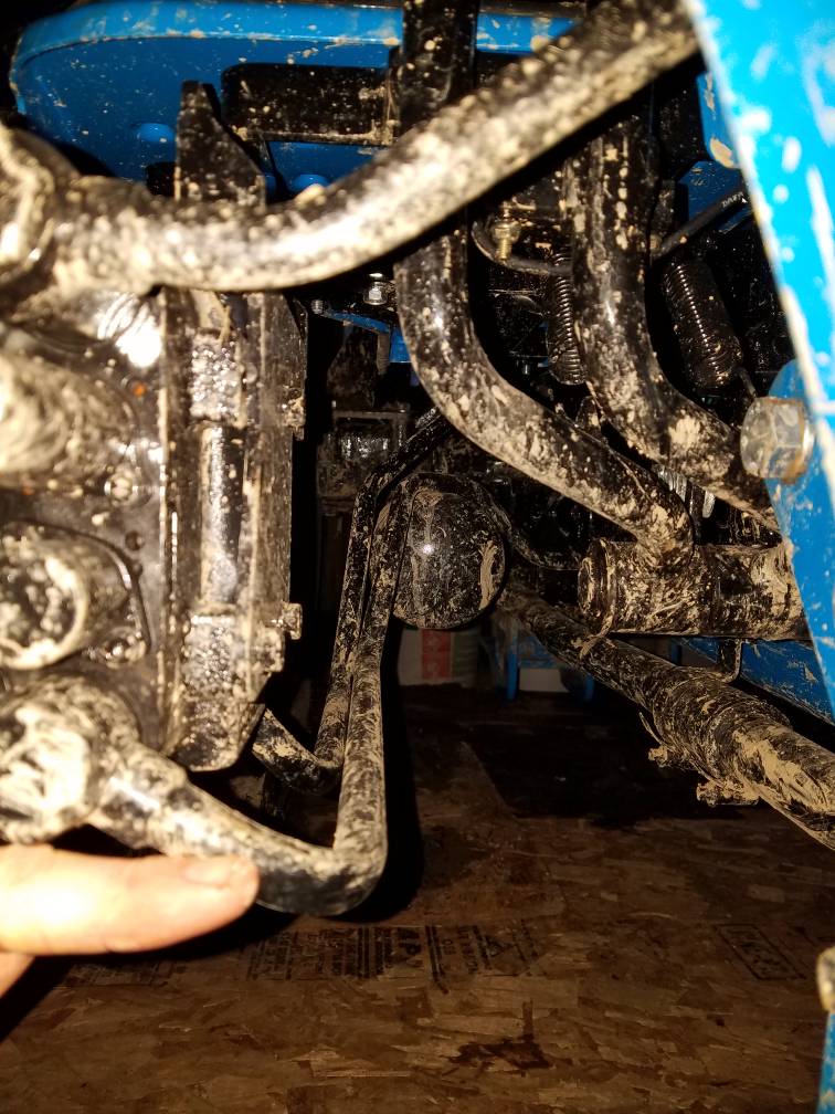

Here are some pictures of the line. It is hard to tell but it might actually be denting the filter. 20200211_173927.jpg20200211_173948.jpg20200211_173917.jpg20200211_173817.jpg

Is that the HST or hydraulic filter? I have the gear version, the lines are no where near my filter can.
