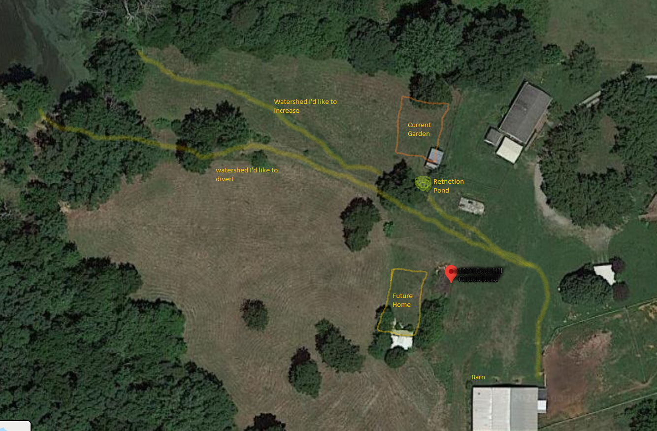

You say retention pond, for run run off only, or are you planning on it holding water year around? A 20 foot by 20 foot pond isn’t going to hold much, especially if there is much of a water shed area. As for will the tractor unit do the job, Yes it would but not quickly. A small excavator and dozer would make quick work of that job.

The primary purpose of the retention pond is aesthetics more than anything else. I would like it to hold water year round. We have a large pond at the bottom of the property where the majority of the water ends up. What my ultimate goal is, is to direct the largest amounts of water to dedicated areas and minimize erosion. If you can look at the picture I posted in my original post, the upper line is where I'd like the lower line to go. That's going to take a lot more dirt moving than a TLB. The area closest to the barn where the line is, I want to trench and put in pipe and continue that down to where the pond will be. The pond will have a spillway into another pipe that lets out to a ditch that leads to the pond at the far left of the pic. The lower line is what I want to divert over to the upper line because where the lower line is, is where we primarily travel to and from the pond. In my mind, it seems like the least invasive way to maintain what we have and not have watershed ruts in multiple places. I may be way off, but it's what I am thinking. Watershed Lines.png
