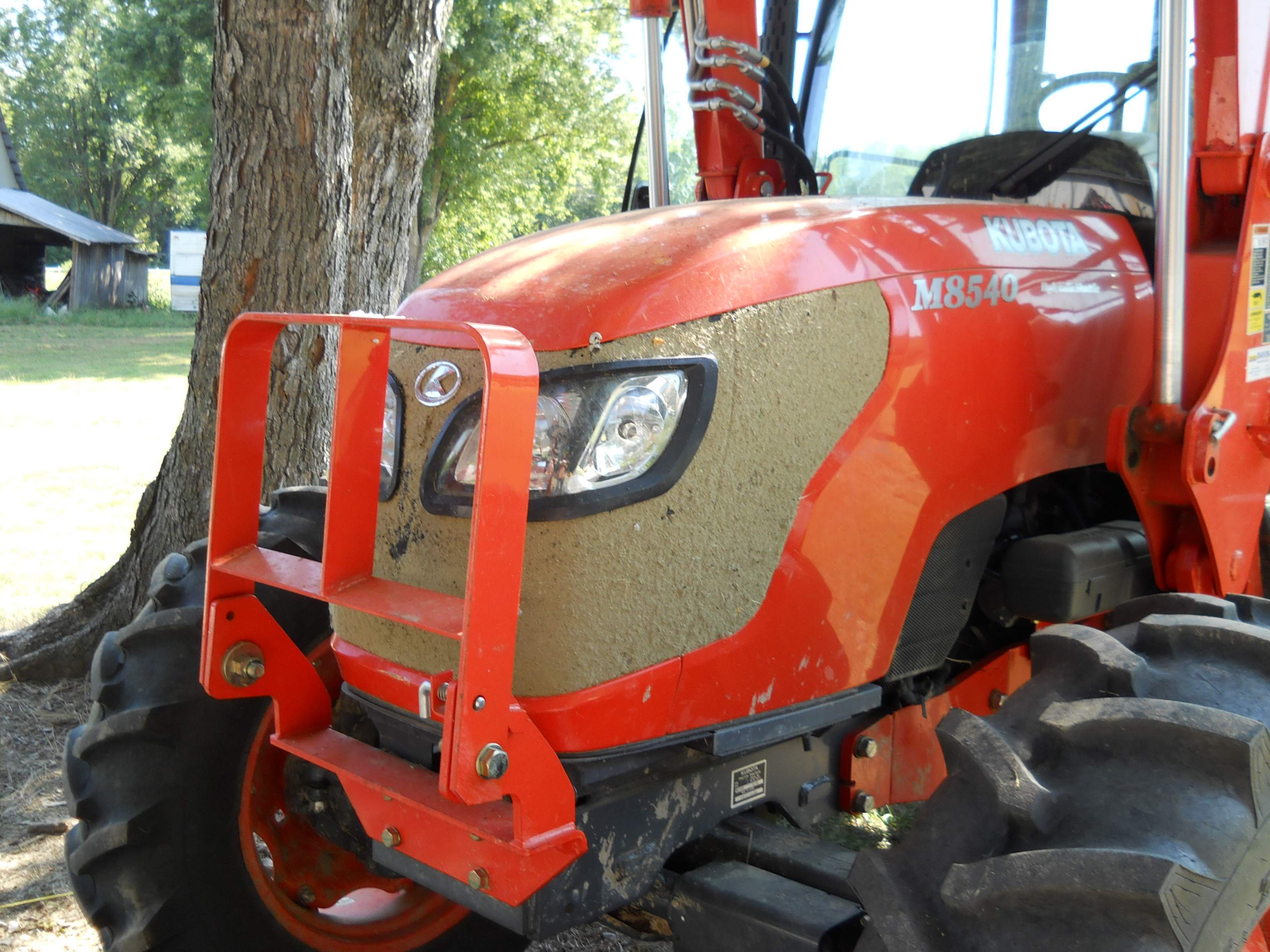

One thing to note about bush hogging this time of year, is that there's lots of weeds and grasses with mature seeds still hanging on the stalk. They easily shake loose when you hit them with the grill guard and then get vacuumed into the radiator and screen by the cooling fan. The screen and the radiator always need periodic maintenance when mowing, but much more frequent cleaning is needed when there's mature seeds around. So, keep an eye on the temp gauge, keep the radiator cleaned out and go to town.

I know what your talking about. When I mowed the front 10 acres I had to stop every couple hours and blow the stuff off the front of the radiator. At first I couldn't figure out why my temp was going up, so I stopped, checked the radiator and found a heavy layer of debris on the front of the radiator. Great tip for other "new to tractoring" members.

I carry a brush in my tractor as well as a leaf blower in my truck if I'm too far from the shop.
