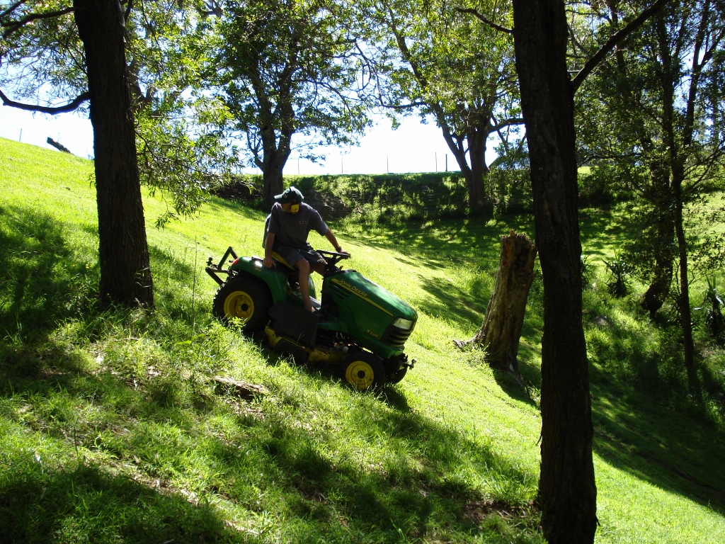

And I was in a similar position, anyhow here is a JD X595 with HDAP tires mowing what I would call a fairly steep slope.
This machine has the optional rear PTO and 3PL and ran up the same hill with a 3 foot bush hog to clear the rough stuff.
Personally I would be hesitant to take a B6100 or similar down a hill like that (but I have done it!)
good luck and stay safeView attachment 317002
Not a problem for a 4x4 595 or 700 series mower but a little over budget from what I understand. I looked for a year or better for a deal on a 595 and finally gave up and bought a new x749. Great for slopes and tight quarters work.

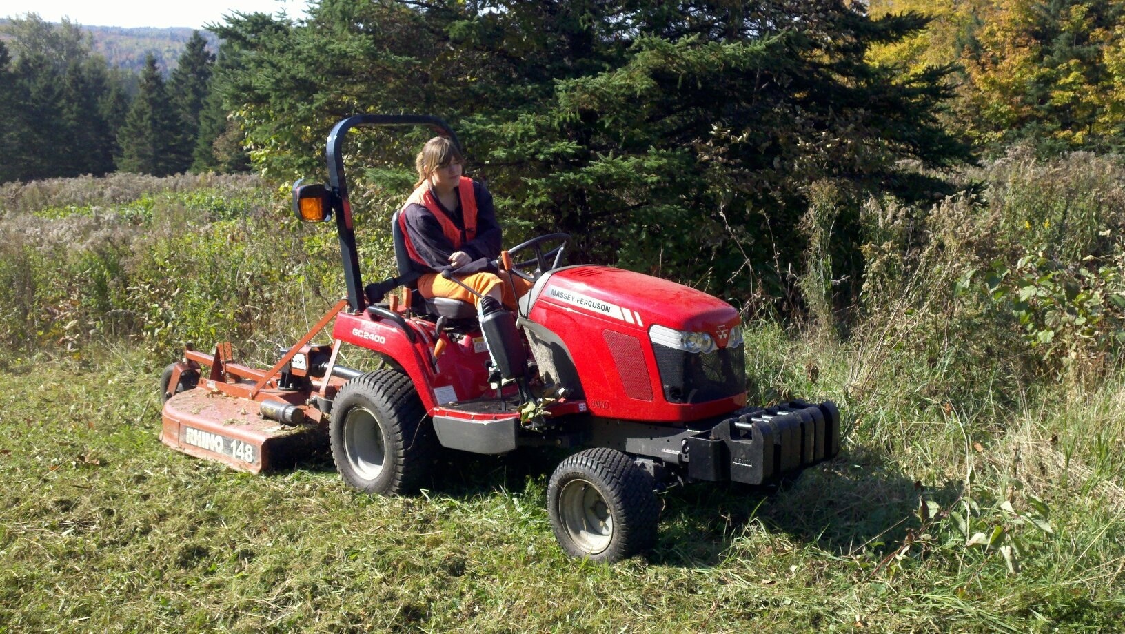

CLICK ON PICTURE. It's my 15 year old daughter using it.
I mow about 25 acres on my Dads old farm, lots of hills, bushes and long grass. If the photo of my tractor worked, it's a Massy Ferguson GC2400 sub compact. 22.5 hp with a 5 foot belly lawn mower and a 4 foot Rhino bush cutter. This will be my 4th year cutting his farm, I used to have a 35 hp Massy Ferguson compact tractor because I used to own a place with 30 acres I kept clear besides my Dads farm. After trading down to the subcompact I wished I had never bought the bigger one. The scut is much easier to use and get around the the trees. I live in Northern Maine and have a front snowblower also.
I picked the Massy because the engine was smooth and quiet, and the dealer was closer to home. I would say pick a sub compact from a dealer close by. It's very stable on the hills, I have turf tires and 6 40 pound weights on the front, in the winter the turf tires still work great and I move the weights to the back. I like turf tires, they don't tear up your lawn.
