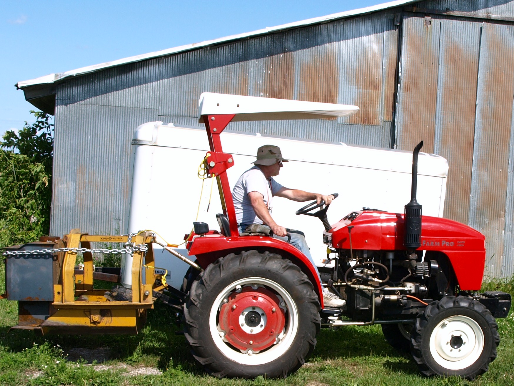

Bob, I have a 2005 Farm Pro 2425, (same as a Jimna). I bought it used with about 40 hours on it. I now have about 80 hours on it. Most of the implements I have for it are at least one size larger than I would expect would be ideal, but in spite of that it seems to pull them all without even breathing hard. I have a 5 foot brush hog, a 6 foot tiller, a 7 foot back blade, a 5 foot box blade, a 30 inch dirt scoop a 1500 lb lawn roller along with a sub soil chisel plow and a middle buster. I have loaded the dirt scoop with 800 lb of bags of cement to move them and the tractor lifted it with ease. The scoop itself weighs a couple hundred pounds. I have not found anything this little tractor can't do yet. Pulling the dirt scoop in hard clay did require me to put it in 4 wheel drive because the rear wheels started to spin, but they are not loaded, and once the front wheels started helping the rear quit spinning. The 2 things I find fault with on this tractor is the brakes. They are weak, and the floor boards are a little cramped if you have large boots (size 11). But for what I paid for it, I can live with that. My tractor has no major leaks. The power steering is wonderful (Ihave many hours on a ford 8n with a loader, and manual steering so the [power steering is a big plus for me. Long term I don't know, this little tractor seems to have a lot of metal in it and it seems happy to do whatever I want to do with it.
