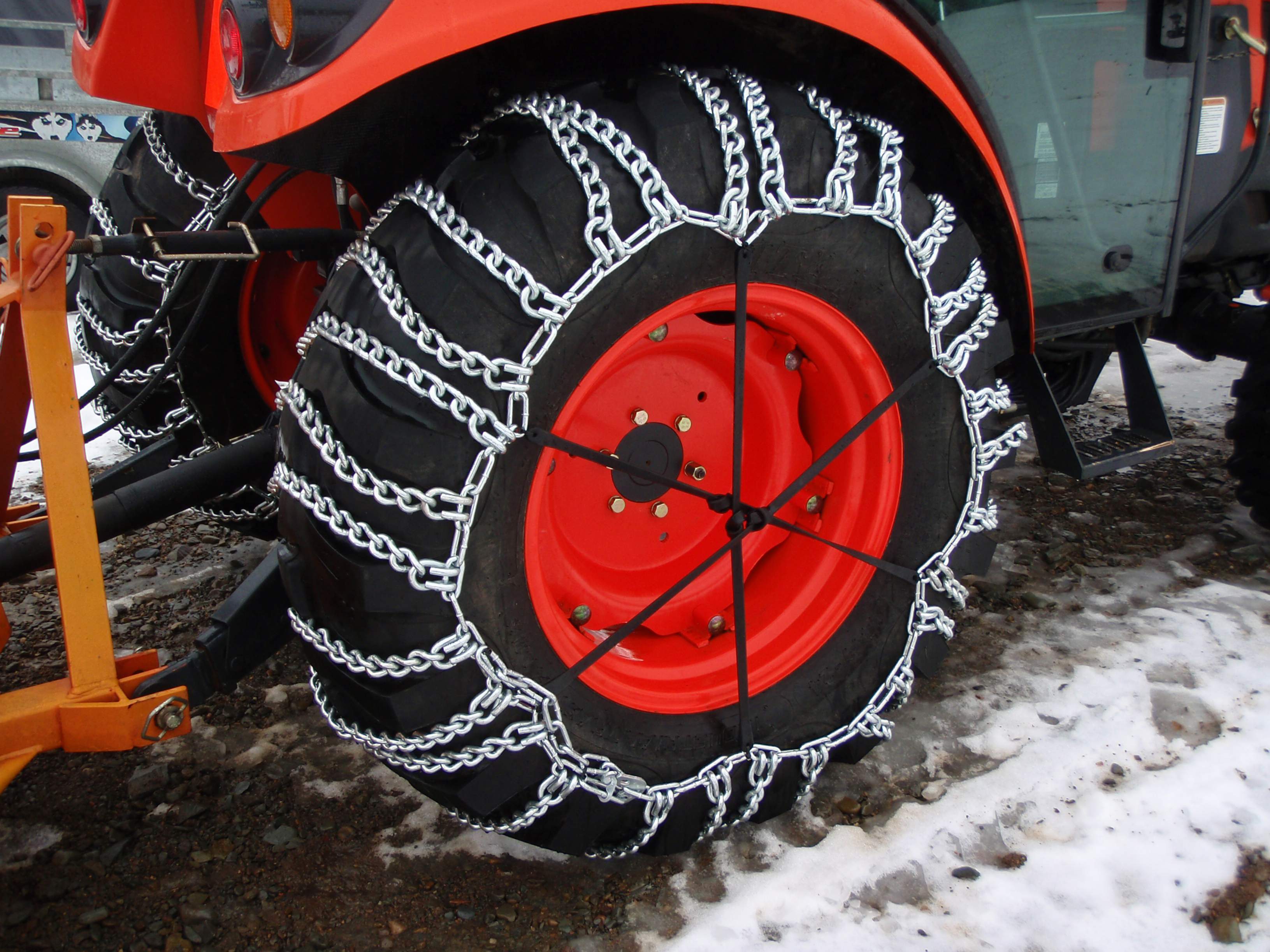

For the past 15 years I've been plowing with a rear blade on my Ford 9N and more recently a '54 NAA. In the beginning I tried it without chains and found that anytime there was an icy base to the snow, despite 800lbs of iron weghts I would just spin. Worse, when it was icy I would slide all the way down my driveway with both wheels locked. I've learned the hardway that chains are a must. I also use a 38" walk-behind blower and have always had chains on its tires.
I'm fast forwarding 50+ years and just bought a JD 2720 with a 54" front-mounted blower. I told the dealer I intended to run rear chains on the R4 tires and they said I won't need them with 4WD. I'm pretty sure that the 4WD will not help me stop when it's icy. :) It is my intention to run loaded rear tires and chains.

I went through the same debate myself and eventually ordered and installed Dual Ladder chains on the R4 rears of my DK40. They only stayed on the tractor for 1 day. The ride on pavement was unbearable with severe vibration. Traction with the chains was excellent. I would have chains on if I was only clearing my drive and didn't travel on the road. My dual ladder chains are for sale, like new, only used once. :thumbsup:
   / To chain or not to chain? #35
Are your tires at the maximum pressure? 35 psi?!?
I usually keep my rear tire in the surrounding of 25 psi during winter time, lugs are level with cement floor. They do allow smoother ride with chain. I tried many configurations, with and without chain with my front snow blower. But without chain I cannot do a proper job. If I could, I sure would do without.
Have you tried those chains? 7mm Trygg / very light / They do offer a less bumpy ride. As they offer continues contact with road, they don't kick your butt as your work. They are in a class by themself.:thumbsup:
