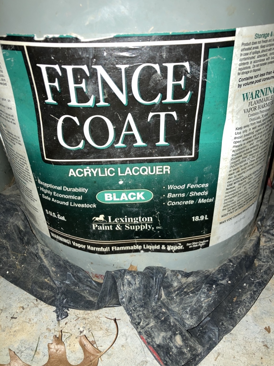

The fence paint that I bought and never used is specifically marketed for painting fences. I'd be surprised if it causes fences to rot.
I'm not aware of any prep work for painting a fence, but perhaps a local fence company would be nice enough to share insights?
