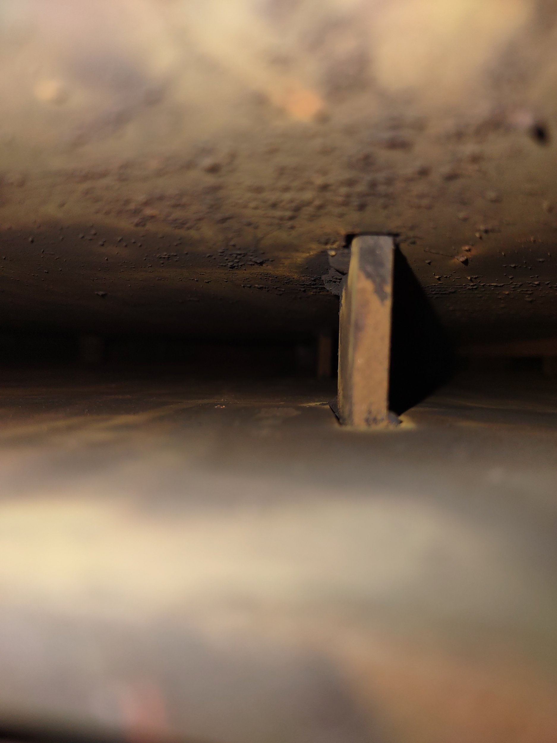

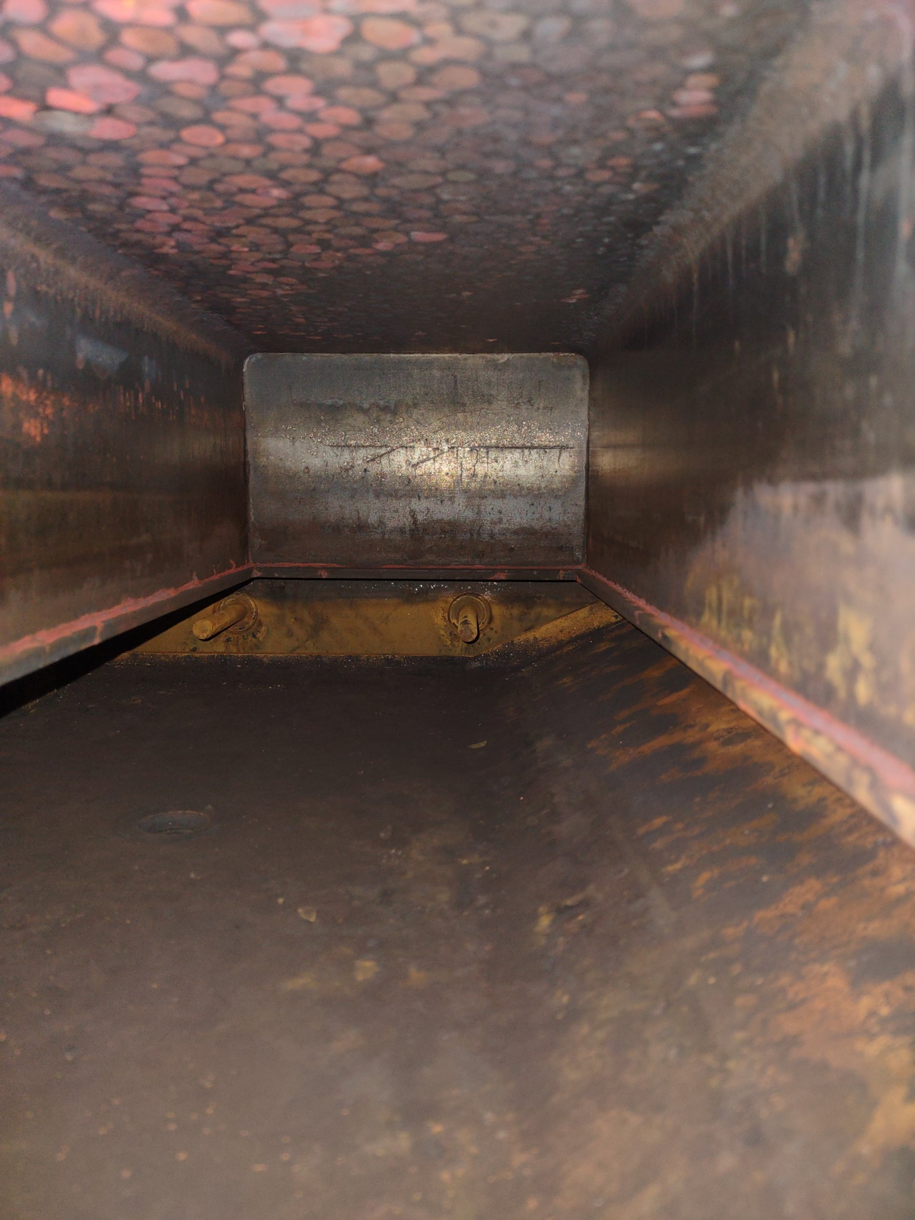

Pulled out the DHW (Domestic Hot Water) coil to look at the inside of the vessel last night, this is looking across above the top of the firebox, the two cylinders on the far side are thermowells:
Looking down the sidewall of the firebox from the DHW opening:
Looking over and toward the back/chimney from the DHW opening
The DHW coil
All in all, it looks pretty clean inside, I think the leaks are just from the welds cracking.

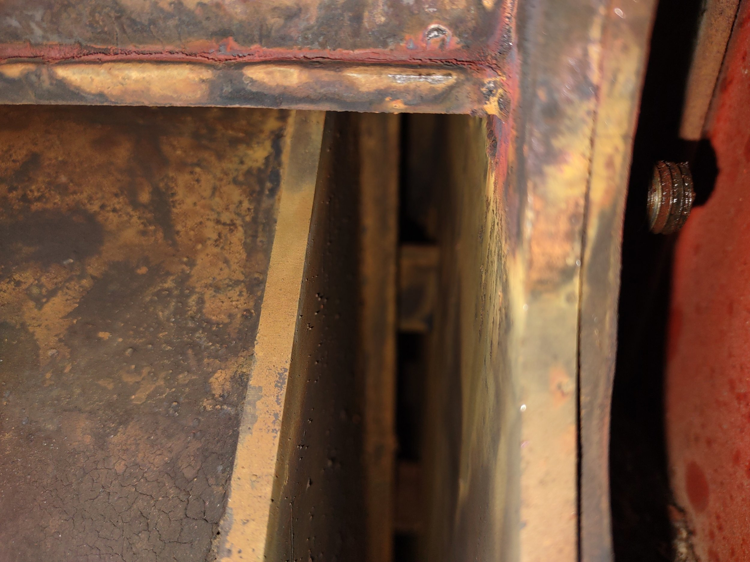

Looking at this picture and discussing the boiler with the "old timers" at work:
We are thinking that the root cause of the cracks is stress risers coming off of the corners of the square holes punched in the walls that the stays go through.
My plan is to clean up all the points where the risers are welded in, drill all 4 corners with a 3/16" drill bit and weld around each one.
If it works, great. If not, it will either get migrated to the scrapyard, or make a trip to MI (if @5030 still wants it at that point)
Related to heat cycling, these are all in the bottom half of the firebox where it would change temperature more when the boiler cycles on and off as the "flame" goes down to get to the exhaust.
