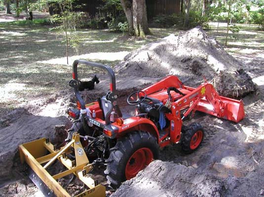

Actually, a heavy duty W.R. Long toothbar on our L-3130 with LA723 FEL DOES help dig out trees the hard way, this is just one of many! /forums/images/graemlins/grin.gif

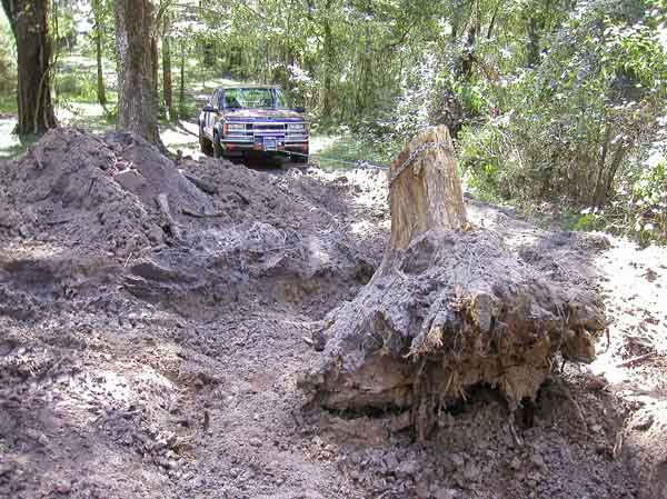

I dug this one out completely with the Toothbar on the FEL, but it weighed about three tons so even the tractor was incapable of finally removing it, required a 15,000 pound winch.... /forums/images/graemlins/blush.gif
