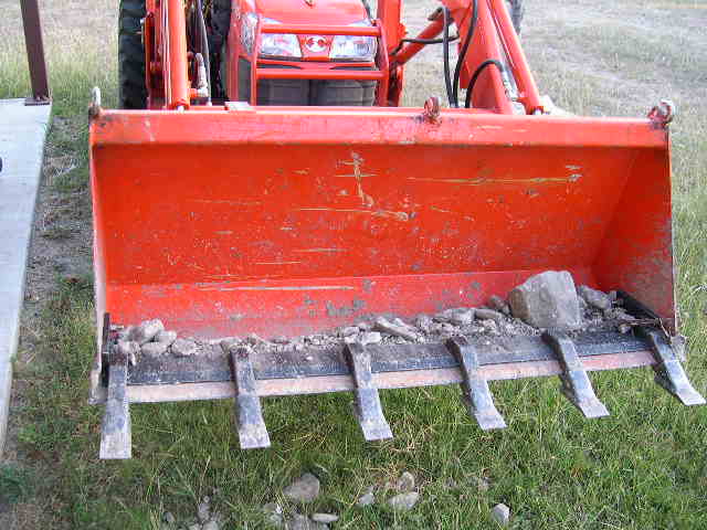

I have a Markham and thinks it's a must for the FEL....
Got some pictures of it here on page 1...................

or pict on a b3030. i highly recommend also.........
