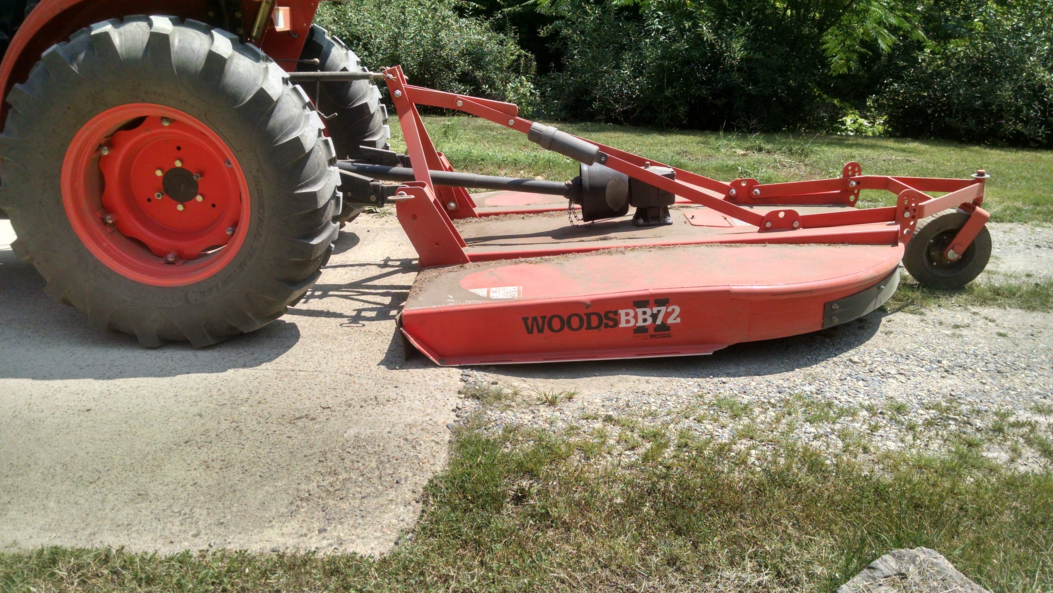

Guys,
This is my how my setup looks right now. I tried to drop it ahead of a storm last week and it was tight as a tick and I did not have the tool to loosen the top link so I just parked it.
Does this look right? is this how I should run it?
One pic is down all the way, the other is up all the way.
It looks wrong to me.
Very interested in your thoughts and advice.
Be well,
David

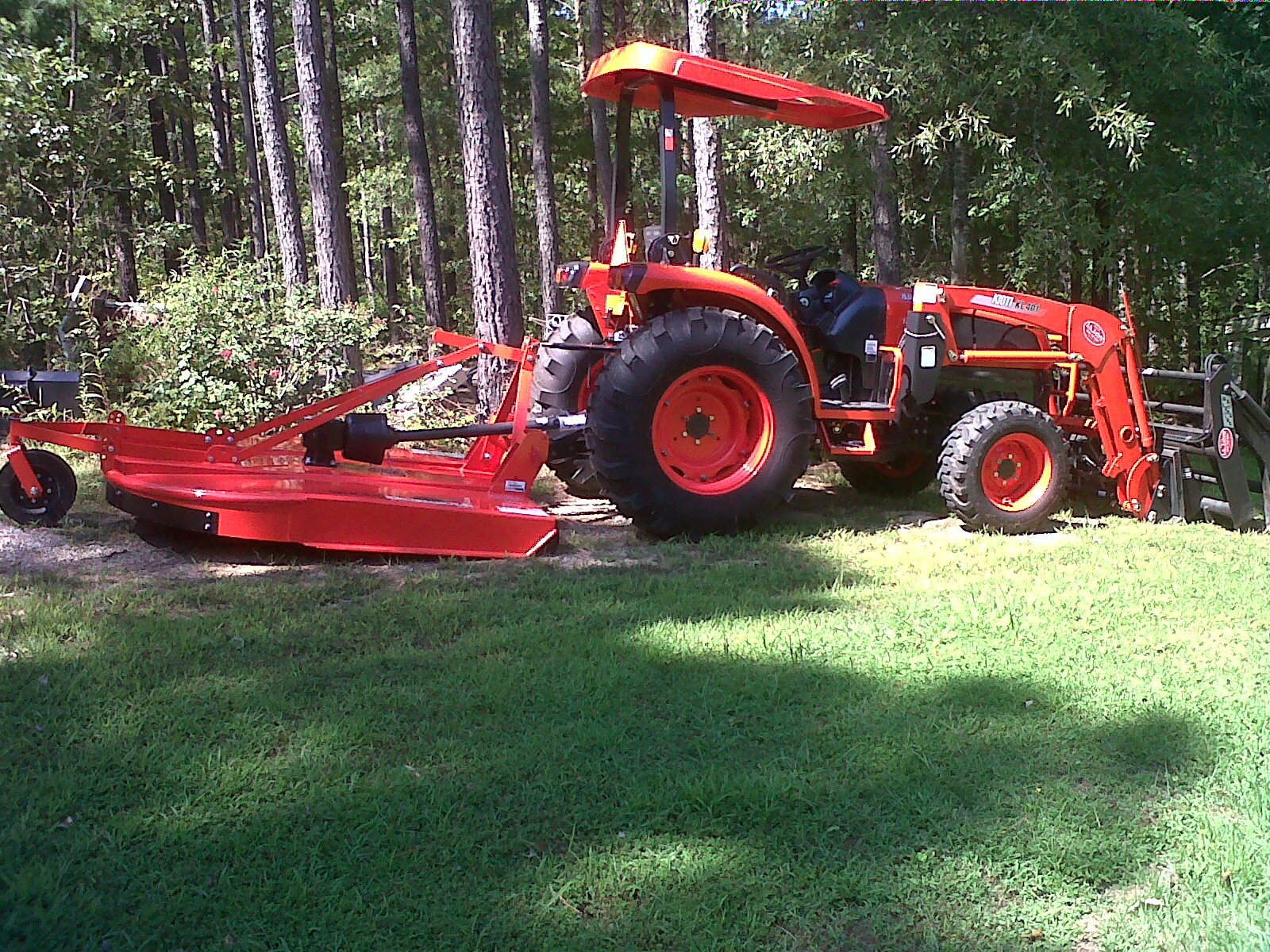

Here is a picture from when I got the tractor brand new...
David

It's too low in the front, the front should be about an inch lower than the back, looks like you need to loosen the top link and raise your 3PH to get the right angle. If you want to mow that low, you can adjust your tail wheel and lengthen the top link.
   / To top link or not to top link, that is my question... (Kinda...) #18
I think that I would disconnect the cutter and lift it with the FEL (chains)....get some boards of different thicknesses and put them on the ground and position the cutter on the boards for the correct angle/height. Now, adjust tail wheel for that height and back tractor up and see where 3 point hitch best attaches. Looks to me like you are using the highest attachment for the lower arms and a pin thru the top attachment holes. Looks to me like there are two sets of holes below your current attachment point...maybe the geometry would be better if you used the middle or lower hole. I don't have a woods so don't exactly know where the attachment points are. Also, remember that there are adjustment points on the tractor for the height of the lift arms. I would do all this, then as a final step adjust the top link to just fit the cutter in this desired cutting position.

Or IF you possessed a ruler and measured the amount of thread showing, plus made sure you recorded the settings of your 3pt equipment (what hole etc.) so you could duplicate the settings.

Pics of the actual 3 point may help.
I put the one I borrowed on a 4x4 in the rear and a 2x4 in the front.
And when I set my plow up I drove the tractor onto a 4x4 to get the right tilt.
