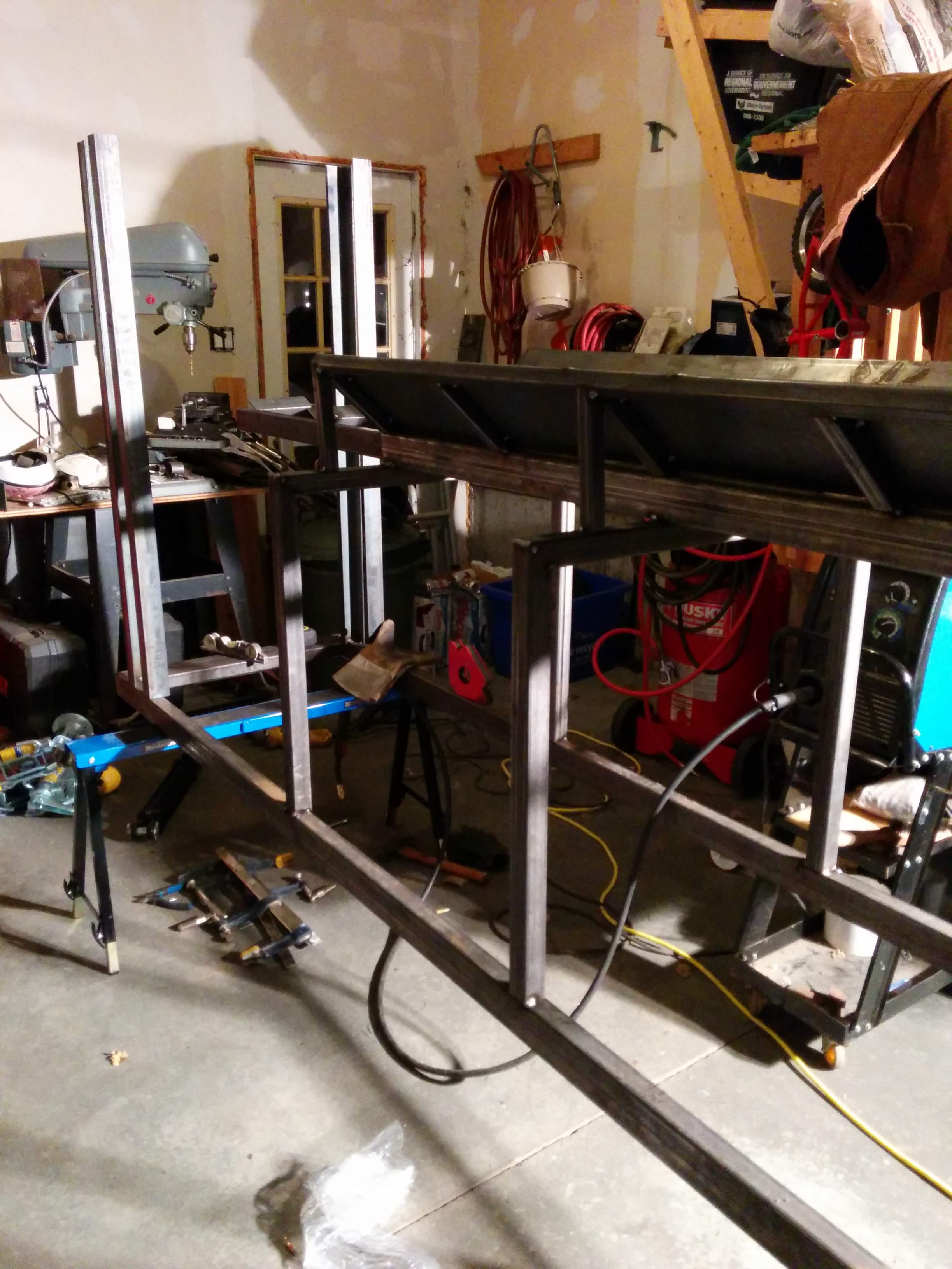

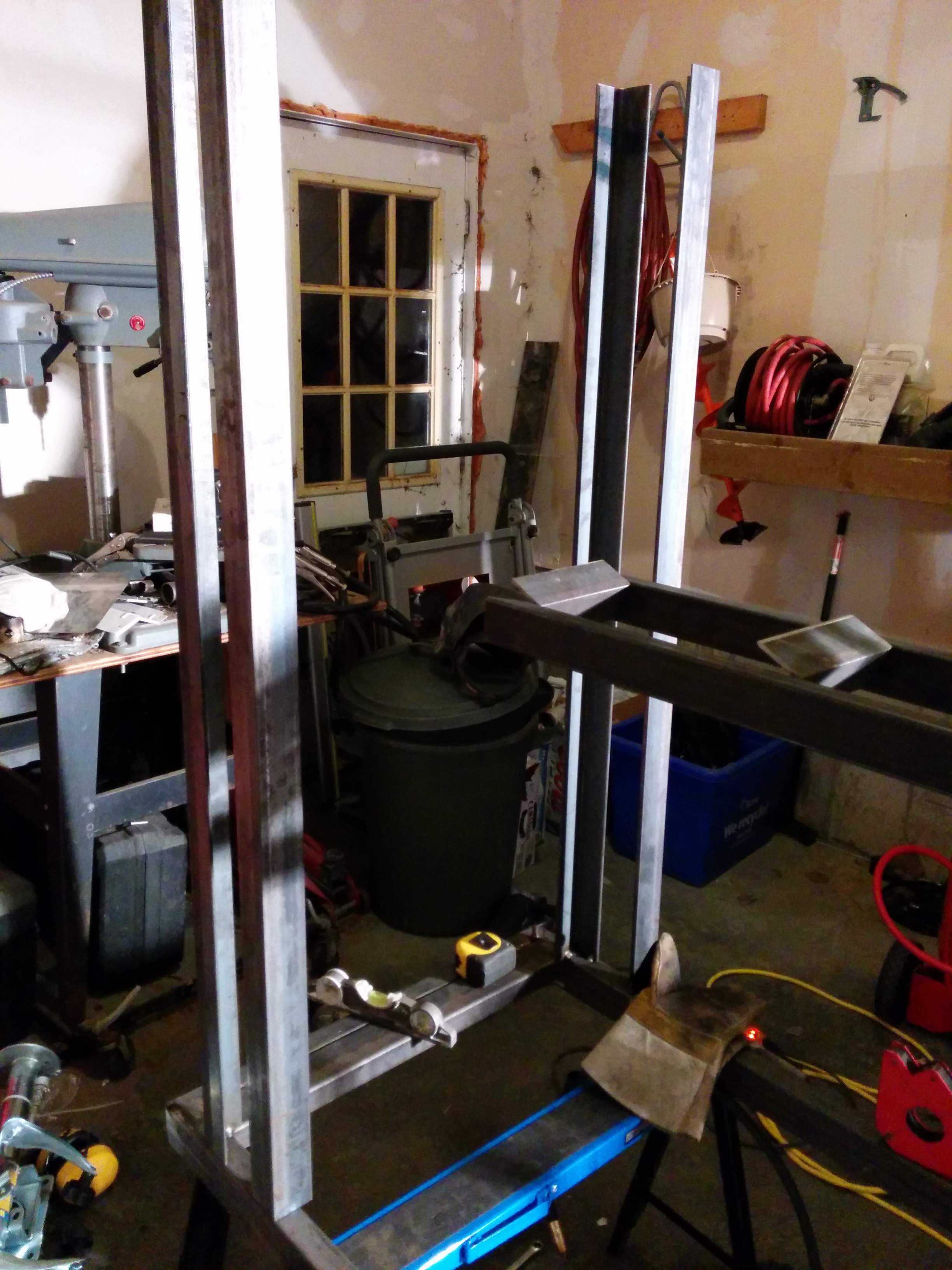

Well, I have a really bad pic of my paper drawing of the splitter head. I was designing and re-designing so a lot of the scribbles may not make any sense. The second picture is the vertical channel that will hold the cutter head. It will be suspended from the top by a hydraulic cylinder to lift and lower. You can check out my other thread on the actual build, there's more pics there. I posted the URL a couple posts back.
Top section is the 6 way. Bottom section is the 4 way and in between the two is the two way.
Incomplete vertical channel to hold the splitter head and allow it to move up and down.

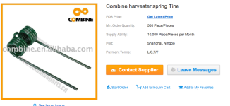

OK I got it. Not easy to change cutting edges. But it's a beefy unit all connected together. Might make it so you can turn the processor on its side (or at least easily remove the cutting head) for welding / sharpening maintenance. Or build one and if it doesn't last long enough then during that time you can search for harder material or another solution. Maybe just fillet-welding spring steel tines along the (now flat) cutting edge will give you a high grade cutting edge. If the knife is 1/2" material, maybe cut-offs from 1/4" spring tines would be just right. And easy to replace if ever necessary.
Heres a pic of a tine from Google images, you can cut them with an abrasive saw. They don't have to be straight, you can cut straight sections or even heat and bend straight, but should be fairly easy to find a source of hard steel to use.

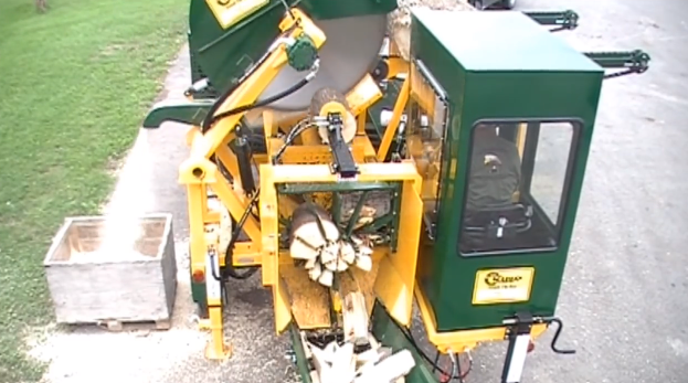

The wood falls into the trough (not yet build), so it is always at the same height. The cutting head moves up and down by a hydraulic cylinder to match the size of the wood or the cutting head I want to use. The cutting head is braced against the back of the processor as well as up both sides by the angle iron. The head itself will block those gaps, so I don't think that's going to be an issue. The cylinder only has a 12" stroke so the only way I've been able to design it (not that somebody couldn't figure it out differently) is to have the 6 way at the top, the 4 way at the bottom and the 2 way in the middle, between the two of them. Anytime one of the heads is used, it is always centered in the processor and to the round being split. Here's a much more impressive version of what I'm trying to build. https://www.youtube.com/watch?v=jbGtJYbXz7I
   / To Weld or not to weld, that is the question... #18
OK I see it, the 'knife' is stationary & self clearing. Looks like you'll have to get used to your firewood stacks being 11 1/2" max.
Awesome machine, thanks for posting the video.
Pretty easy to do knife maintenance. If you're splitting for yourself you will never have to do any maintenance (just a guess). If this thing starts to make money for you then you may have to maintain the knives.
Here's a pic from the video
