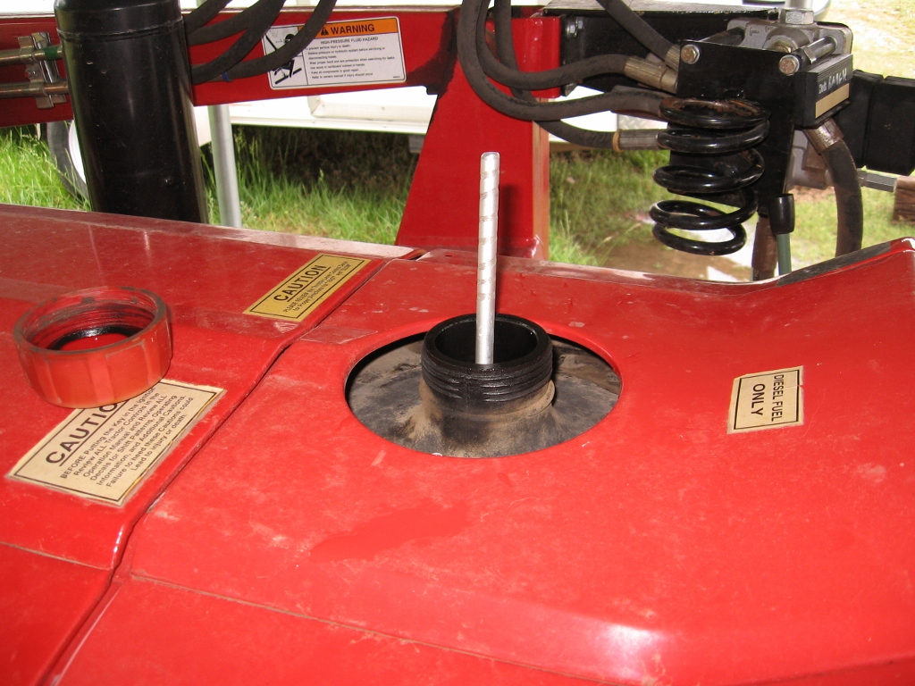

I am still stuck in the stone age I use a stick but hey it works
Me too on the YM240. I love that tractor for its simplicity - parts that wear out or break were simply omitted from that model. If I need to know its fuel level I just look at the side of its semi-transparent tank.
The stick is only for judging the last 1/8 tank precisely, when I need to run the tractor and don't have more fuel on hand.

... If I need to know its fuel level I just look at the side of its semi-transparent tank.
Yes, my YM1700 (sold when I bought my YM2210) had a semi-transparent tank, and I could tell how much fuel I had left just by looking at it. My YM2210 (from Fredrick's) had a new tank installed that is opaque black, so there's no seeing through the side. I can't even see the top of the fuel by looking in with the cap off; too dark! My only option is the measuring stick. It works...
   / Today's project - fuel gauge in cap. #20
I picked up a replacement spout for my new-ish fuel can at Rural King. It replaces the awful spout that has something that has to be pushed in for fuel to flow, and even so it is SLOW SLOW. It's especially a pain when I have to hold the can up to fill my Yanmar's tank. Thankfully Yanmars don't go through fuel very quickly... but even so, a gauge on the cap would be nice. (Yes, I finally tied it into the thread!) :dance1:
