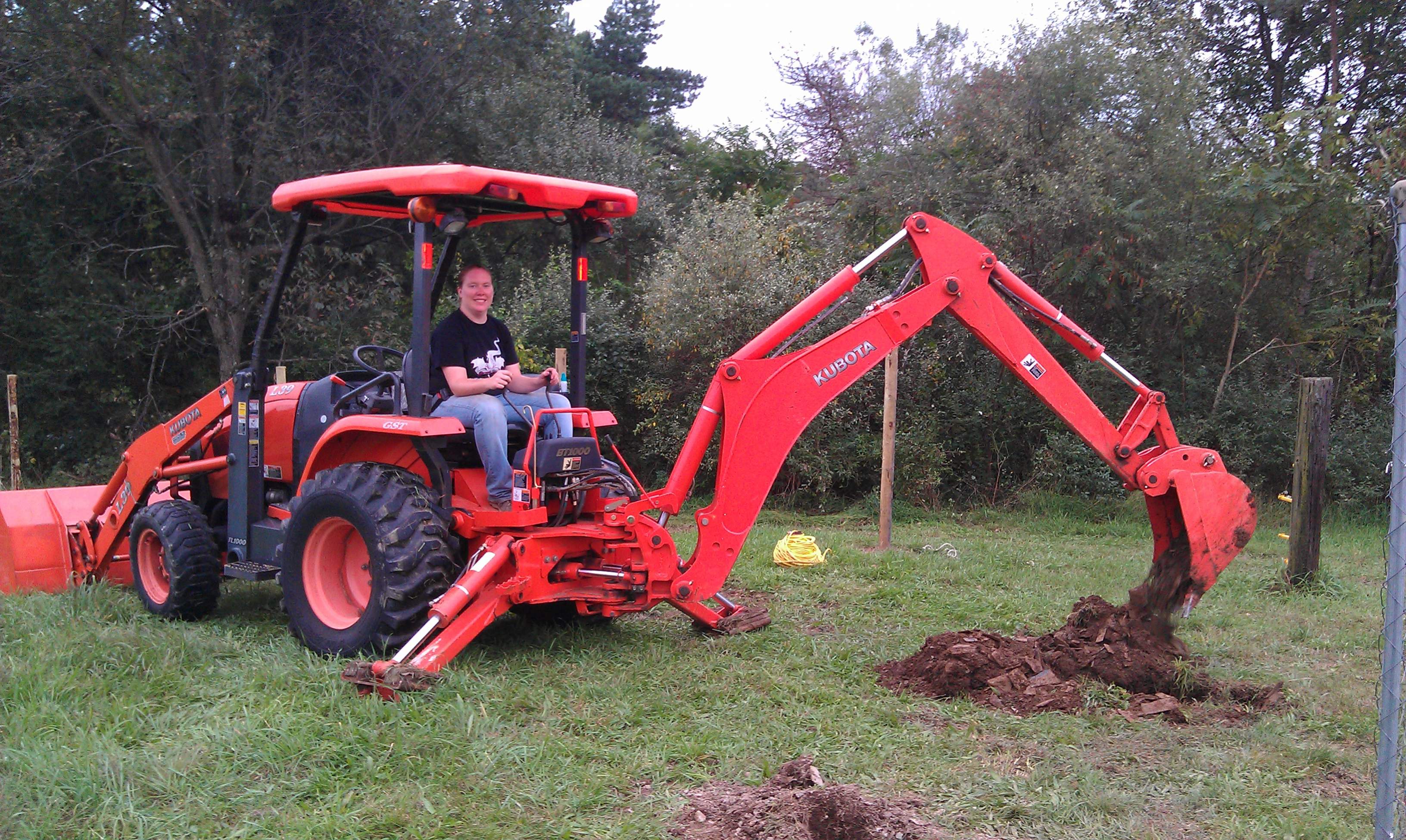

The wife got ~6 hours running the backhoe to set fence posts. I started the day out borrowing a Dingo with 6, 9 and 12 inch augers. None would dig into our shale shelf 12" under ground. So we threw the backhoe back on the L39 and put the wife to work. She is MUCH better with the backhoe than I am. She has much smoother controls and can make a deeper hole with less surface disturbance than I can. She dug in, back filled and compacted ~30 posts all with the hoe.
On a side note, I REALLY want to come up with an auger setup that will punch through shale. Any successful experiences?

Who needs an auger when you have a wife that can do that :thumbsup::thumbsup:
I'd buy her her own hoe !!

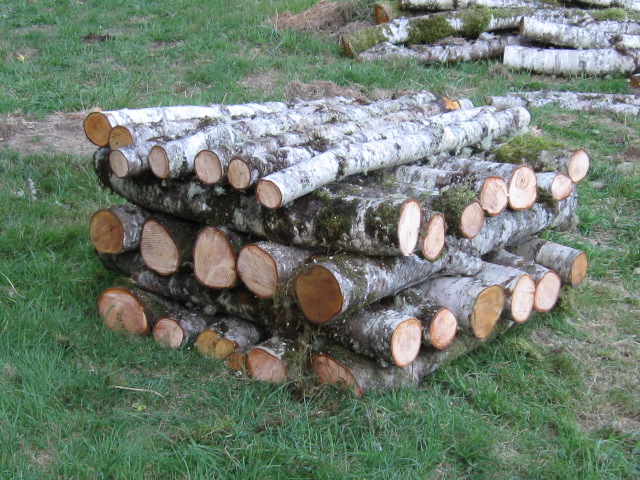

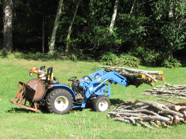

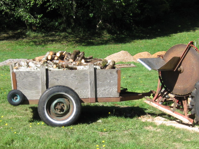

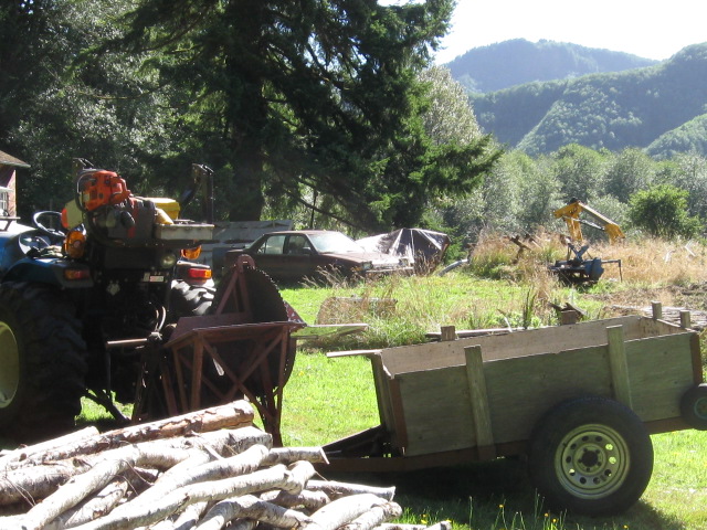

Yesterday I moved the big limbs that are going to be my next batch of mushroom logs and bucked the first of them to 48 inches. I also buzzed a trailer full of the smaller limbs that were bigger than I wanted to chip.
I think I finally know how to post the pics as linking thumbnails. Here goes:
