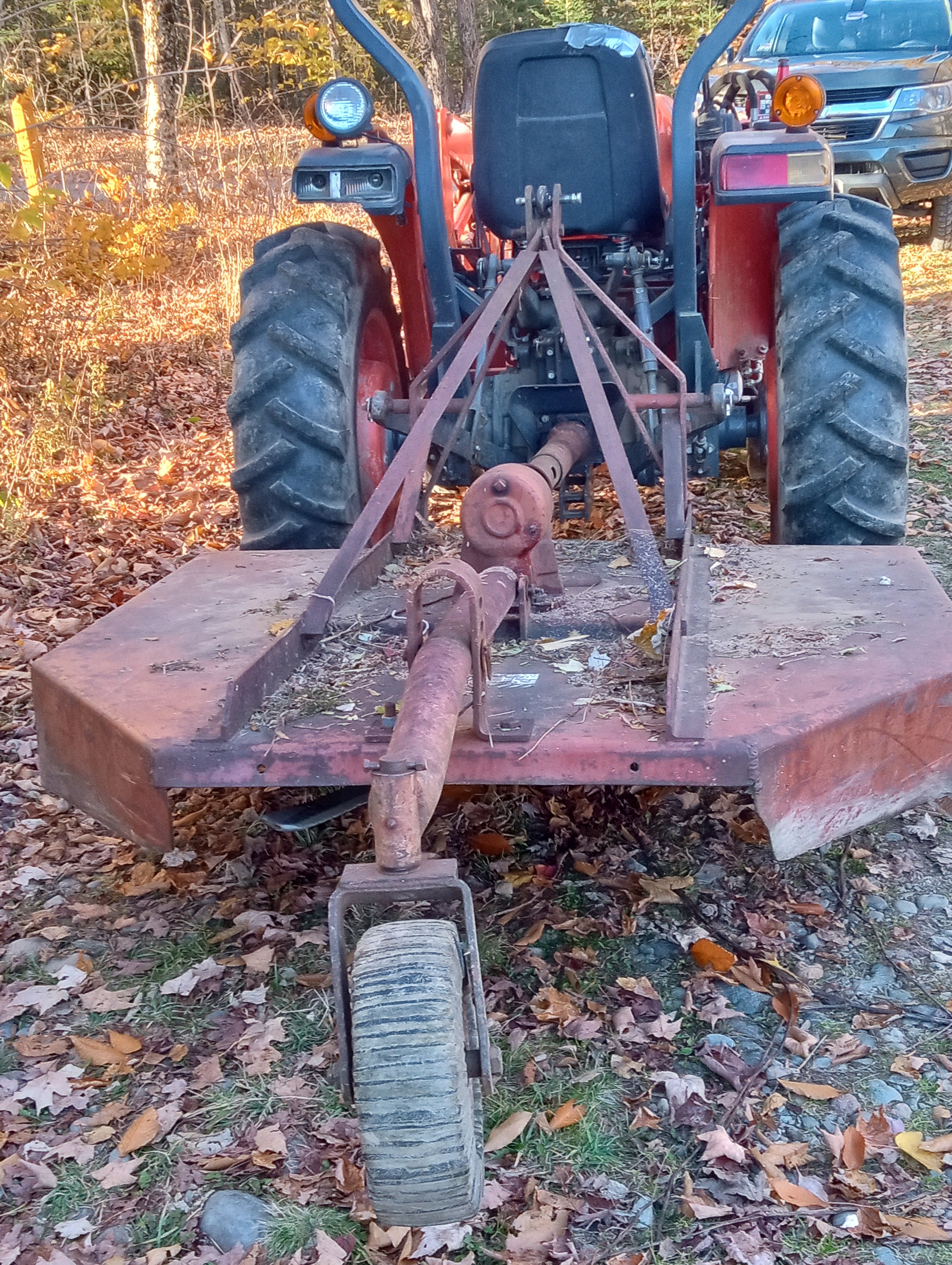

I left the house before daylight this AM, as I had some errands to do. After getting home around noon time I did a little mowing... IMG_20241020_160707658_HDR.jpg

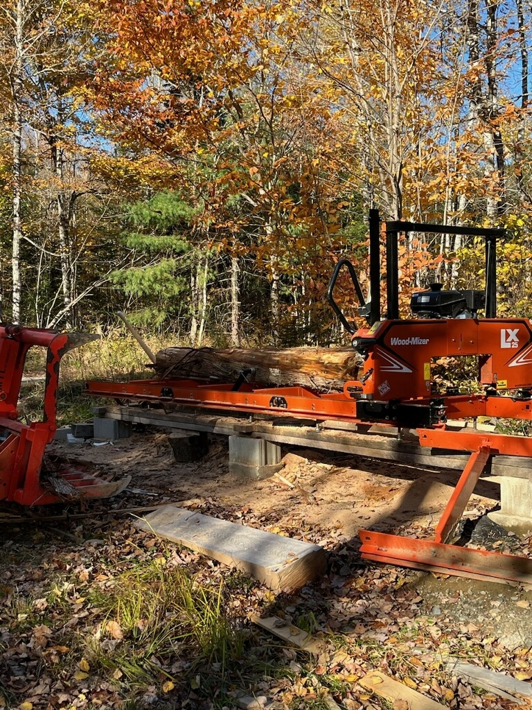

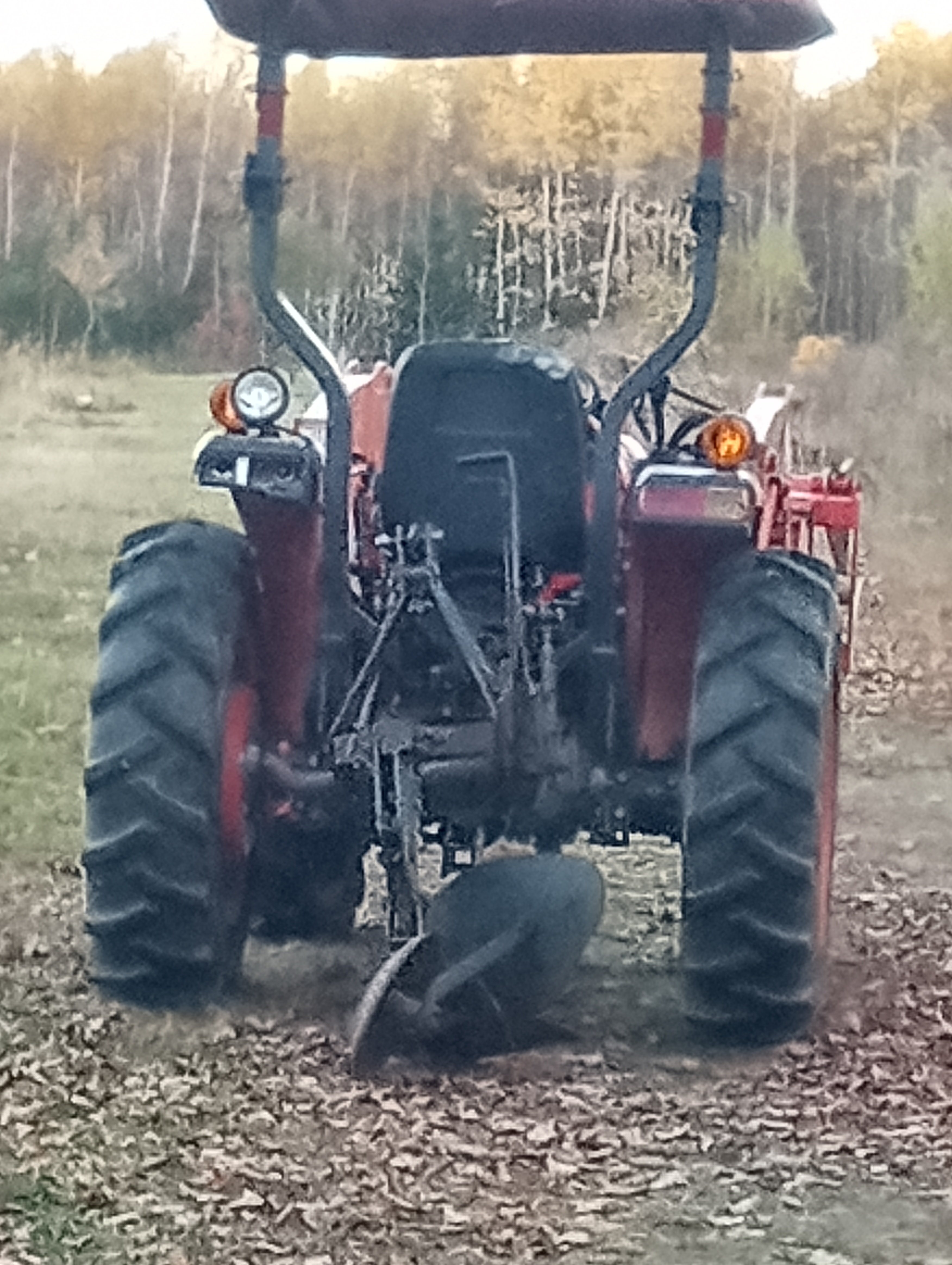

Now I have the plow on,
and am trying to find the energy to turn some sod before dark.
