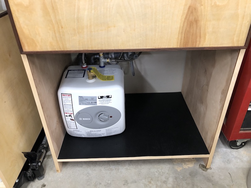

Sure... did a bunch of research and settled on this one. Bosch 4 gallon that runs on 110v. There is a 2.5gal version and a 7gal (220v) but I figured this will handle 5gal bucket of hot water and all the hand washing I can throw at it.

How long does it take to get hot water from when you turn it on?

Just went out to check.... One one thousand, two one thousand, three...

Wow! That's fast.

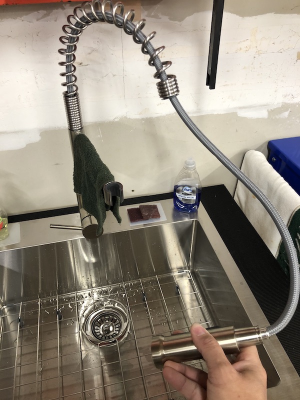

Since the water tank is hot and directly under the faucet it only has to travel a couple feet or so of flex braided supply line. Since my faucet is tall and the hose head is retractable it has a little longer to go than a typical sink hook up. You might cut a second off your time if you had a shorter run. :laughing:

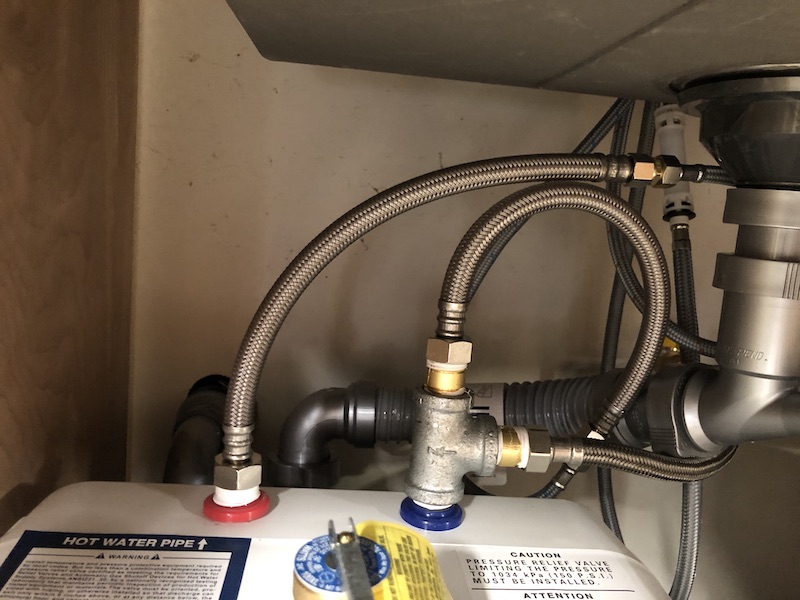

Notice the T on the cold side. This is where the cold supply line gets split for hot and cold water. Don't do what I almost did and hook up the supply to the pressure relieve valve thinking the red and blue are your hot and cold outlets to your faucet.
