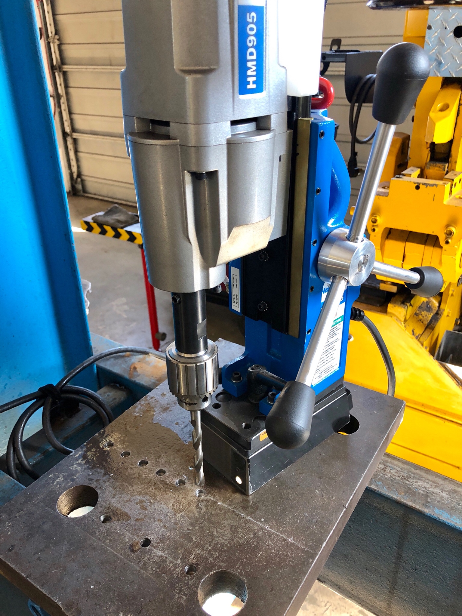

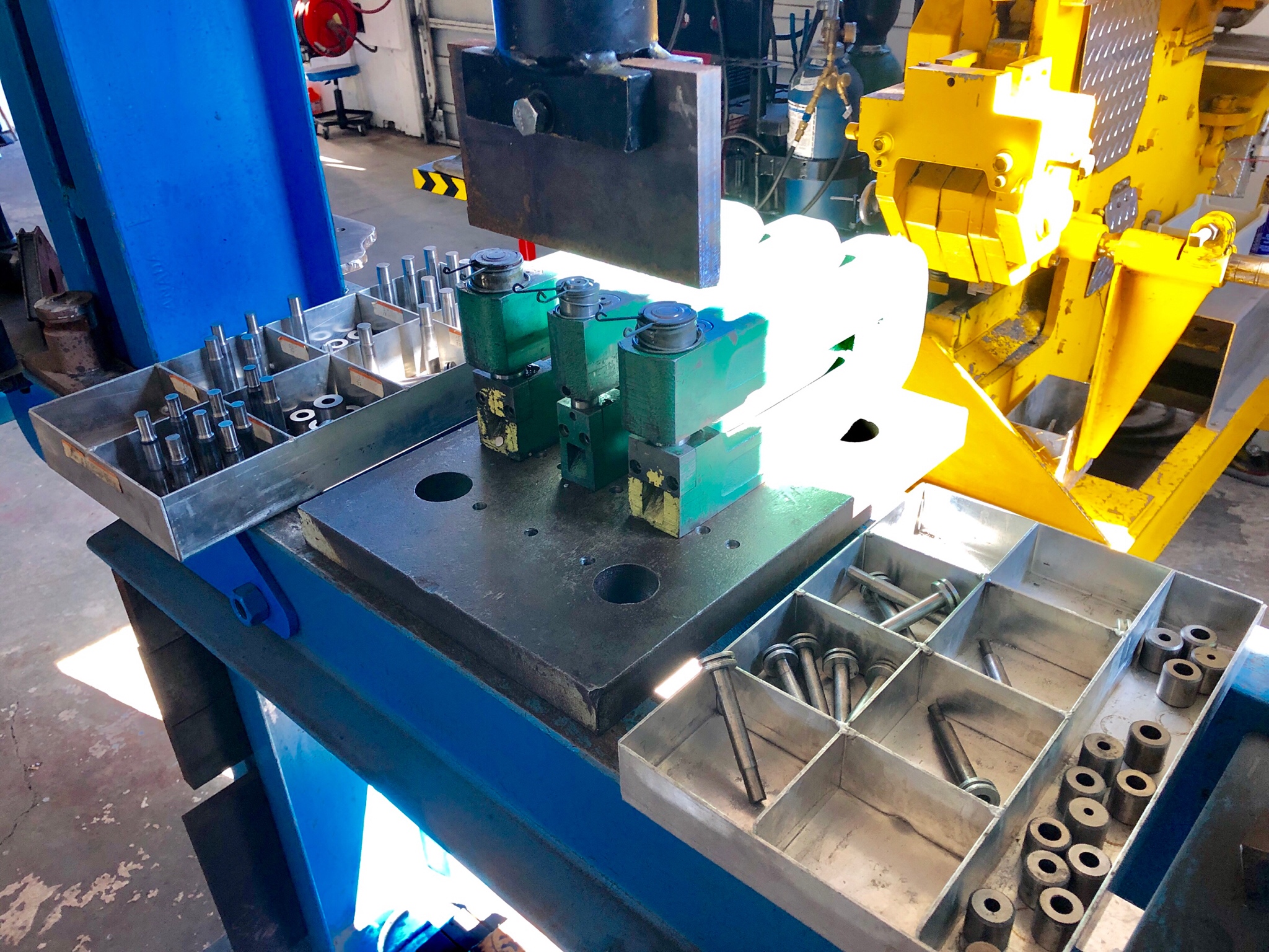

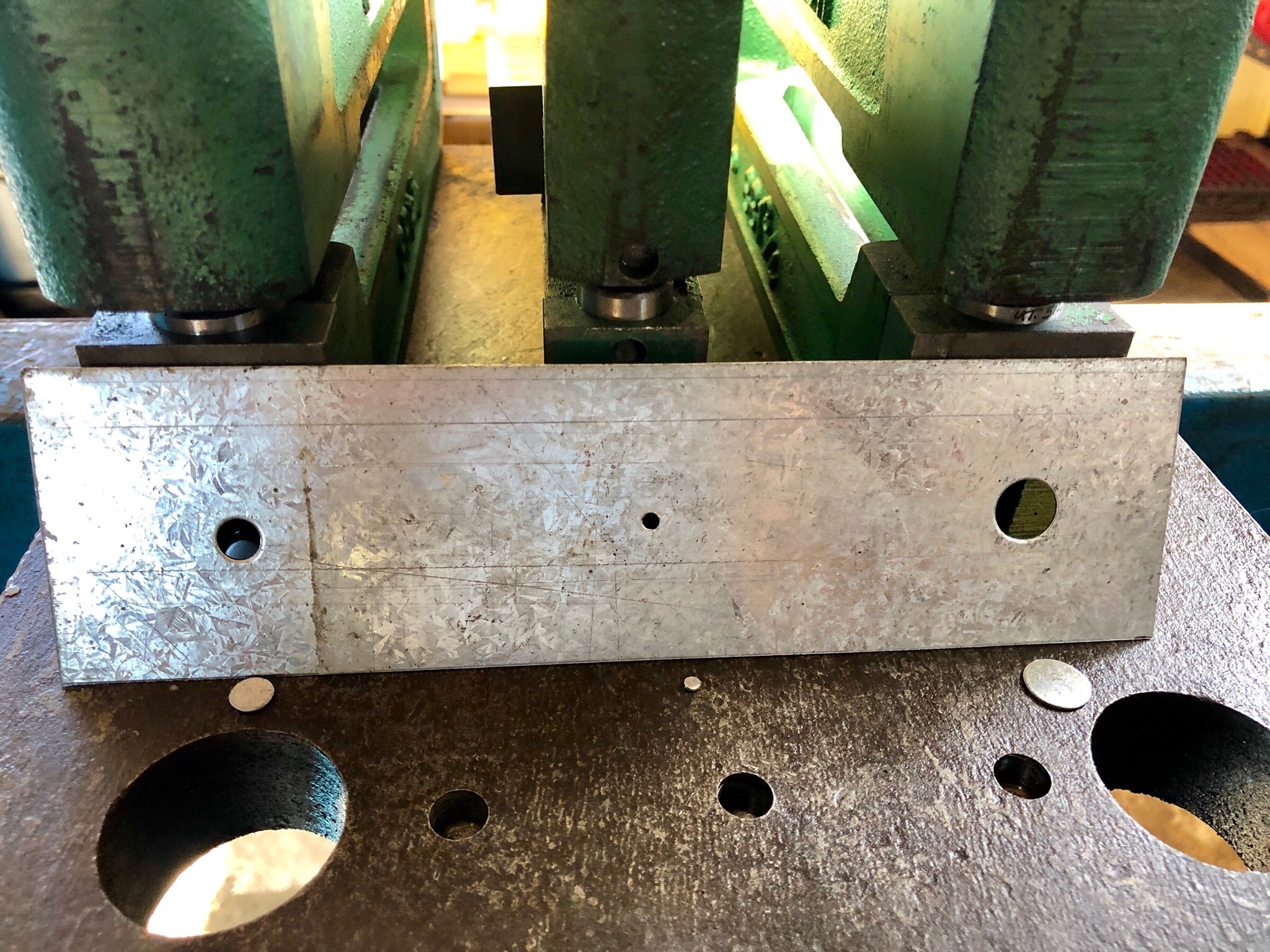

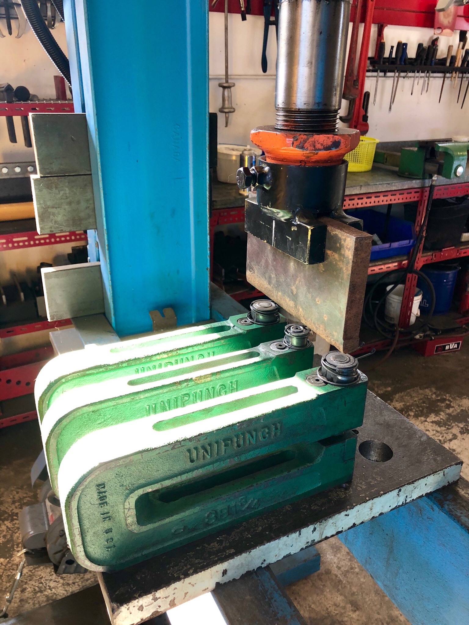

Unipunch C frames are always available on eBay but I couldn’t find any info on utilizing them without a proper press brake.
unipunch - Google Search
I came across some locally and decided to see if I could use them in my hydraulic press. The four frames I got were “B” series and capable of 1/2 inch holes in 10 gauge.
I drilled pilot holes in my bed plate for frame alignment.

Always wanted to happen across some Unipunches for square hole punching, etc. Need to do some research to understand what I can do as far as thickness/dia hole sizes with my 20T press.
   / Todays shop time. #627
Pls. keep us posted on what you learn. I suspect a few of us have 20-ton presses. :thumbsup:

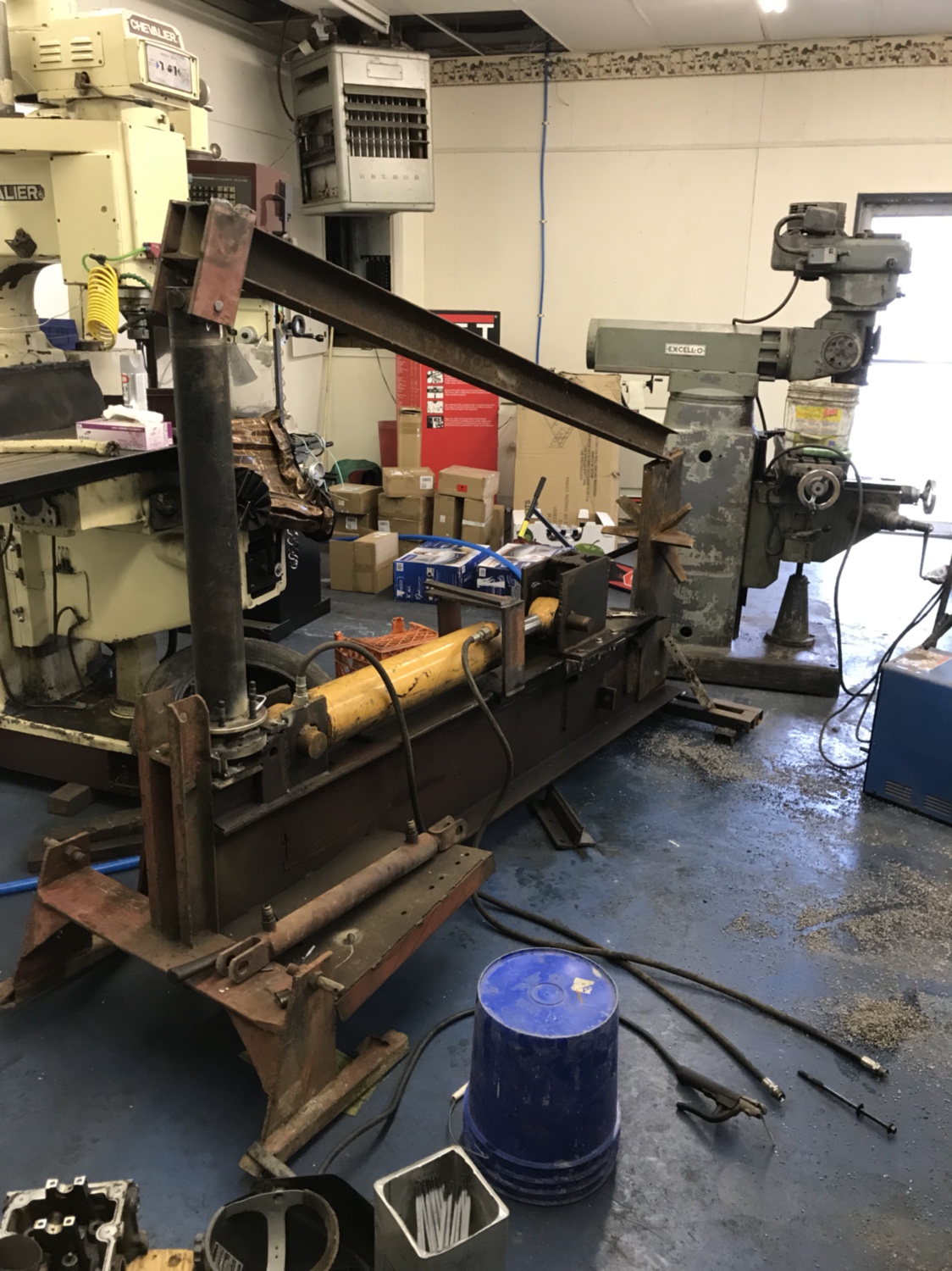

I built a crane for my wood splitter. I’ve never used that method before so we’ll see how it works.IMG_0048.JPG
